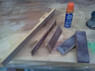

Giving that some thought. I will have to order the epoxy and microballons. Would a long sanding board be made or bought? 2x4 with a lot of sand paper? The door is a bit over 3" wide. I will wait to see what can be adapted with the upper piece of BUB, before I make a final decision on what I will do. I may just add a 2" piece of foam to the back wall and fiberglass the entire thing together and mount the door in it. We shall see.

A sanding board is easy to make out of a piece of scrap 1X4 and some spray adhesive. Here are a few of mine:
The sandpaper goes on with spray adhesive. The two on the right are 3"X21" sanding belts slid onto a scrap of 3/4" ply.

Bonnie we make our sanding bars out of straight 1X4 and a long belt sander belt cut open and glued flat to it (common rubber cement) One side coarse , the other side fine er ... The idea is to make it as long as you can so all surfaces are sanded perfectly flat ... But nothing says you have to sand it at all .... with the right paint job , you’d never see all that ... Something you don’t like , disguise it ... Like women’s makeup ... :roll: :o :lol: or you can do like I did , Camo it and then nobody will see it at all ... :FNP
Oops , I see W2 just posted the same method .... Great minds and all ... :lol:

Great minds and all that. Thanks for the explaination. I will pick up the parts soon.
