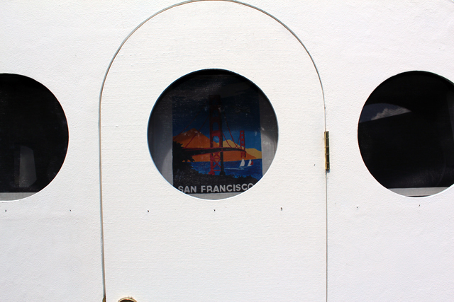

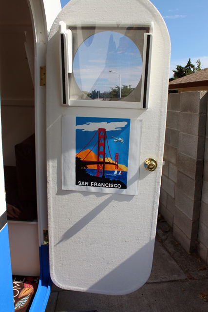

I love vintage travel posters and we needed a solution for window coverings in case we were in a campground. I also had lots of flexible magnetic strip left over from the window screens. So I combined ideas....
The poster acts as art while you don't need it as a window covering...
..and it acts as a window covering when you need one. Note the magnetic strips on each side of the window in the top picture. So far it works. I want to take it for a drive and see if they stay in place.
The poster is just poster board that I painted on with acrylic paint. I probably should spray some sort of clear coating on it to increase durability. It was great fun to make. I'm actually looking forward to making 6 more. I like that they curve to conform to the wall and they add some color to the all white interior.

I think that the poster idea is really good. If you allow me, I will steal it for my trailer too. If I make them translucent, it will look pretty good in both modes :thumbsup: thanks for sharing! Sorry cannot help on porta-potty cleaning front, I am still to start using that brand new I have in the box :oops: .

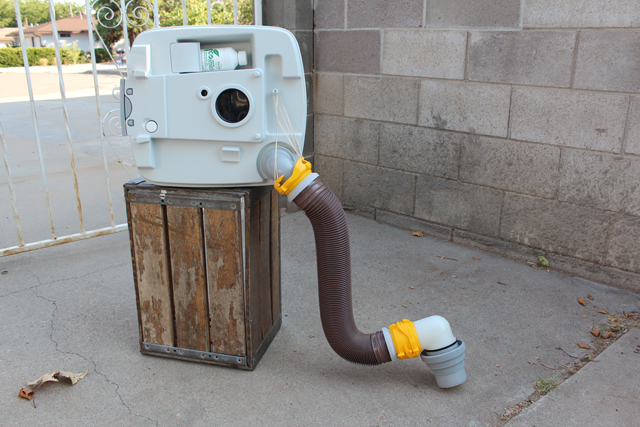

NMMarauder wrote:Here is a picture of my porta-potty dump station. Dumping in the toilette isn't too bad but the potential for making a HUGE mess was enough that I wanted to find a better solution. I just shortened a regular RV sewer hose and the outlet from the porta-potty is slipped inside the sewer hose. In this pic it is being held in place by a couple of rubber bands.
In theory, it is supposed to work like this;
1. Take the black water tank out and set it on the box near the dump station.
2. Take the cap off the outlet to the porta-potty and slip the end inside the sewer hose and secure it (rubber bands at the moment)
3. Make sure the other end of the sewer hose is secure in the dump stations fitting.
4. Rotate the black water tank and outlet spout so that the waste pours down into the dump station (Position shown in picture below). Mine has a button to press to admit air so that the waste pours out easier.
5. Open the flush valve and use the hose to wash out the inside of the tank.
This should keep the mess to an absolute minimum while allowing me to get the tank clean. I haven't actually tried this yet so if anyone sees a problem with this set up, please speak up.
The thing about the hose is that you will not be able to get all the stink out of it without GREAT effort while on an outing. As I see it, you don't really have a place to store it outside of your camper. Having it inside will not be acceptable to the Mrs, unless it's in a very well sealed box or bag. I'd just dump in public restrooms, or go with the lowtec bucket with kitty litter solution.

Good point about the sewer hose. I'm sure that is why most RV sewer hoses are kept in the bumper or a tube that is outside of the RV. I haven't actually figured out where I want to put the tube but that was my plan too. I'm not familiar with dumping in dump stations as I have never owned an RV. But all of the stations I have seen around here have a fresh water hose for clean out. I guess I could just run a hose into the bathroom, but then I would still have to hold the tank and make sure it was pouring into the toilette while trying to rinse with a hose.
My thought was that with all the RVs on the road, if there was a better way to dump waste, they would be doing that. I was just trying to emulate their procedure but since a porta-potty is not the same as a fixed blackwater tank there is some modification.
