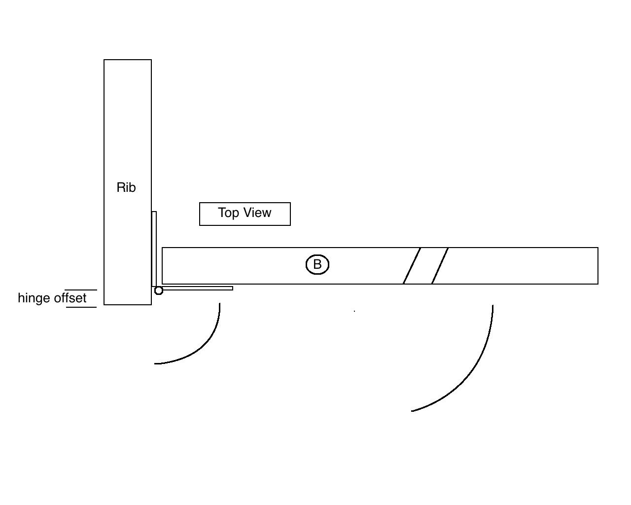

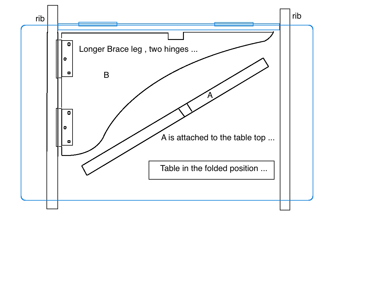

Postby GPW » Tue Oct 15, 2013 8:32 am
Here’s the folded view , showing the two hinge elongated brace ... and how everything fits (or should fit) flat against the wall ... :thinking: Thinking the exact location of the locking notches would best determined during the final fitting , aligning everything to create an "X “ shaped brace under the whole table top ...

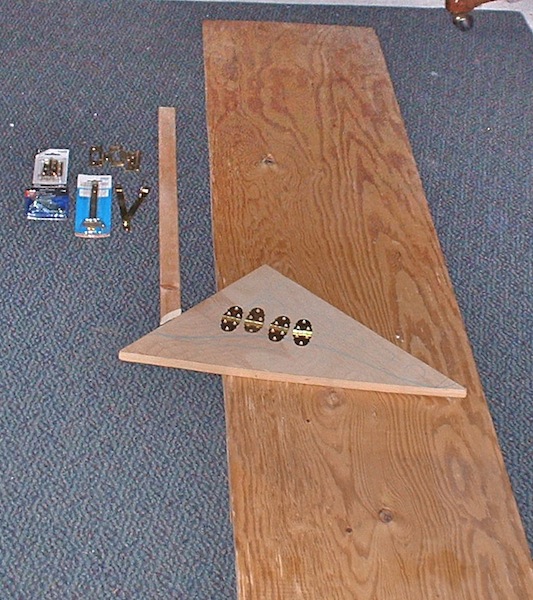

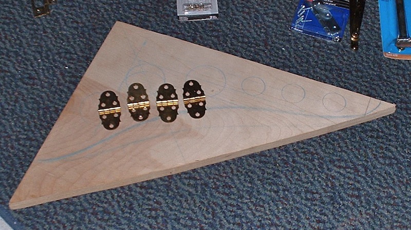

Postby GPW » Tue Oct 15, 2013 10:39 am
Digging around in the Studio for the parts .... found the brace(s) material ... and a bunch of hinges ... :D
Thinking now we might use 3/8” plywood for the table top ... the 1/4” does in reality seem a bit Thin :roll: ... Will have to go dig for some of that now ...

Postby GPW » Wed Oct 16, 2013 6:15 am

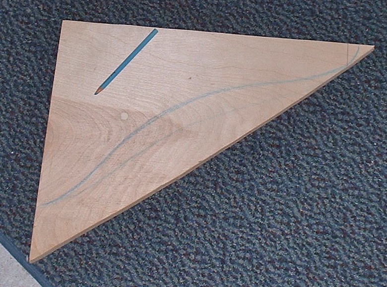

OK, we have it all figured out now ... Was just a matter of playing with two boards and a hinge ...then it all became clear ... :thinking: The hinge for part B (the hinged Brace) must be offset back from the rib surface to allow the brace to fold completely inside the rib space, allowing for the hinge thickness at the end ... that and not all hinges are alike ... :o
Saving a little weight , we sketched out the profile of the brace (tried to be artistic) ... Could even put lightening holes in it , but it may not make that much of a difference ... :thinking:

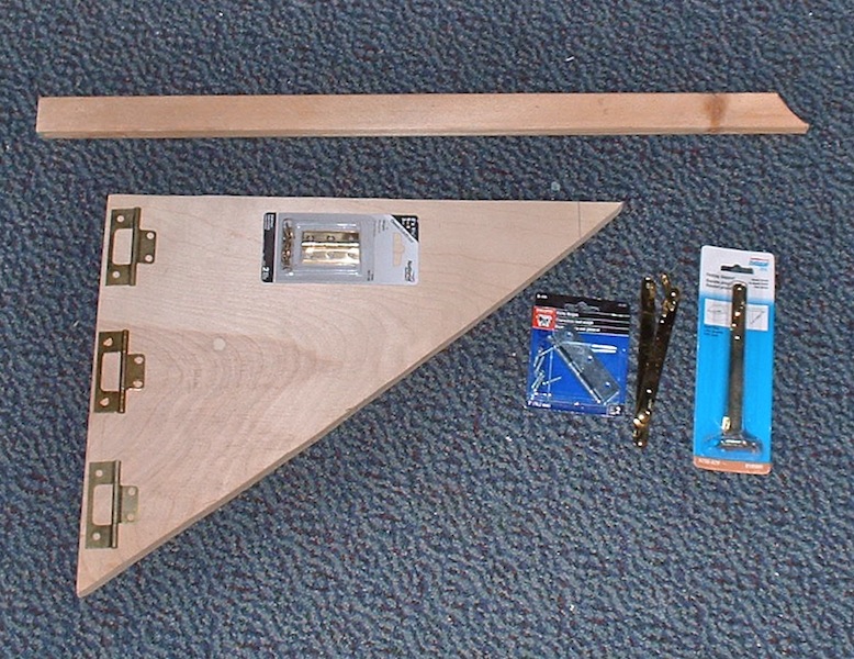

Re: FoamStream...
Postby GPW » Fri Oct 18, 2013 5:52 am
Still doing House (shed) work ... no 3/8” yet , but I did find some pretty hinges for the FS table , and a nice collection of assorted antique metal hardware... drawer pulls , handles , etc.... Old stuff I never knew I had :o ... Have to find a use for that .... :thinking:

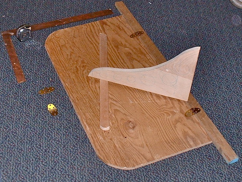

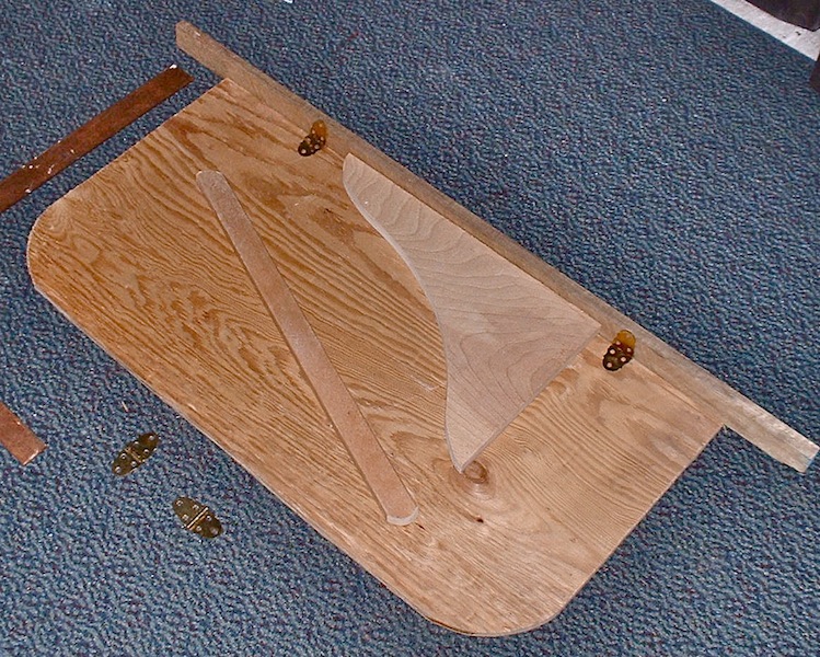

Re: FoamStream...

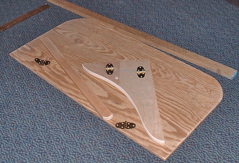

Postby GPW » Sat Oct 19, 2013 9:53 am
Got the table parts cut , and here’s how they roughly go together ( sorta’ ...upside down) ... Have to cut the rib brace ,where the table is screwed to, with an accurate measurement off the ribs at that point ... Yet to do that cause’ it’s still raining ... :rainy: The notches in the supports will be drawn during the test fit to get an accurate cut and fit ... :thinking:
And folded...
