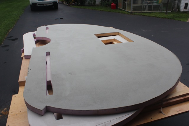

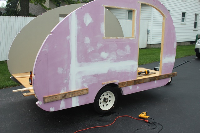

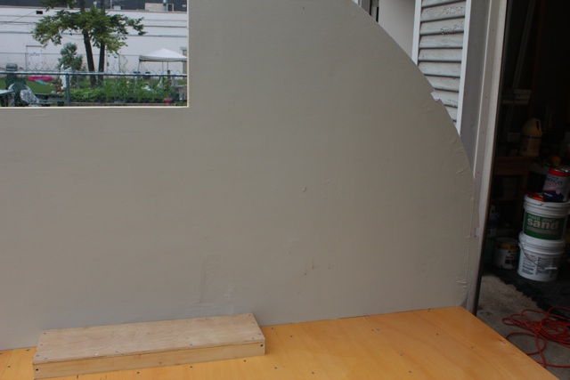

Here are a few pictures for Mark, and the rest of you who want to see how canvas looks.
Just one coat of paint so far...
The edges are peeling away. I'll have to put another coat of paint on the edges...
Here you can see where we tried to iron the canvas on the foam... (right above the wheelwell). You can also see where the canvas bubbled.

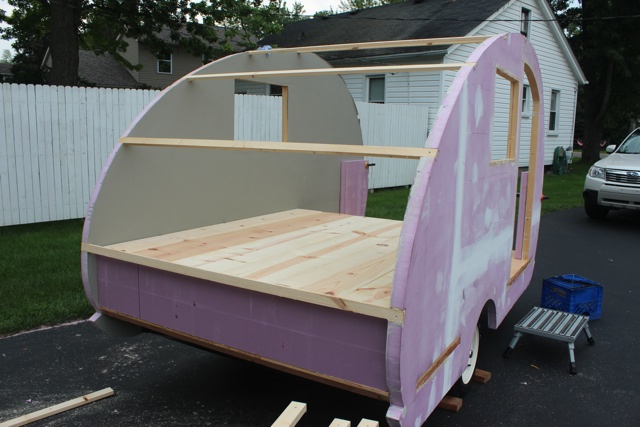

Postby mikeschn » Sun Aug 07, 2011 5:33 am
We glued the walls up last night. We got the top spar in also.
I'll get the rest of the spars in this morning.
Postby GPW » Sun Aug 07, 2011 6:00 am
Mike , Sure is looking Good !!!
You may find the difference between the paint and the T2 is , the T2 will become thermoplastic with heat , (iron) where the paint does not ... The iron trick won't work with paint ... :roll:

Postby millstone » Sun Aug 07, 2011 7:33 am
Thank you for the pictures, Mike.
The finish looks good in the photos. Are you pleased?
I can't help thinking that with enough coats of paint, you should get that "bumpy" texture that you see in a lot of vinyl products. My guess is that with one coat of paint, you're kind of "rough to the touch" at this point.
Is that a reasonable expectation?

Postby eaglesdare » Sun Aug 07, 2011 8:54 am
wow, that is looking good!
now about that sock effect...how are you going to do that? or are you? are you going for another layer of canvas to overlap?

Postby mikeschn » Sun Aug 07, 2011 9:17 am
eaglesdare wrote:wow, that is looking good!
Yes, I plan on overlapping all the exterior canvas to create the sock!

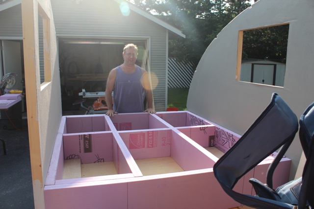

Postby mikeschn » Sun Aug 07, 2011 1:53 pm
Gluing in the bed platform!
The lower part of the foam got pushed in too far
Here's what the bed platform is going to look like...
working on the design of the front counter...

Gotta question and suggestion. Are you going to hinge the bed to use that storage space underneath? And why not use what you have therefor the counter just pocket screw the one by on the bottom and a few coats of spar varnish or poly to finish it?

Postby GPW » Sun Aug 07, 2011 5:16 pm
Mike ,you could make the counter out of foam . with very thin ply or even canvas on both sides ... Perhaps a foam center brace if you plan on something Heavy on it ..
What were you planning on putting on it ???
