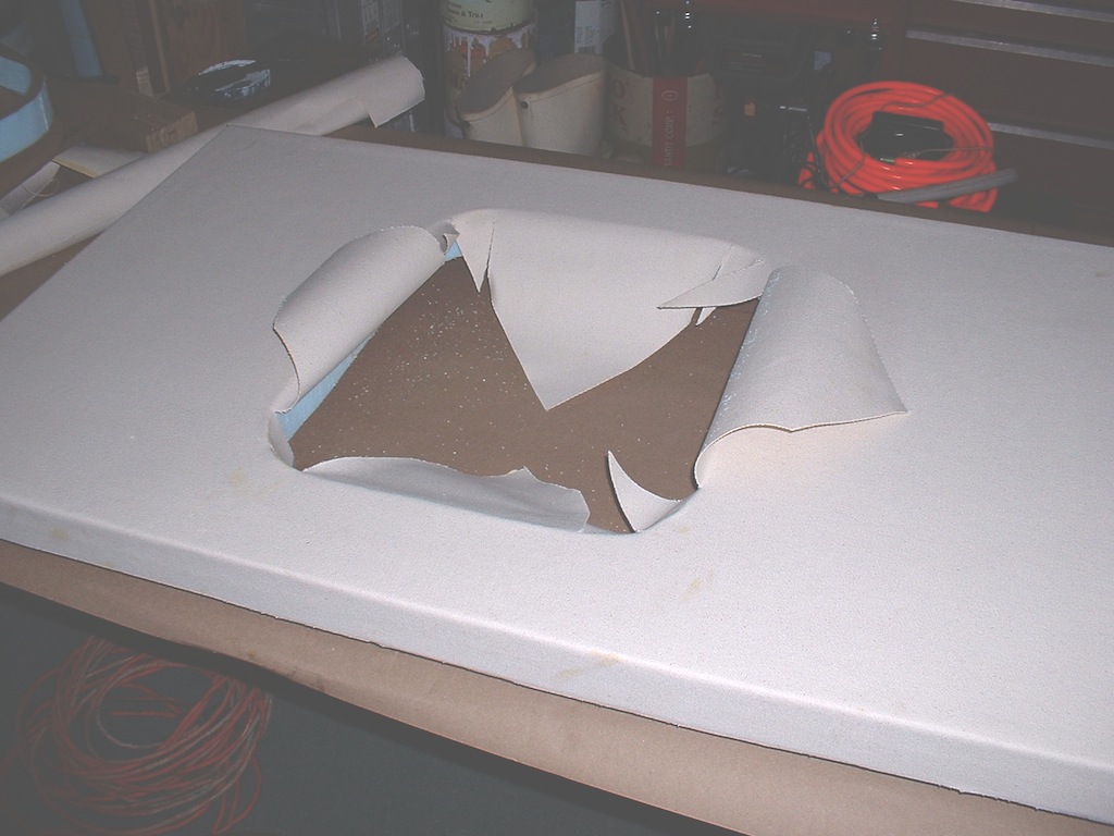

Doing the interior canvas first is the Simple way to do it .... trying to install,canvas inside can be a PIA especially overhead ... The thing is , canvas sticks to foam as well as foam sticks to foam , so Yes, that’s a good idea applying the interior canvas while small easy to work on pieces ... :thumbsup:
We just folded/glued the canvas V’s in the window openings and sealed the window in with the 3M Marine sealer ... still perfectly sealed after two years living outside in the weather ...

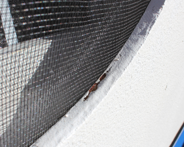

2. The window openings are great. No sign of trouble at the edge where the canvas meets. The only spot (out of all 7 windows) that I need to fix is a spot where the paint didn't stick. (shown in photo below) Not sure what happened but I'll sand it down and repaint. My guess is that there is some of the rock hard putty there that didn't have enough tooth for the paint to stick to.

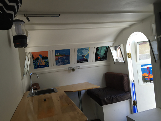

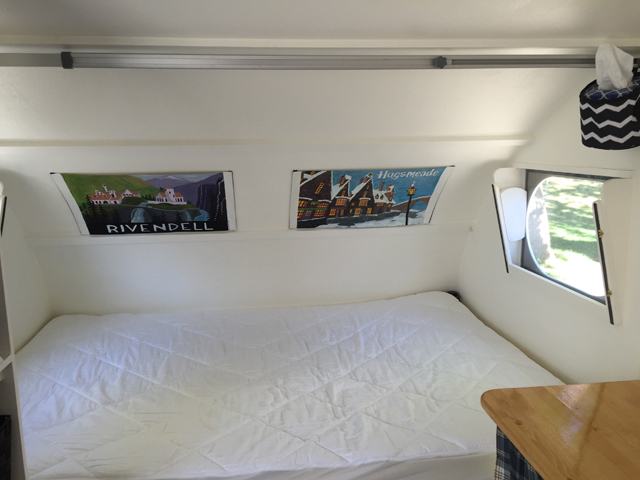

I finally had a chance to create the rest of the window coverings. I painted some posters in the style of vintage travel posters and then glued flexible magnetic strips to them. That way they can hang on the wall as art when not in use and they can cover the windows when you need privacy.
You can see the magnetic knife block above the galley counter (knives stored when traveling) and a small basket with light that I installed above the dinette.
The rear ones are larger

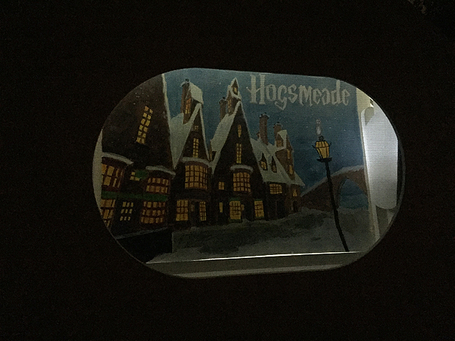

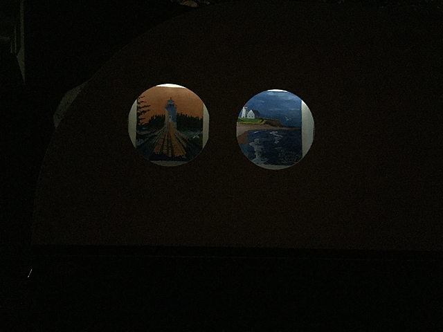

At night, with the light on inside, you can still see them from outside. The effect is pretty cool.

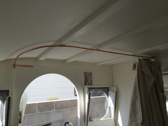

Finally, I got around to making a curtain rod for privacy using the toilet. The curtain shown here is just a piece of canvas that I had left over. It will be replaced with something more attractive.

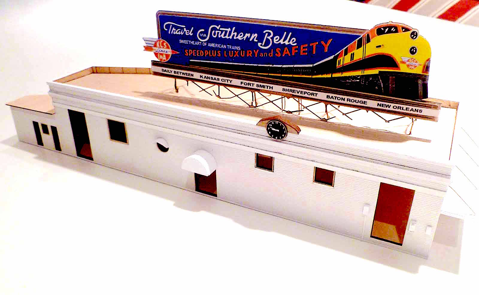

Ps. Love those Posters !!! :thumbsup: 8) :beer: I’m just getting ready to start a similar style Large painting of an old RR Cafe (now abandoned) in a town I grew up in ... it will feature an old school poster (see pic) ... We’ve researched this for months and months now , and finally all the pieces came together ... Especially Thanks to an exceptional RR modeler who has an F7 in his basement ... a real one ... :o

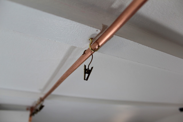

GPW wrote:So Cool NMM !!! But how does that curtain rod work ? I need something like that for the FS...
Here is a picture of the hooks that support the rod in the middle and the hooks that hold the curtain. One hook is screwed into the beams in the roof and the tip of the hook fits in a small hole drilled in the copper tubing. The other hook (that holds the curtain) can slide past it and still hold the curtain with the clamp end. The hooks that hold the curtain were taken from curtain rings. I hope it clarifies how it works.
