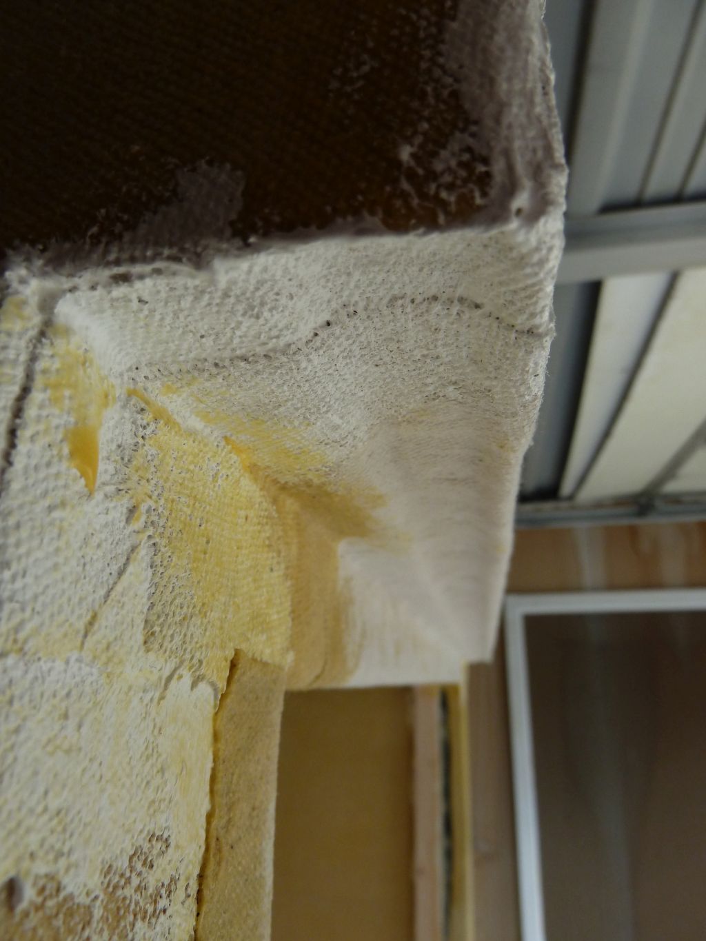

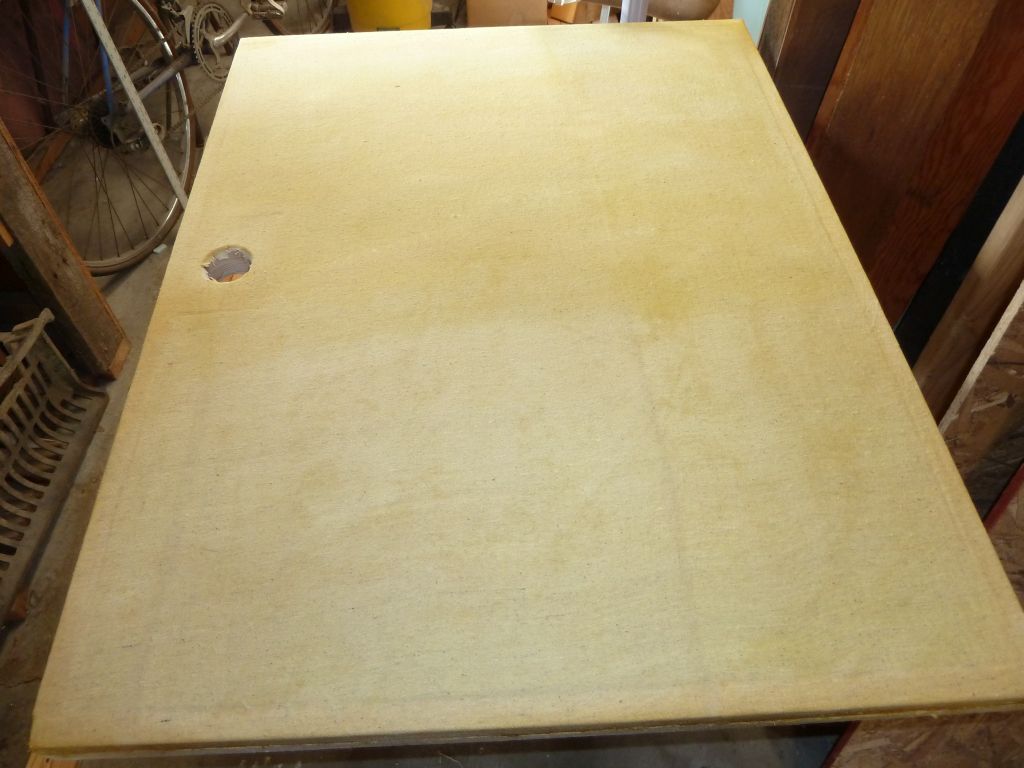

Did some more finicky canvassing this afternoon. Did the rear overhang and galley miscellaneous required canvassing with mixed results but it will all buff out or simply look like crap ! Need to trim canvas on left post. Gave the completed door outside a coat of TB II for ding resistance (no bubbles !!) & will do the same on the inside face later today.

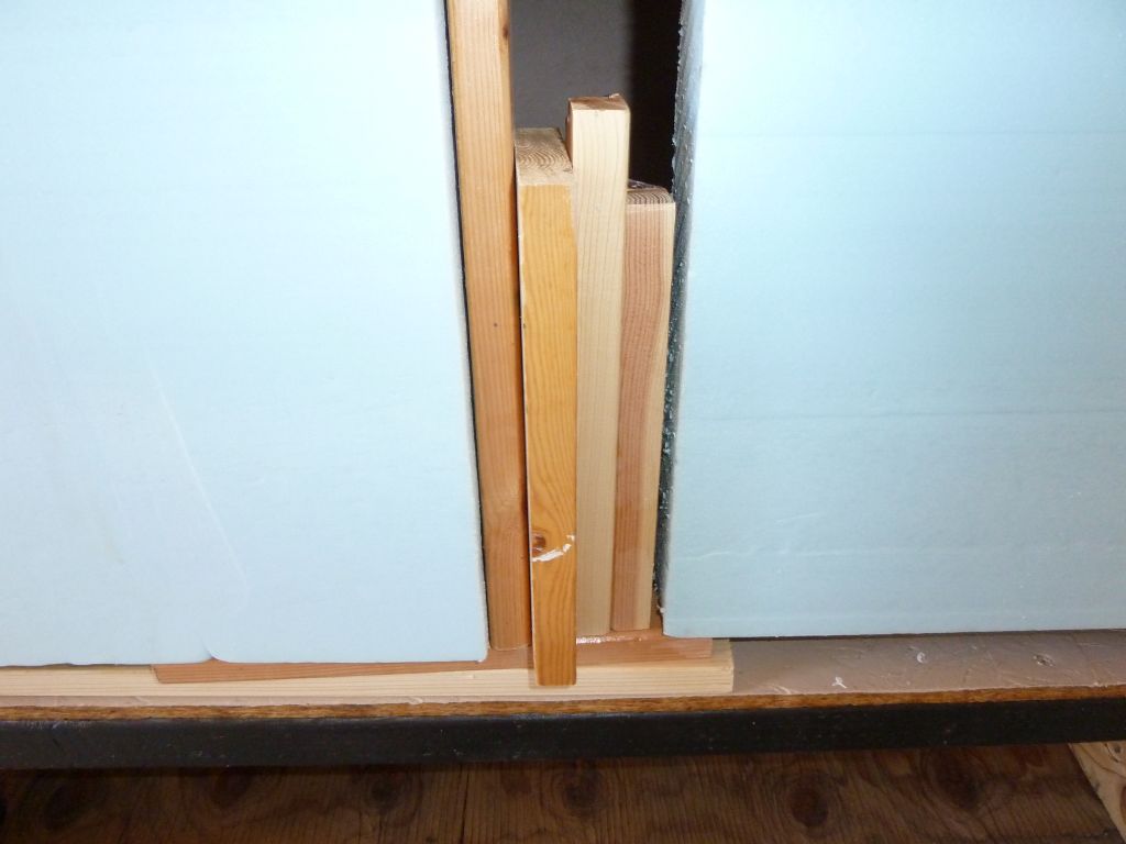

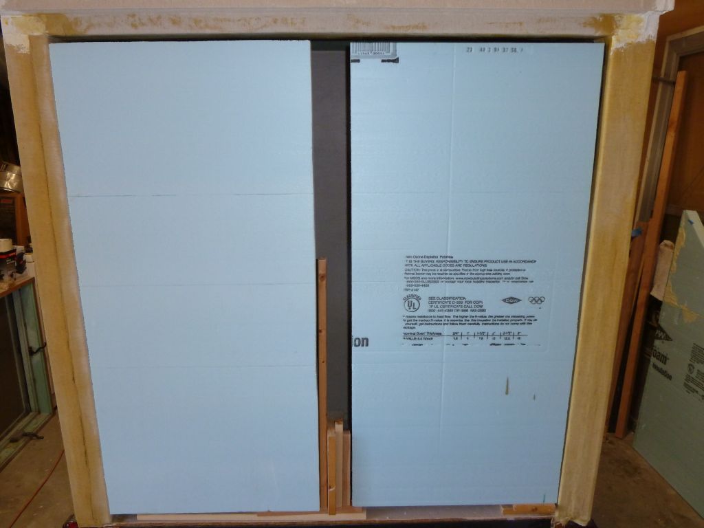

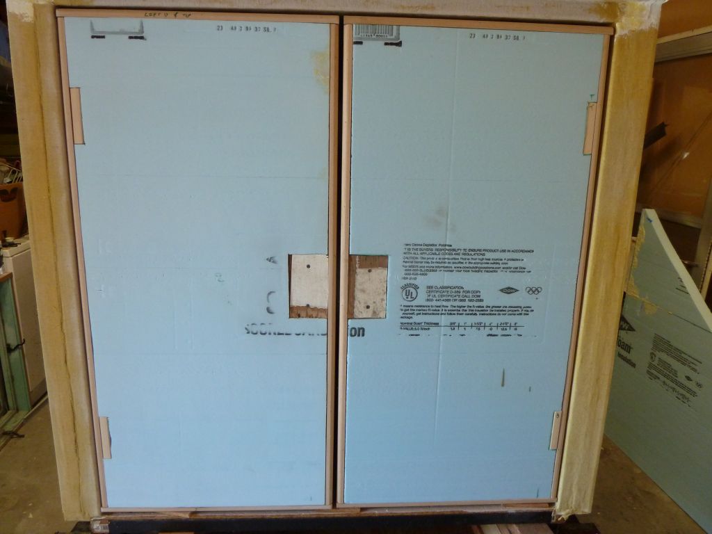

Slow progress today. Cut the foam to size. Left extra gap at "bottom" for threshold.
Tried to find 1x2 inch actual size (not .75"x1.5") lumber and struck out calling around. Don't have a table saw so trying to cut 1x lumber down is not going to work well. messed around trying to cut plywood to size w/ a circular saw & jigsaw and gave that up. Went to various stores looking for something to use and came across "shoe molding" which is like an elongated quarter-round that would work well enough and bought the required lengths.
Finally, a half-assed solution. :R :R
Cut the 1x2s & shoe molding down to size and glued & brad-nailed the pieces. Need to rout the foam & the cut the insert wood supports for hinges, lock, & drop down shelves and then tomorrow I can do most (all?) of the glue-up hopefully.

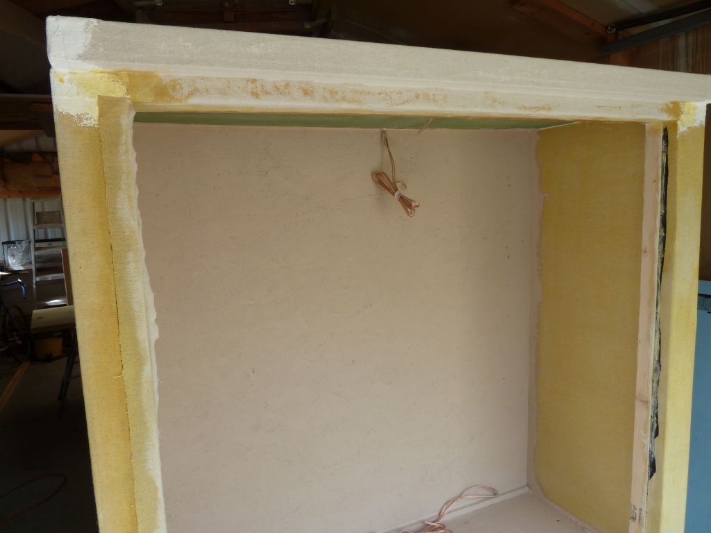

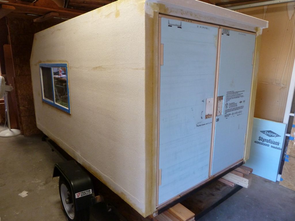

Still working on galley doors but seems likely I will finish up the prep and canvas them tomorrow. Lots of inset wood in front and back times two. Just finishing up the supports for the drop down shelves on the back side of the door right now and then the glue up / fill all the mistakes Great Stuff step.
Also got my friend to weld the fenders back on and will need to put something on the interior of the wheel wells like rubber from mud flaps to keep the water from spraying all over the TD. Fender fit is very good if a tad tight.

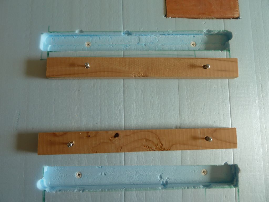

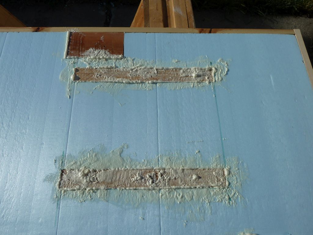

So far, so good. Did the galley door shelf supports. Thought I would show how I use the nylon-dry-wall-screws. Pretty hard to keep the wood in place with Great Stuff trying to foam it out of the routed slots - perfect for the dry wall screws !

So instead you used GG. Looks like you had no problems keeping the wood in the slot. I'll have to keep that in mind next time I need to fill a slot with GG and wood.
P.S. Just wondered, are you using the mix for all the pieces of wood you are adding to your build?
Fred Trout wrote:So far, so good. Did the galley door shelf supports. Thought I would show how I use the nylon-dry-wall-screws. Pretty hard to keep the wood in place with Great Stuff trying to foam it out of the routed slots - perfect for the dry wall screws !
pix
Re: Bread-loaf build thread
Postby Fred Trout » Tue Jul 21, 2015 9:09 pm
Used great stuff (GS) - foam in a can void & crack filler fomula (cheapest). [ I previously used up all my GG but never liked it - would foam well in one spot and do bupkis an inch over so I decided it was too hard to get it to foam evenly unlike GS]. GS can push the center out if you put too much there but it's easier to control for that than GG. I use rowerwet's technique of squirting the GS onto a palette and massage it into the consistency of peanut butter and then use a Bondo thingee to apply it. Basically, I now use GS for everything that TB II and Gripper is not any good for.
I use 'the mix' on any wood that could possibly be exposed to water. These two particular supports are in the middle of the back side (inside) of the galley doors under canvas, TB II & paint, so no mix on em. If they get wet, it's because my foamie got swept away in a flood and the doors got torn off :R :R I also fill all cracks (edges between wood pieces, wood and foam, etc) with caulk so water can't get in easily.
Gripper - tight join, panel to panel, panel to metal -- sands harder than foam (EPS Styrofoam)
Great Stuff - lots of voids, loose join, edge to panel, wood to foam, foam to foam, fill big holes --- sands easily, about same a foam in density
TB II - canvas to foam, wood to wood, tight join
GG - don't use it anymore even tho it works well. -- sands harder than foam
