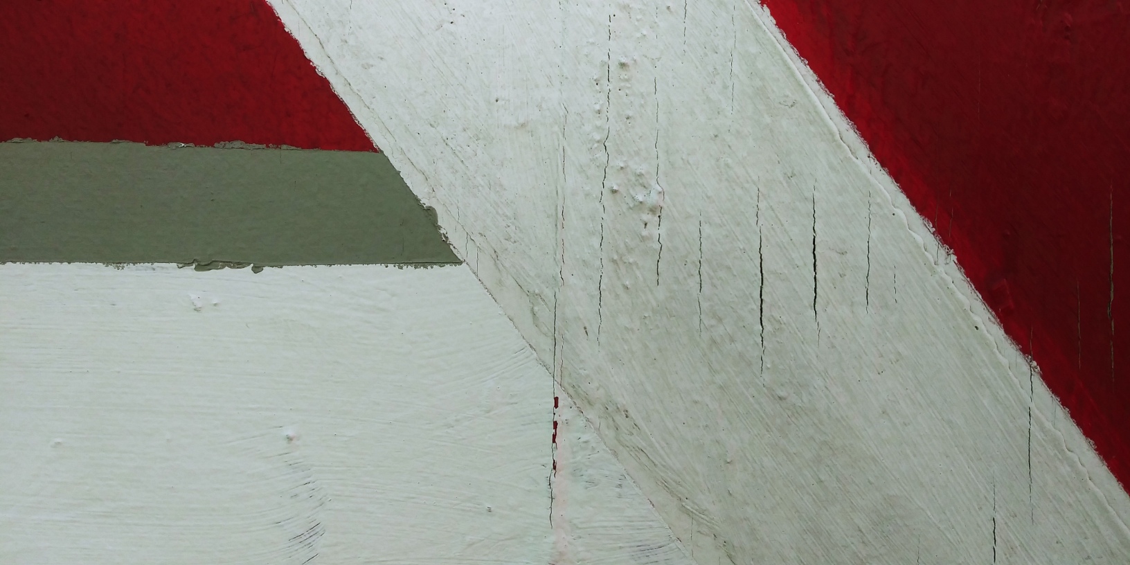

Let's see if we can post some pics
Problem with varied ply splitting.
With and without side by side sheets.
Ply issue specific to sheet grain I'm guessing.

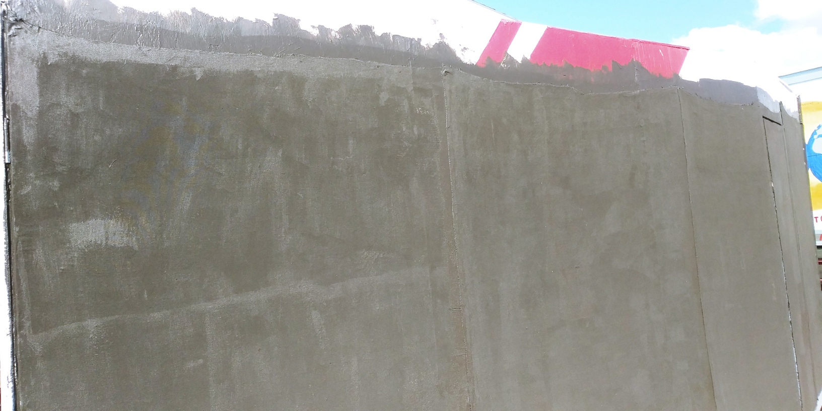

Postby Terra6 » Thu Jan 28, 2021 11:25 pm
Laying up cloth

Postby Terra6 » Thu Jan 28, 2021 11:26 pm
Peachy keen. 1 brown top coat + 1 peach topcoat.
Will add another coat or two.
Weave still pronounced.
Top edge cut straight.

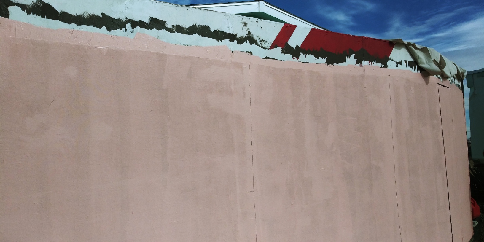

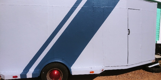

Postby Terra6 » Fri Feb 12, 2021 10:34 pm
And just like that, Voila! Done!
Well it may seem that way on a forum.
New color scheme. From brown to peach to now light grey with blue stripe. Did the roof in white.
Did the dilute with white trick to lighten the grey since the solar heat effect is so strong in my area. Even this medium grey gets hot in the sun much more than white.
My recommendation to you, always go white for the comfort factor unless you have lots of shade. The difference in comfort is huge.

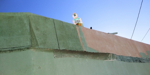

Postby Terra6 » Sat Feb 13, 2021 7:38 am
Well not at all quick and easy to accomplish as the following pic will show.
Had to perform emergency surgery.
Used Simply Orange Juice to save the day.
As mentioned previously, here's an example of what worked yesterday may not work today. Cut edges straight with xacto knife, peel excess, and then overlap for nice straight seams. Worked well for the first layer. Not so much on overlaps as it pulls the lower layer of cloth off as well. The paint adhesion level between canvas overlay is greater than the primary layer canvas adhesion to my painted plywood. Damn, F F F. :thumbdown:
So straight cut seams on overlap didn't go well at all as you can see from the pic with the bottom layer pulling up, off and curling/distorting. Much cussing ensues. :x :x
What to do as the paint is quickly drying on my overlap seams? :roll:
Re-adhere the layers flat and straight now that they are pulled and distorted required another learn as you go along and develop a technique.
This was going to require major, double bypass, open heart surgery.
Reglue base layer.
And overlap.
And get a straight seam?
The adhesion of paint as a glue is satisfactory but not super glue bonded. This is where Simply Orange comes in and I'll explain how to do it. :thumbsup: :applause:
First, sit down and assess the situation with a glass of Simply Orange. :beer:
Drink all the oj and use the empty jug to store excess TB for future fortuitous use, like 2 yrs into the future.
Allow current predicament to settle overnight while formulating a plan of attack. :roll: :worship:
Next, liberally brush TB glue under seams where necessary, staple edges and allow to dry. Sorry conservatives, we're going to have to go liberal on this. :lol:
As a result, this fix didn't allow for any seam overlap with reduced risk of water infiltration at the seam joint. But with glue and enough paint to coat the butted, open seam joint, should be fine. Right? :thinking: Right. :worship: This is where positive thinking comes in. :thumbsup: Some may call it denial.
Small gap imperfections were filled.
Another crisis overcome.
For now.
Till it rains.
It rarely rains in the desert.
Phew.
Problem solved.

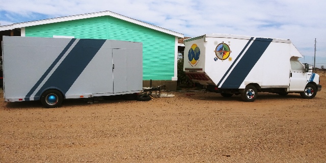

And thus the reason for the color temperature effect to sun exposure.
Should I paint Terra6 grey to match the grey trailer?
Have left over grey.
From the temperature experiments, no. Will stay cool as possible with white even though it is hard to keep clean from road grime, dust and dirt. Life is compromises. Best is to stay in the shade but it doesn't help my solar much and there isn't always any shade to be found in the arid desert landscape.

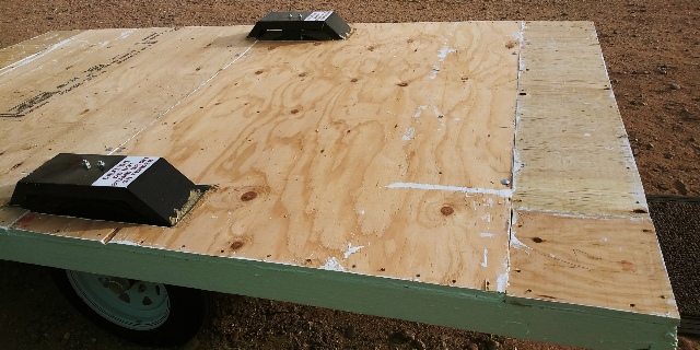

Another project?
Gotten this far today...
Took a 4x8 HF and expanded it to 6x10.
Hmmm, another build thread on this?
Anyone interested in how I've bumped it out?
Terra6.5?
