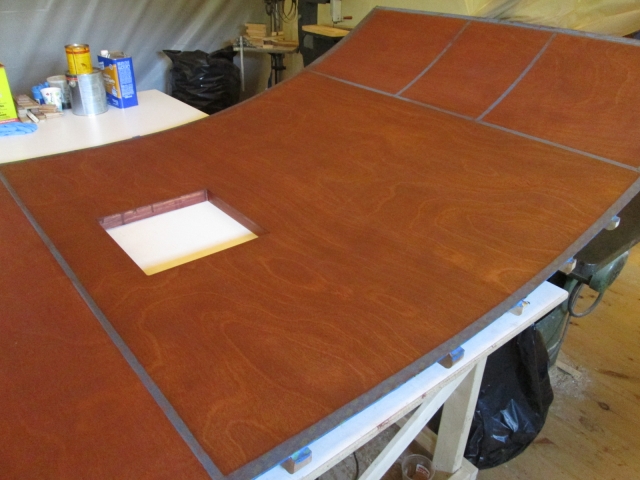

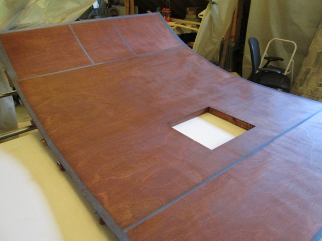

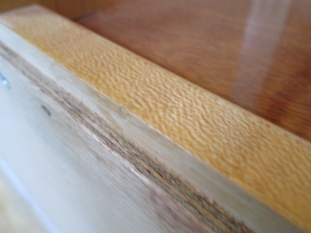

I’m sure I read on here somewhere where someone swore by applying their stain first like a sealer coat, then sanding it back off, then reapplying it. I sure wish I knew who to credit for that because I’m here to tell you that I think it has given me my best result yet. Here is the ceiling after reapplying the stain.
The stain went on really nicely, and rubbed off just the same. The original sanding scratches are gone.

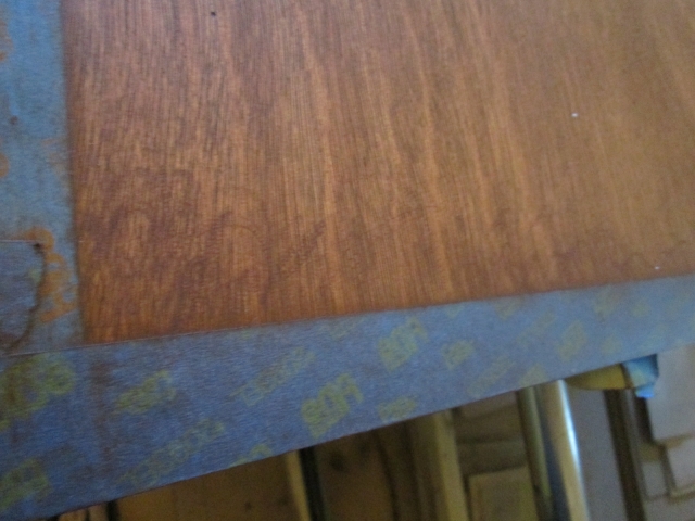

This is that factory flaw I mentioned. Like Cindy Crawford’s mole, it will add an alluring quality.

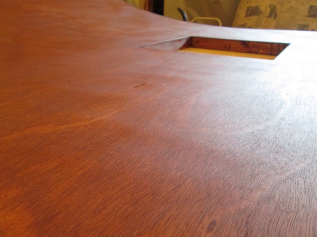

I did manage to create some new sanding scratches along the edge of the curb side; sort of swirly like from the palm sander. Not sure how I managed to get these just on the curb side; thought I used the same technique on both sides.
I can live with these because they are not blatantly in the field.

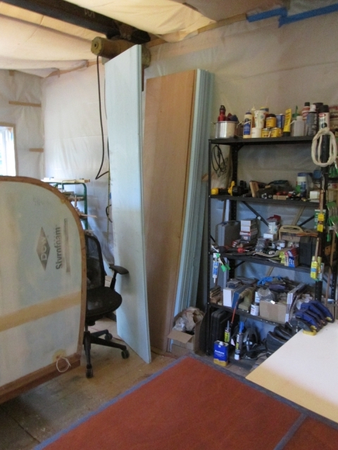

Then I had one of those contemplative sessions where you just sort of move around, stare and think about future tasks. While sitting behind the galley and contemplating how I want to configure the small positive vent fan chase, I fingered through the stack of 3/4 inch foam that will go on the roof in two layers and found some long drops of the 5 mm ply that I forgot I had.
Doooope! :shock: I could have used some of this instead of splicing two sections together at the back of the ceiling panel. Oh well, they can also be used to make the side wing tables. :thumbsup:

next... re those swirls... most likely your sander picked up a piece of larger grit, (several clumped together) and that's the pattern that resulted. You could try backing up a grit one level rougher, lightly sanding that area, then come back up to the grit level you were using there to get rid of them.
