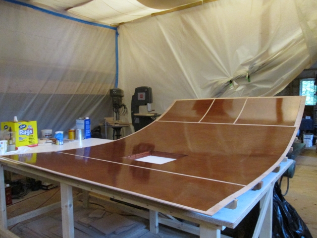

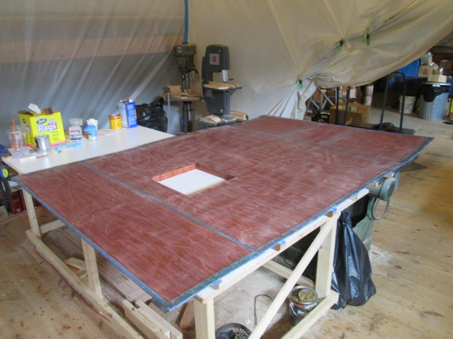

Okay, plumbing job done, new tellie figured out, and back in the shop today. The second coat of poly was pretty damn good. There were a couple of small bumps (I assume these were dried chunks of poly from the plastic pot I was reusing) and the grain of the wood wasn’t quite filled in yet (those little pin holes everywhere), so I decided to go for another coat.
I wasn’t sure that I was going to need a whole ‘nuther gallon of poly, and the ‘high build’ stuff wasn’t available in the quart size (at least not at the big orange). The dude there said it was the same stuff with a different label, but I didn’t buy that for a second. Turns out that it is much thinner and seems to take more product to cover. I underestimated how much to pour into the pot twice.
Anyway, these pics may seem a little redundant, but progress is progress!

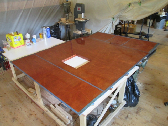

After blocking the whole thing out with 220 grit on the small hand block, and wiping the loose dust off with a shop paper towel, I tried something a little different. I folded up the paper towel and wrapped it between the block and sandpaper to make a soft backing; then went over the whole panel again. This helped get the edges where the tape was and the lower areas between the highs, without resorting to putting any finger grooves or waves in anything.
Wiped it all down again, then again with a fresh towel damped with mineral spirits, then brushed on what I hope will be the final coat of poly. Here it is still wet.
I suppose I need to start masking off the cabin in prep for glue, but I decided to avoid stirring up dust and called it a short day.

Yesterday I had to inspect the front end on the Jeep and do a tire rotation. Death Wobble temporarily averted; cupped left front tire with a leaking shock absorber. After 165k miles the original unit bearings, ball joints and steering gear all check out nice and tight. Then I was dirty and sweaty, and it was hot and humid.
Tonight I peeled the masking tape off of the ceiling panel.
I looked at the finish and decided that it was at least as good as the rest of the cabin work. The gloss finish is hard to live up to. There’s a pretty significant run in the front cabinet area, and there are still thousands of little pin prick like points; at first I thought they were just pores in the wood that hadn’t been filled, but now I am thinking that they might be mineral spirit ‘pops’. I’m not sure about the standard (non-high build) poly. But then again this is looking very closely with a critical eye. The big picture is good overall. In fact I gave another tour tonight; Kelly, a friend of Chris and Karl. She was very impressed and commented how the inside of the cabin seemed like a vintage wooden boat. Excellent! That is exactly the vibe I have been going for!
The lighting had gone away a bit, but here is the requisite QC test.

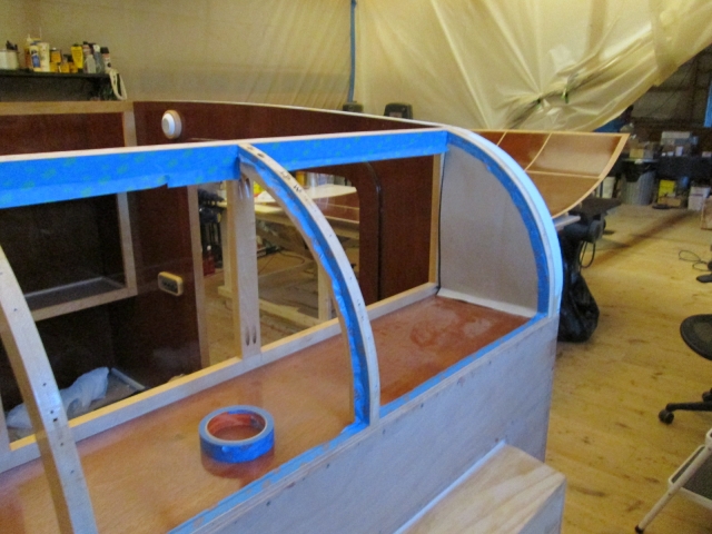

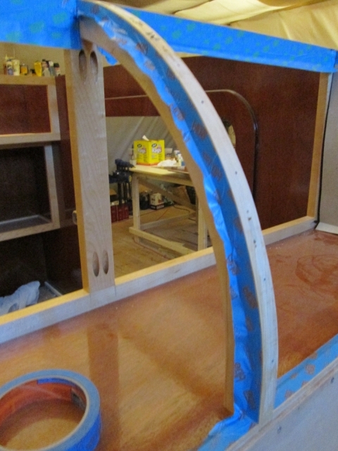

Next I started masking the cabin in prep for gluing the ceiling on to the box.
I repurposed the chipboard that I had used to make the pattern for the gun locker vinyl and made temporary side covers for the side walls in the front cabinet.

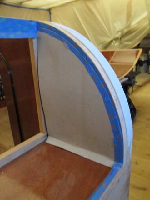

Then I started to mask the riblets. Note the cupped lower edge of the tape, so that it will redirect any wanna be drips. I will also lay a piece of the rosin paper down on the shelf to catch any drips.
Inching forward, step by step.
