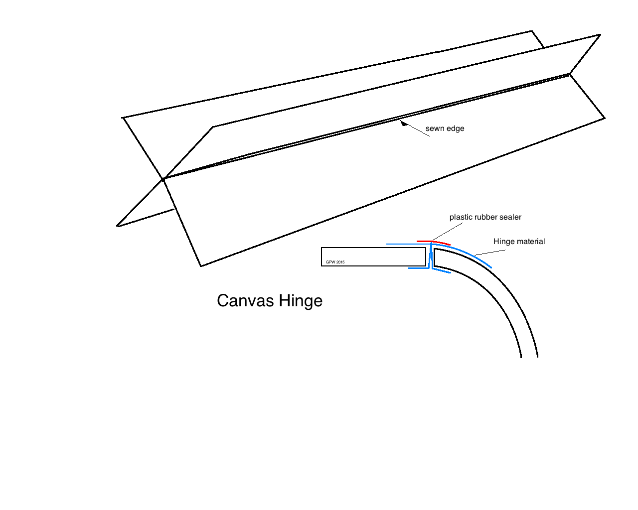

Living hinge ...? You guys know how to make a canvas hinge ... ??? it’s simple ... :roll:

Postby GPW » Mon Oct 26, 2015 6:42 am
Here’s my idea , based on years and years of making plastic film hinges for my Foam airplanes ... :thumbsup:
canvas hinge .png (55.44 KiB) Viewed 1358 times

Thanks Glen - living hinge just arrived and seems like the safest option.
