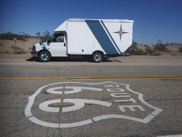

Postby Terra6 » Thu Oct 14, 2021 8:08 pm
So George, what paint have you been using, cost and qty to complete a teardrop?
Thx for liking my thread and hope you find it helpful.?
Tried to take pics of the gloss but not able to show it with clarity. Here's the latest pic with new design scheme. Retro atomic which is classic and simple in a Thunderbirds are go kind of way. Might add to it tho.
On the road to Shambala...
