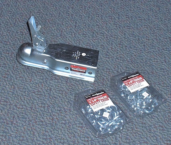

Got my Coupler for 3” sq. tube/ 2” ball , and two safety chains... Can’t weld today ... weather is c**p... But we’re ready anyway ... :thumbsup:

Hey Geep, you might want to check those chains out a little closer. At 4 ft long, they may have a hook at each end. That means you can cut the middle out of one to suit the length you need, and take the other package back for a refund. Thrifty.
The ones I bought had two hooks on one chain in a single package. :D

Whoa COOL KC !!! ... They do have a hook on each end... :o But I was going to use those “loops “...guess I could just hook em’ to the loops huh ? Was going to permanently fix one end in the loop (theft-proof) ... But maybe I should store the chains instead of leaving them on the trailer all the time , might last longer eh ... Hmmm???  :thinking:
Two chains = twice as safe ... or does it work like that ...? Don’t want to lose the investment eh ? :frightened:
And KC , while you’re here..... since this is going to live outside , I was thinking of packing the coupler mechanism with some kind of grease to prevent the rust that caused the current one to “fuse” together in a rusted mass... grrrr!!!! :duh: Is greasing a bad idea on a coupler ??? ... I don’t ever recall hearing about that before , never tried it on boat trailers in the past , but saw a Lot of rusted mechanisms for sure. Just wondering ?

What I do with the chain is cut the center link out with the cut off wheel in a grinder. Figure out how long they need to be and cut each half to that length; 2 ft is probably still too long. You want the TV to be able to turn full lock, but in theory, the tongue should not hit the ground when resting in the crossed chains.
Once you have cut both to the proper length, feed the "footman's loops" thru the end links and weld them to the lower edge on either side of your tongue tube.
Two schools of thought on coupler grease. One side says it collects dirt and makes the abrasion issue worse, plus gets you and/or your pants leg dirty. The other side says to grease for long service life and quiet operation.
I use small smear of grease myself, but have been considering trying cutting wax; the stick kind. For the adjuster mechanism I would be more likely to use PB Blaster, or some other penetrant.

QUOTE: “ You want the TV to be able to turn full lock, but in theory, the tongue should not hit the ground when resting in the crossed chains.” ... We’ll have to do some figuring on that :thinking: Maybe just lower the jack till the coupler is x” from the ground and then measure the chains crossed ??? Thanks KC, I always wanted to know the correct way of doing that ... :thumbsup: 8)
That should be a Sticky huh ? :thinking: Everyone may benefit from properly installed Safety chains !!! ;)
KC , mostly I just wanted to grease the adjuster.. the bolt and nut ... not the ball ...

GPW wrote:...mostly I just wanted to grease the adjuster.. the bolt and nut ... not the ball
Light oil. Sewing machine oil; PB Blaster; 3 in 1, work it around some, then wipe any excess. S'what I would do.

Postby Jack B. » Fri Jan 24, 2014 7:19 pm
I was always told you were supposed to put a little grease on the ball at least. What I do is use some of the dry chain lube they sell for bike and motorcycle chains in any of those places I want less friction AND less grime build up. Kinda sheds water and keeps the stuff that's supposed to move moving and is pretty easy on the clothes if you get it on you. Or go with the not so dry chain lube for better penetration. A bit more messy but not bad as it's made to soak in and be wiped off the outer surfaces.
