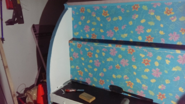

Well before I got to cutting on the hatch to make it fit I thought I'd better get my bulkheads in and see if that changed anything about the way the hatch fit.
The answer was no. Which is good and bad. Because it's still wrong but at least it means I can do my line scribing while not trying to close myself in the galley.

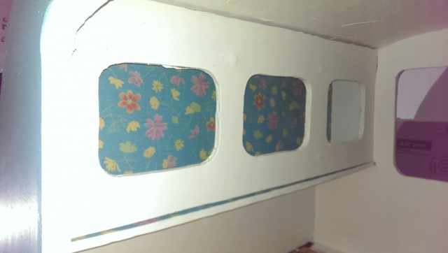

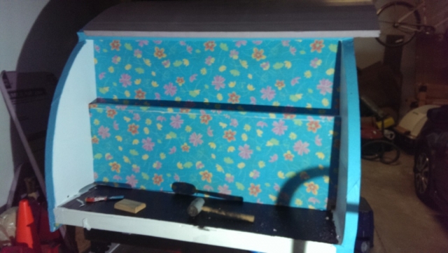

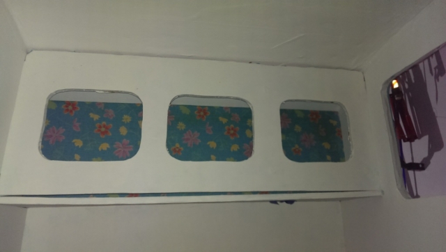

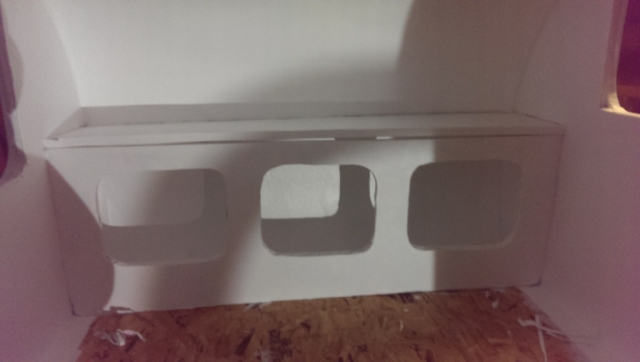

So these pieces have been primed where they are white and do not yet have anything on the floral parts. But that is on my list it's suppose to be warm enough to paint this weekend! I test fitted these pieces for the first time since any of them had fabric or paint on them. I had as you may recall cut grooves in my sidewalls for the foam boards to fit into. It appears that things swelled ever so slightly in the intervening months. I had to sand off a bit of each end to get everything in. That said it all went together great, and while there are a few visible gaps now they all close up with just the littlest bit of pressure so I figure some glue and some clamps and I'll be golden! I think I like having left the inside of the over foot cabinet floral. And the view from the galley hatch is cute, if I do say so myself. Obviously a counter will still yet be fitted in there. I have wooden blocks glued into the foam to mount it to at a later date. (but it isn't relevent towards weatherproofing so it can wait a bit)
I cut the fabric/glue that went over my slots. I then actually trimmed out half an inch or so of the fabric from the center of each slot. This gives enough tail to tuck in and look tidy but not too much bulk in the slot.
This is the cabinet at the foot end of the bed. I think I will leave the flowers visible there. That was still up for debate until last night. (Of course pending finding some way to coat the fabric and preserve the integrity of the floral pattern.) I have little 3d printed plastic studs I can hang bungie net from to make "doors" to keep stuff from migrating out if necessary. A few ounces of pressure lines up the edges of the "boards" and makes that all look much more tidy. I"ll be gluing them together so that will not be a gap in the future.
Floral Galley! that's the hatch in progress sitting on the top of the trailer.
The head of the bed cabinets. I will be making doors to cover the openings. (once again not relative to weather tightness and therefore will be being put off for a bit. (this gap will also close easily and I'll be gluing the top to the vertical part as well)

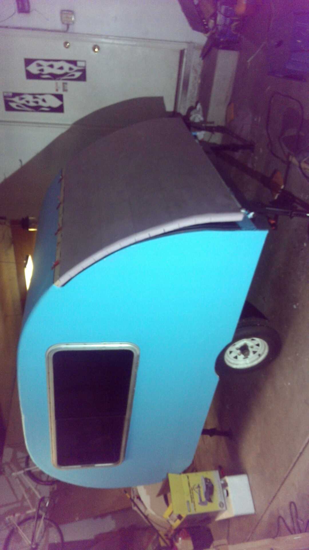

I also solved my hatch skew issue. Monday night I had two friends hold the hatch in place (I placed it) and then I crawlled inside, scribed a line to cut off to square up the sides. Last night I glued in the hinge renforcement strip! Tonight I think I'll plane off any GG ooze and fit it in place possibly with the hinge actually holding it (Maybe I'll just use a bit of ratchet strap and some screws. I have one that went awry under a muffler while it was loaned out and it's too small for any real use now.)
Once that's held in place I can scribe a line for the bottom edge. Cut that off, put it back on the trailer and mark the blocks for the latches and props. Inset those and and latch it up. Then round off my edges to match the trailer. And I am off to the races with canvassing it.
