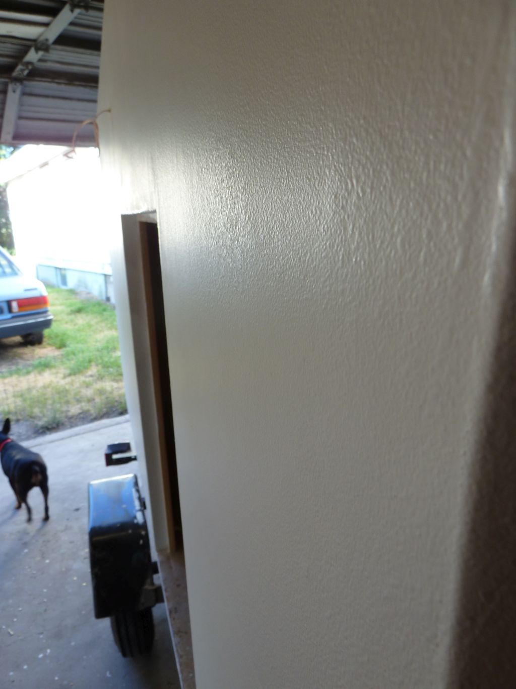

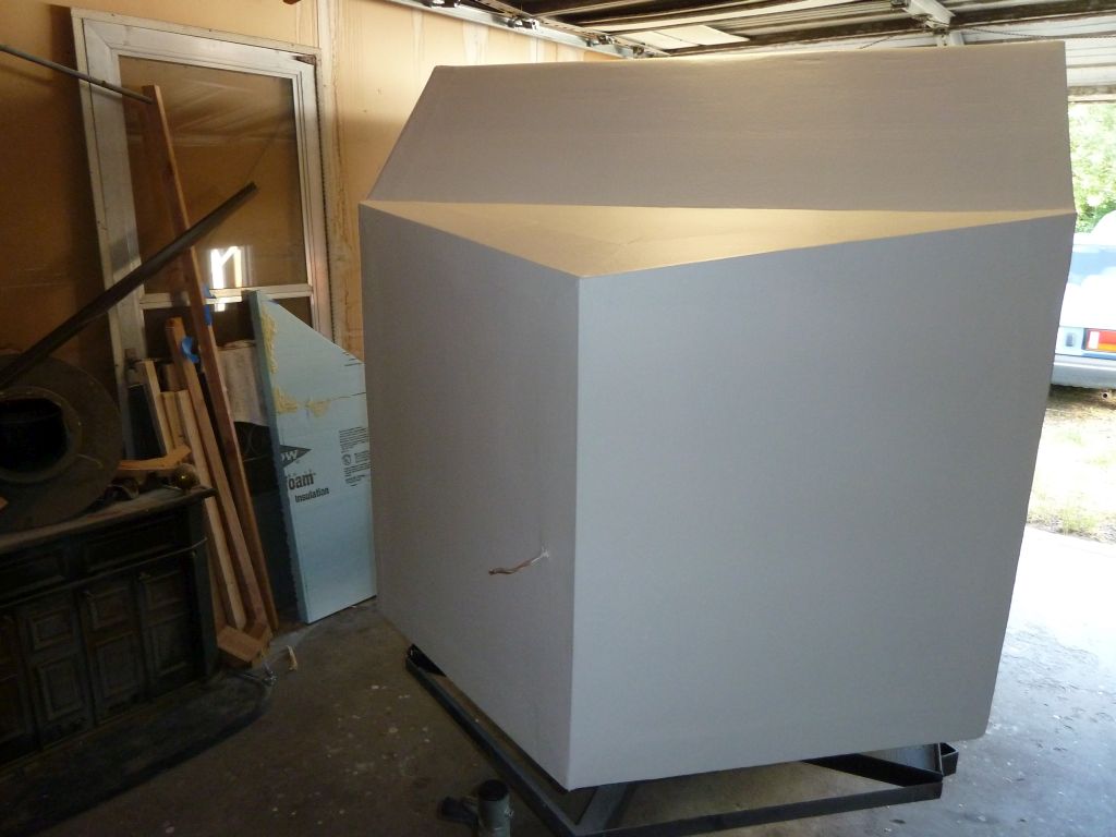

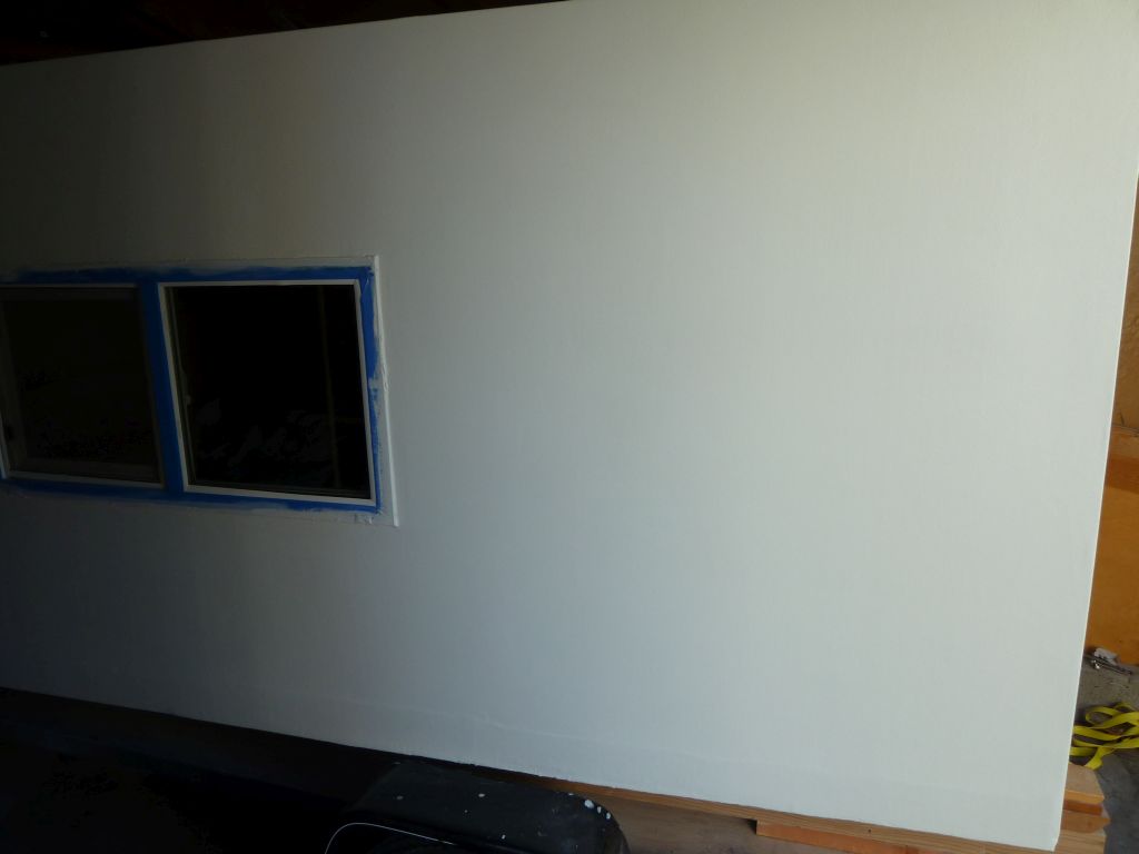

Looks nicer than I expected in the light of day. So on with the pix:

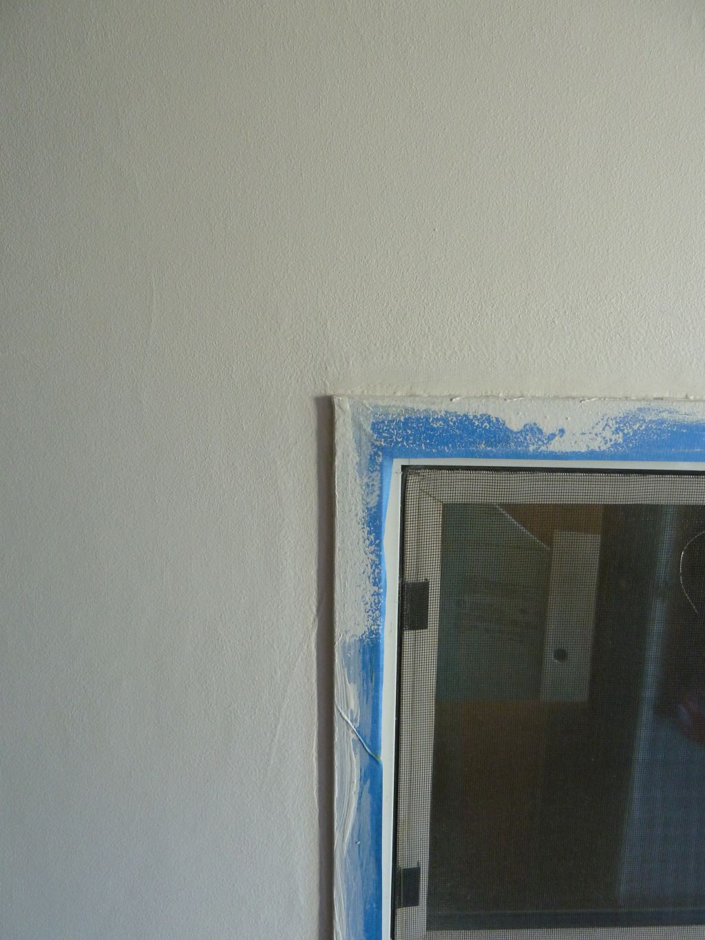

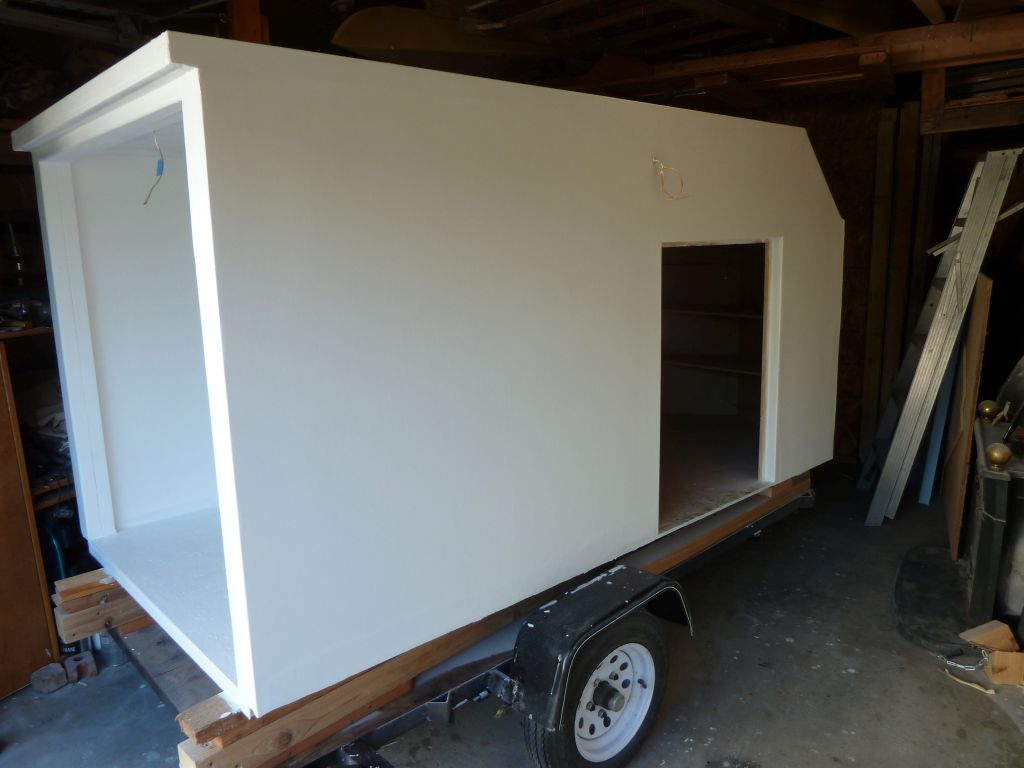

Postby Fred Trout » Thu Jul 30, 2015 9:21 am
Moar !! Interesting how the creases in the canvas show but the fabric weave does not. I suppose I should have ironed the canvas but I just don't care. My clothes all show the wrinkles and so does my face, so I suppose it's all appropriate. Perhaps I should call the TD "Wrinkles" :R :R :cry:
After reading about what kinds of paint hold up best to outdoors exposure, I have settled on 100% acrylic Glidden Premium semi-gloss white as my base exterior paint unless somebody tells me DON'T !! hehe

Postby Fred Trout » Thu Jul 30, 2015 12:53 pm
Thanks, KC & Dales. There are lots of uneven spots, bumps, wrinkles, even a few little spots where you can see the canvas weave if you look very close. If I were an artisan instead of an amateur, those would not be there at all. It's way past good enough for me though. The canvas overlaps still show in places but they are minimized, which is also good enough. Perhaps a second or third spackle coat would be required to make those go away and I want to get camping already !!!
The moral of the story is that if you do not like a canvas fabric pattern, a spackle skim coat will make it go away at the cost of a few hours of application & sanding effort w/ dust. Pretty easy fix. The only difference between a skim coat and normal spackling is skim coat spackle is much more watery - about like yogurt or custard.
