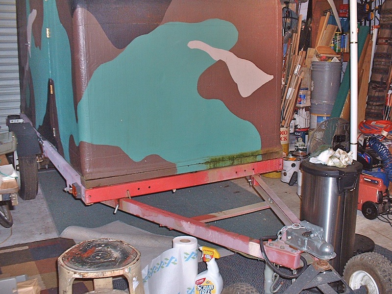

Been working on fixing up the Foamie #1 to leave ... :o One thing we noticed ... on some bare areas of canvas on the side we sanded with one of those foam block sanding pads ... and that made the finish a LOT Smoother ... Little imperfections in the paint , all smoothed out ... Never expected that ... 8) With a coat of primer and some light sanding , this will come out pretty Smooth ... Ready for the final coats of color ...
After almost 3 years of living outside , the only problem encountered was the window hinges and screws ... supposedly were Brass, but weren't (rusted) , so are replaced it with a new SS hinge and SS screws... You can see how the Cheapo Wal Mart paint has dulled in that time ... Going back with the Good Stuff, same as on the FoamStream actually ... ;)

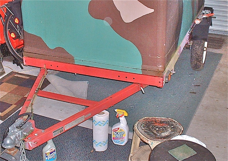

Well then , after starting a good scrubbing , what appeared as dullness was in reality .... Dirtness' .. and Greenness... :frightened: A little cleaning goes a long way , and even the dull pink HF trailer looks Much better now too ... :duh:
Re: FoamStream...
Postby GPW » Wed Apr 30, 2014 10:47 am
Whoa !!! What a difference !!! :D You can see the side trailer frame how dull ... that should clean up nicely too ... 8) Odd , only the back and front have the Greenness... front the most by far (now gone ) ...seems like it should be the same all around but not ... but then the front was facing the star Polaris for a long time ... That would do it ... :thinking:

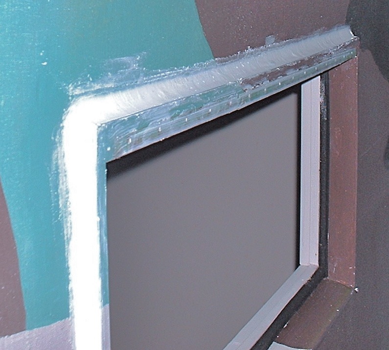

let me see what it looks like when I get the whole thing cleaned up ... I particularly want to look around for any Rust that may be happening ... Take care of it now , won’t have to fool with it later .. I have a can of Rustoleum Sunrise Red (which is supposed to be a match , or close ) just for some touching up anyway ... Right now I did a better job of caulking the window frame , although the first one seemed to work fine (no leaks) , this will be ... Prettier... :D
Funny , all the second hand trailers I got looked like they hadn’t seen anything more than a hose down in 20 years ... :frightened: :roll:
Re: FoamStream...
Postby GPW » Thu May 01, 2014 7:07 am
Caulk said let dry two hours before painting ... I gave it 20 ... Nice and dry now , a little sanding to further smooth it a bit and we’re ready to prime... :D This is a much better fillet than before , my tool was a “wooden nickel” ... Worked great !!! So if someone offers you one , take it !!! ;)
Ps. you can also see the bottom of the window frame is tilted down and out for better drainage ... That has worked great .. :thumbsup:
Re: FoamStream...
Postby GPW » Thu May 01, 2014 1:32 pm
Just ran over it (caulk job) with a Scotch Brite pad , that cleaned off all the extra little bits , leaving it nice and smooth ... Although it didn’t leak before , it will surely be waterproof now for a Long time to come .. best get all this up to speed now so the new owner won’t have Any problems down the road ... ;)
