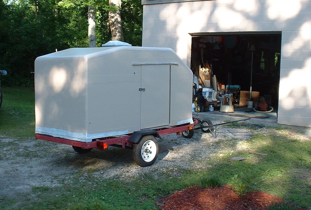

LT, it’s “urban“ camo .... The House , the FoamStream , and now the little one ... :o Hey, I Had the Paint !!! Thrifty , and it was really GOOD paint too ...no reason to let it sit around and go Bad eh ... :D

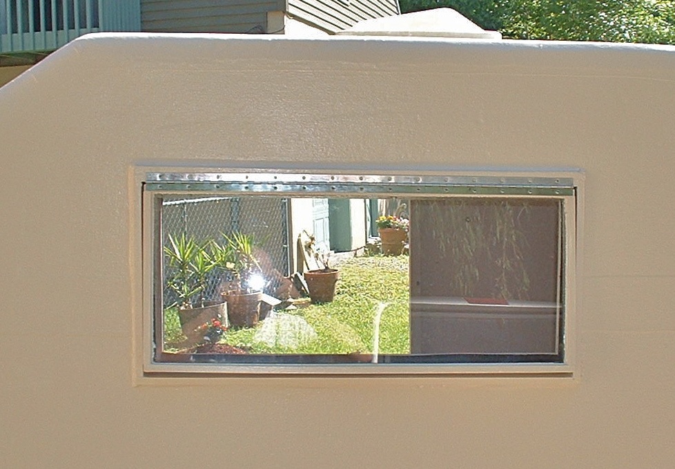

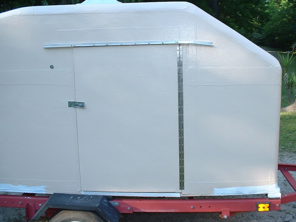

Got the window hinged and mounted with the new SS hinge and screws (Goodbye rust) ... Same type hinge on the door , yet to be mounted on the cabin ... but soon ... ;)
Waiting till tomorrow to do the contrasting lower color (green) on the little Foamie ... The paint has to be really Dry before we can do any taping on it ... otherwise it might peel off ... :frightened: Patience is required with painting ... !!! besides , “It’s Miller Time ! “ :beer:

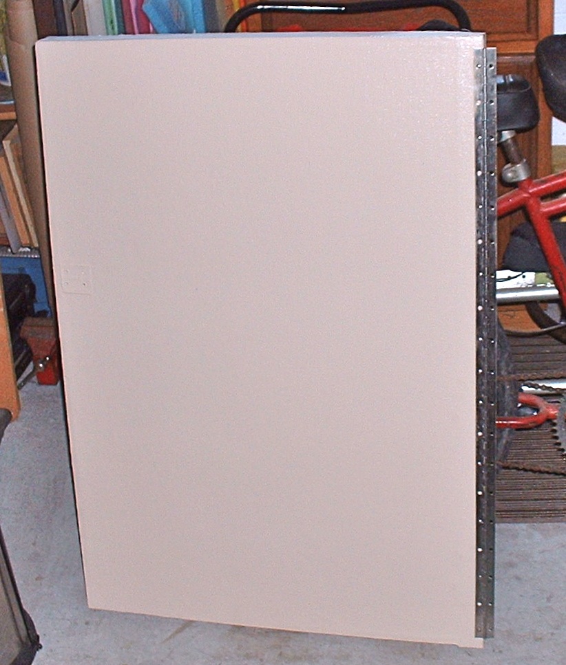

And some pics from the end of the day ... Door’s on , and now it fits better than it ever did before... Golden Hour... Ahhhhhhhh !!! :beer:

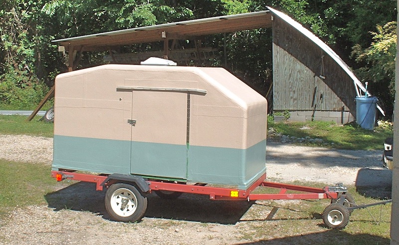

Well, it’s another Sunny DRY day !!! :dancing Getting light now .... all ready for the second color application ... Just waiting for the morning dew to evaporate ... :D Couldn’t ask for better painting weather ... warm , dry, no wind... Gotta’ take advantage of this and “Get it Done “ ... 8)

Got the first coat of the Green on the bottom .... really happy with the way my tape line is coming out ... This time we brushed the paint on the tape edge in a pouncing technique , like the stenciler’s use . Nice CLEAN separation , waaaaay better than on the FS... The roller just pushed paint up under the tape ... Nasty edges resulting .... grrrrr!!! :duh:
Another coat of green and then we mask off and do the accent stripe ... Coming along ... 8)
