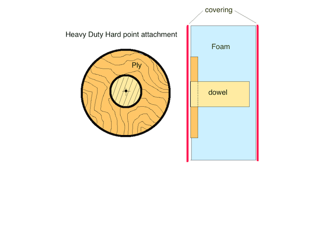

You mean like insetting /flush mounting the ply ?? That would be very Nice ,and you could cover over it with the inner fabric ... Thinner ply might work well as the foam does assume some of the load , but deforms around high stress areas left unsupported ..
Example ,if you just drilled a hole in the foam , glued in a dowel and put a load on it , it would eventually sag around the hole and fail ... Supported with some thin ply in the area , it would be able to take Much higher loads safely ... Here’s a pic of my “hard point “ attachments , you can see how the ply spreads out the load at the surface where it receives the most downward force... Image
