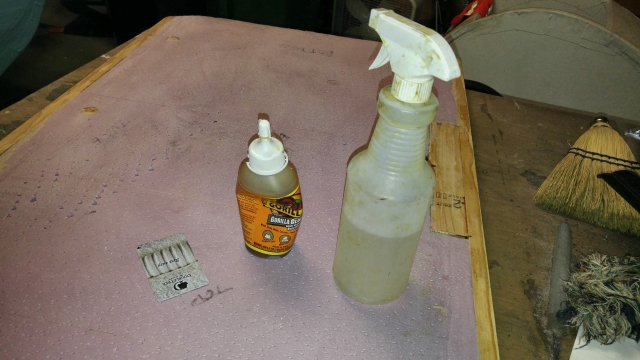

UNTIL.. I needed to get something out of the garage that was between the trailer and the wall last week. (I needed a big table to break down half a hog on) In this process I lost my balance and leaned on the hatch which was just barely tacked on with some screws and webbing straps to hold it in place for shaping. :cry:
I hadn't covered it yet. So it snapped off at one of the kerfs. Just cleanly all the way across. I am hoping to get after it with some gorilla glue and see if I can get it back together this weekend. If so... next weekend I'll start the canvassing process, so it is less fragile, and also so I am closer to done. Pictures will come when I do the work.

Well filial duty prevented much progress but I did get the hatch parts glued back together.

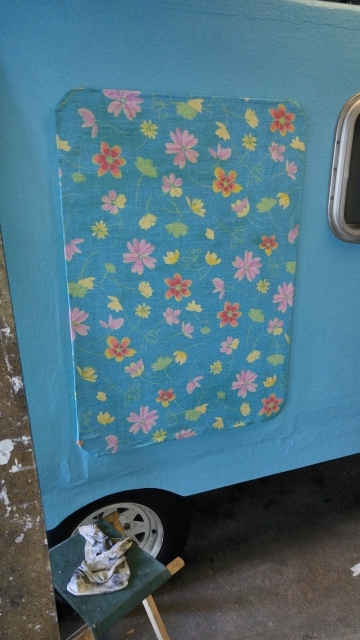

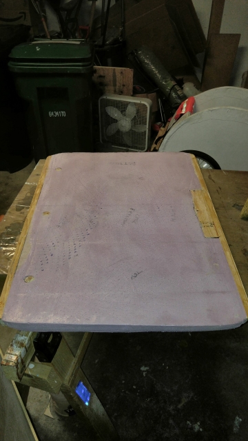

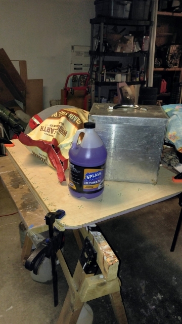

Postby lthomas987 » Mon Sep 14, 2015 4:10 pm
I took my foam cut out from the hole, and trimmed it down, added wood on both edges, as well as a wood block for the lock set and wood plugs for the hinge leaf.
I then sanded and punctured both sides.
Glued a piece of plywood over it that overlaps on 3 of the 4 sides (not the hinge side). The foreman graciously allowed me to use his kibble as weight.
The door was then canvassed (no photos of that process because it was super tricky to get all the corners folded.
It fits a bit snugger than I would ideally like before paint. I hope to paint this week and give it a nice long dry time before installing it.

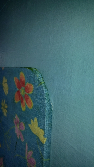

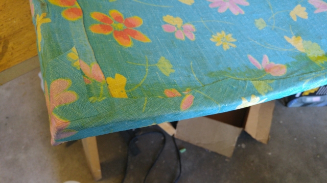

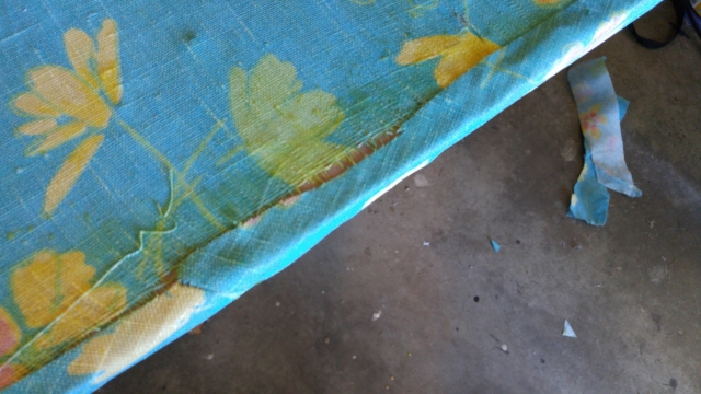

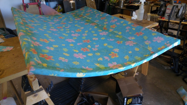

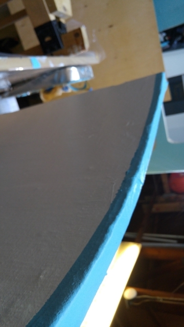

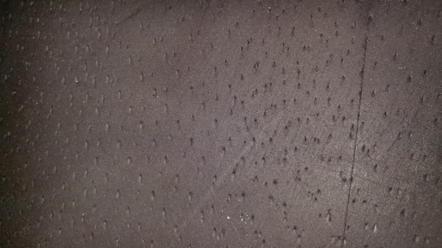

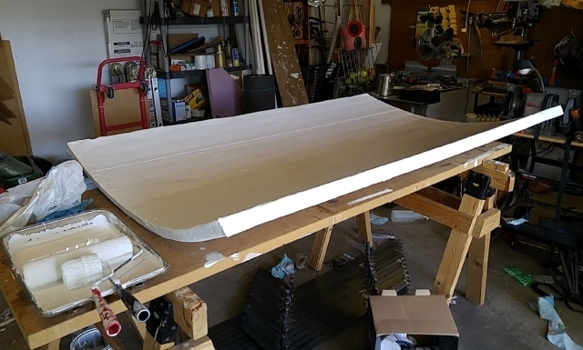

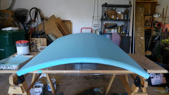

Postby lthomas987 » Mon Sep 14, 2015 4:27 pm
Here's some updated but not fully up to date photos of my hatch
Here it is covered in linen. You can see I did a really mediocre job cutting my bias strips...I just wasn't into it for some reason that night an I should have just let it go. But in the end wobbly edges won't matter as long as the foam is covered (and it is)
It got primed with Glidden Gripper.
And painted to match blue outside, white inside.

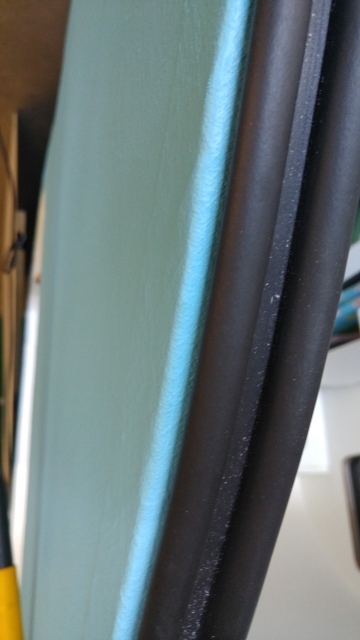

I'm using this double bulb seal from McMaster to seal the edges. It is just about as wide as the wall of the foamy it's stuck to. I am very happy with it thus far anyhow.
The whole thing is actually installed now with a living hinge, grey putty tape, and aluminum strips and all. I will try for some photos of that soon. I was surprised I didn't have any actually. The only problem so far is that the hatch weighs so little that it doesn't compress the seal with its own weight. So it will be the job of the latches to hold it closed. Right now the seal pushes up on it enough that it is about 3-4" away at the bottom when just hanging unsupported. It does close with a very small amount of pressure to compress the seal.
