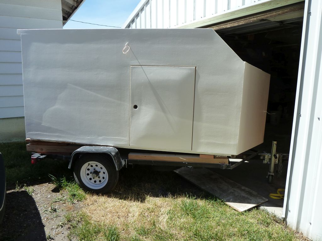

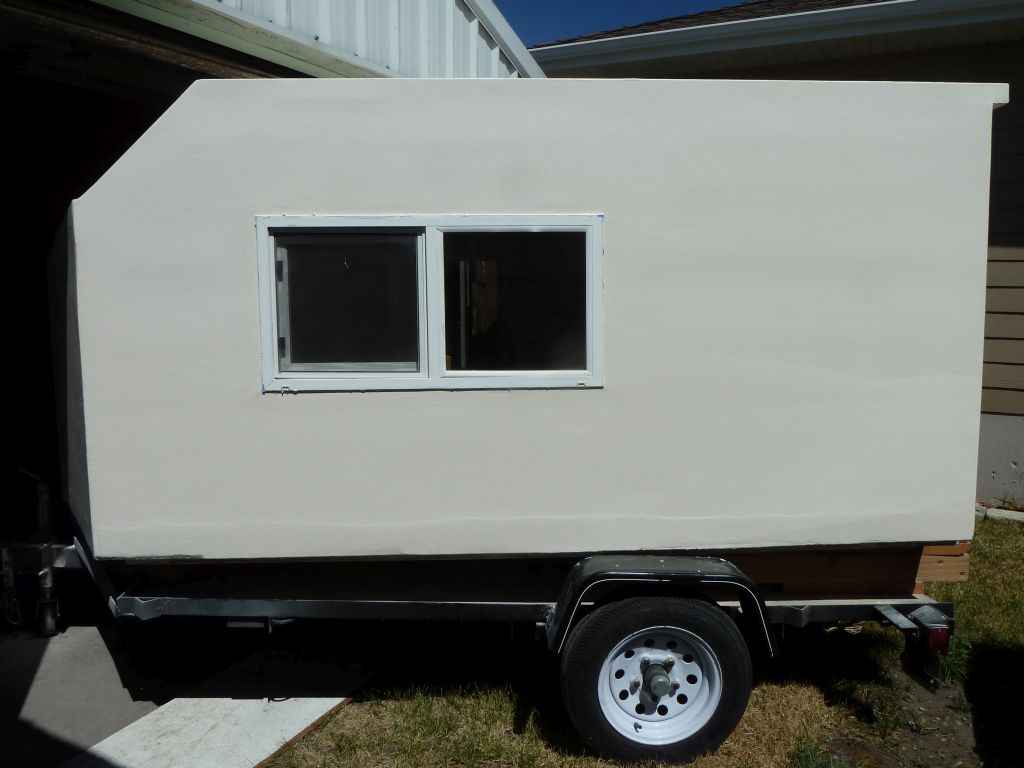

Finished the first coat of exterior latex. This Glidden Premium (100% acrylic) is very nice paint; goes on smoother and covers better than other exterior paints I have used and the price is very reasonable. Just waiting an hour before I put the final coat on; need to do the backsides of the 3 doors tomorrow. Will post some pix later this afternoon after the second coat dries enough to stick the doors in place temp for the picture.
EDIT:
Pix in the sunshine so you can see all the warts
Finish paint 6.jpg (102.71 KiB) Viewed 13522 times

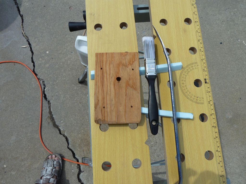

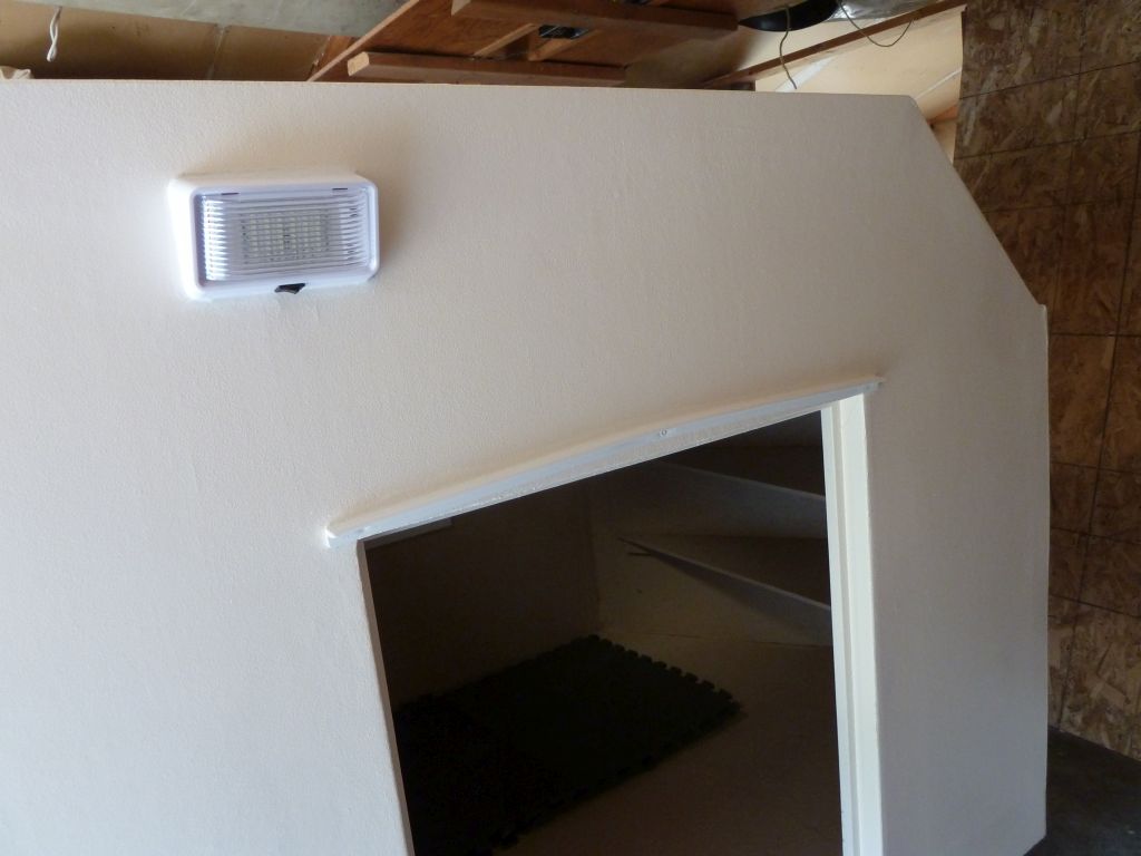

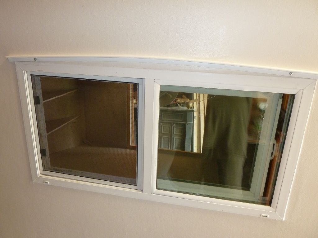

Still have lots to do to get it weather-tight but it's coming along. Did the drip rails for window & door; partway done with light fixtures. Need to buy the Sika Pro stuff to mount the Fantastic Fan & Vent. Will be using the supplied gasket and sheet metal screws to mount to flashing along with that Sika Pro self leveling caulk. Also need to route the wiring - after finally checking which way the wiring comes out when pointing the opening to the back - the drivers side, will need to add wiring to reach the junction box - pain in the butt. Should have the front light done after the plywood stops absorbing "the mix" soon - probably have 4 coats on it so far, then mount the plywood to the foam w/ dry wall screws & the light fixture to the plywood.
vinyl molding bends nice, screwed and glued on with caulk
Window drip rail.jpg (99.48 KiB) Viewed 13502 times

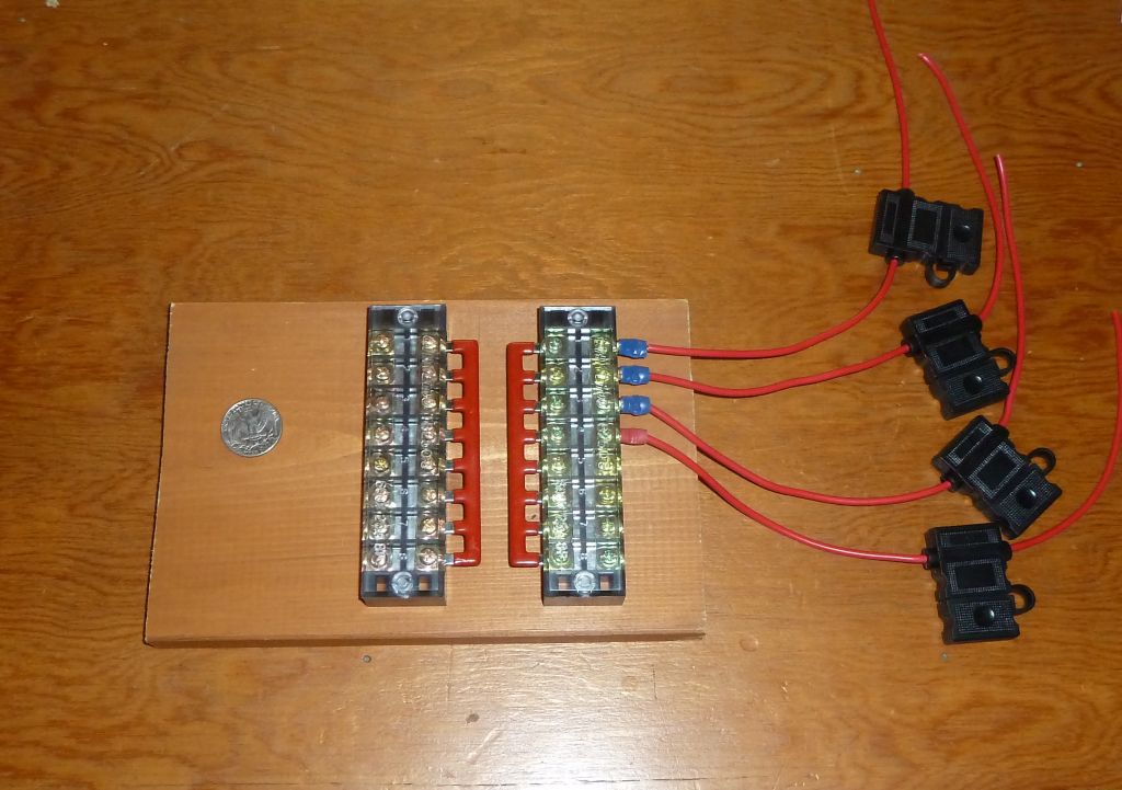

Bus Bar & battery off switch will be mounted here
More pix:
This setup was much cheaper than combo bus / fuse bars
12 volt bus bars & fuse assembly.jpg (105.67 KiB) Viewed 13499 times

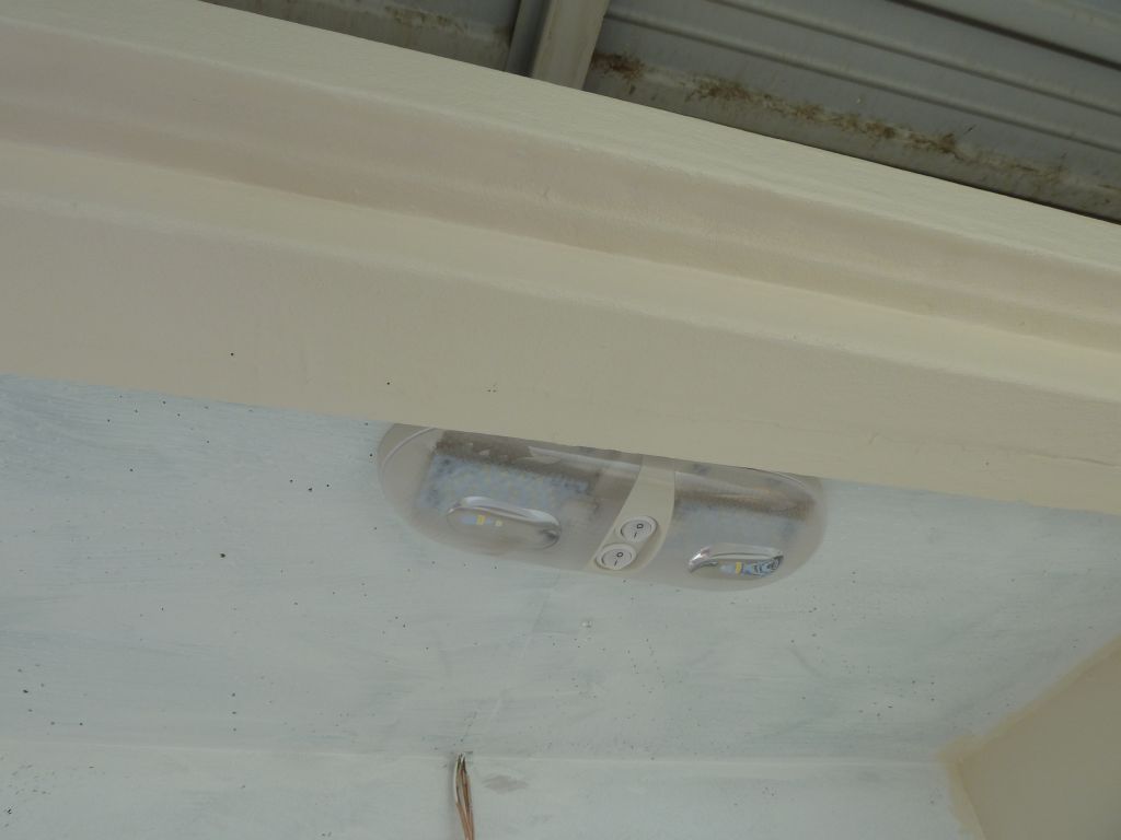

double light fixture should put out more light for cooking

- discovered I was painting the plywood with plain mineral spirits not the mix - DOH !! :oops: Hehe, have two coats of the right stuff on it now.

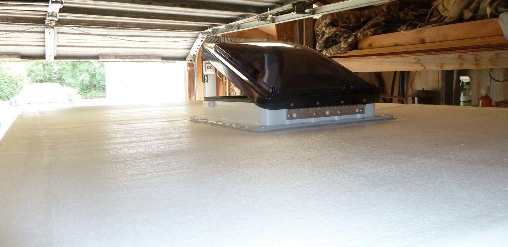

Finished front LED install, passenger side door, Fantastic Vent.
Front LED needed to be mounted to 'mix' coated plywood and the plywood mounted with dry-wall-screws because the dry wall screws would not fit into the standoff tubes inside the LED fixture.
Fantastic Vent was supposed to be sealed with Sika Pro self leveling adhesive/sealant but this is a pain in the butt to use. You need to put several coats on because it spreads out like pancake batter partially exposing the surfaces needing sealing. Whoever decided that was a good idea and put that in the instructions on-line is just plain wrong. There is guaranteed to be a ton of better sealants that will do the job in one pass; make a note.

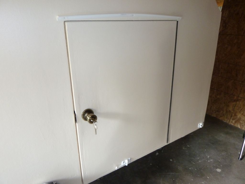

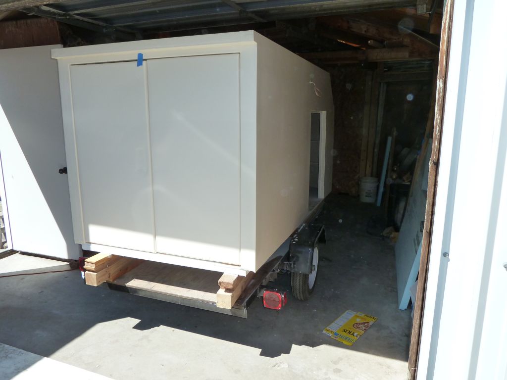

Installed the piano hinge with a bicycle tire inner-tube wrapped around it; tried to glue inner-tube in place with Gripper and it works well enough to stay put while installing. But it did take a while to dry and taping in place was required after paint application. Installed the piano hinge to door, then assembly to frame opening. Doing it the opposite way (frame first) was too difficult w/ one person alone. Lockset works decently and the plastic-door-open-retainer was installed as well. Door gives a satisfying clunk when closing & swings easily despite weighing a couple of pounds :R :lol:
Onward to rear doors; received the astragal for sealing the opening between the two doors today so great timing....
