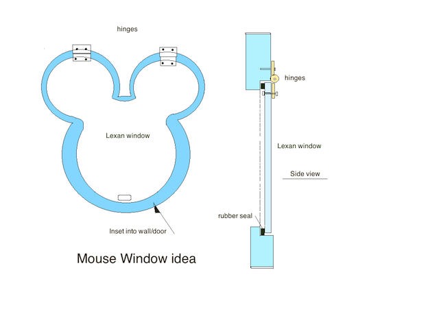

OK, how about this ??? Image

oh i like this (of course!) :lol:
i will have to work on hubby to help me though. hmmm wanna help chip in for 500lbs of beer. :lol:

Thinking this window would be easy to do as the Lexan piece (mousy head) IS the whole window ... the cutout and ledge , sealing , hinging is just more of the same .... Cutting the Lexan isn’t too difficult with a jig saw on SLOW , and the right blade , and then , there’s the finishing of the edges , sanding and polishing.... The shape isn’t really “criticalâ€

... and oh yes , we’d have to reinforce the wall/ door with some hard points for hinge attachments ... could be as simple as a few 1/2â€
