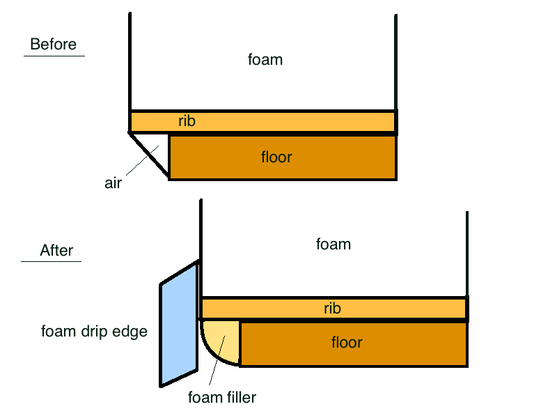

Postby GPW » Thu Dec 11, 2014 7:21 am
Thanks Dale .... we’ll have to clean it up put a fan inside and dry it out thoroughly , then paint on some of the “Mix” , and then more interior paint .. Outside gets filled (spray foam) sealed and re covered with an additional canvas strip over the outside ( a “patch” ) ... Thinking of adding a "drip edge" made of foam around the front , since the one over the rear door worked so well ... With our constant Humidity and wet climate , we have to do everything we can to prevent water getting in ... especially for something that must live outside ... :thinking:
Another drawing .... cross section of the front where the leak occurred ... and the fix ...

Sorry to hear this .... water is like rust, insidious and never sleeps .
Where exactly did the leak occur in the before picture ?
Did all of the unsupported painted canvas rot ?

Tac, the little dark spot is where the water wicked in... and yes , unsupported (painted on one side only) canvas rotted quickly exposed to air and water ... :frightened:
Something to be aware of in the future ... canvas must completely Contact the structure ... or be waterproofed after attachment (the mix ) ... no air gaps , no matter how small ... Lesson Learned !!! :roll:

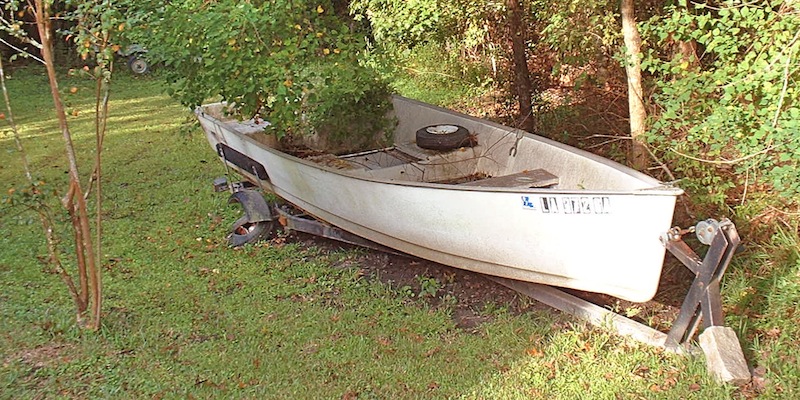

Today , an old friend of mine (Capn’ Mike) is coming over to finally get the boat :o (the wife is Ecstatic !!! :woohoo: ) Spent most of yesterday afternoon cleaning all the leaves and compost out the boat ... what a mess , but it came clean with much shoveling and hosing .... :phew:
Best of all , he’s bringing his own trailer , which means I still have the current trailer to fool with ... that’s beside the one I have in the backyard too ;) .. Spring is going to be a Busy time ...trailer building :dancing

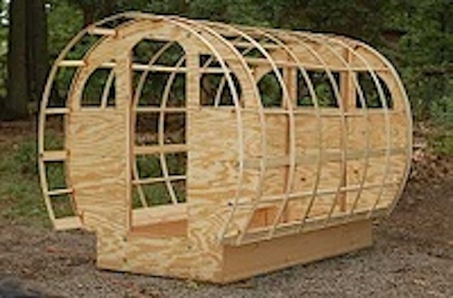

You know ... thinking if we used the circular ribs and just stopped it where it was the trailer width , we could have a wide camper on a regular trailer ...like the one shown in this picture below ... We have the round ribs for the top , but on the FS transitioned to the vertical instead of continuing on around .. :thinking:
beercan .jpg (157.1 KiB) Viewed 1434 times

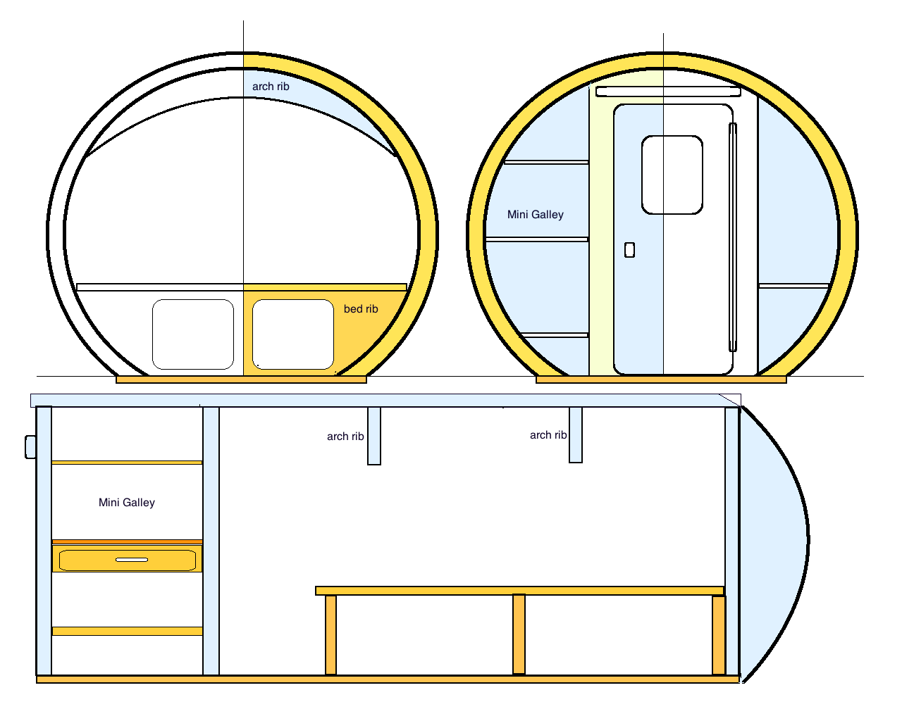

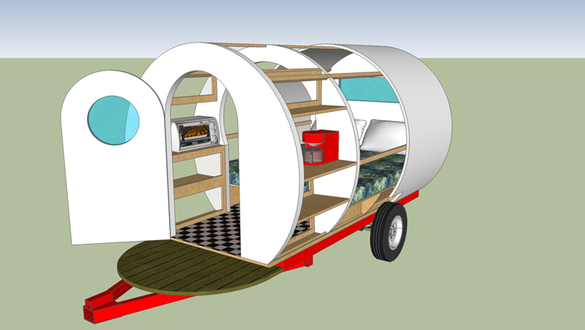

Postby GPW » Tue Dec 16, 2014 9:25 am
Sorry , I can’t resist the urge to make an exploratory drawing of the subject ... 6’ wide camper on a 4’ trailer bed sure is interesting ... :thinking:
Beer can camper.png (28.3 KiB) Viewed 1896 times
