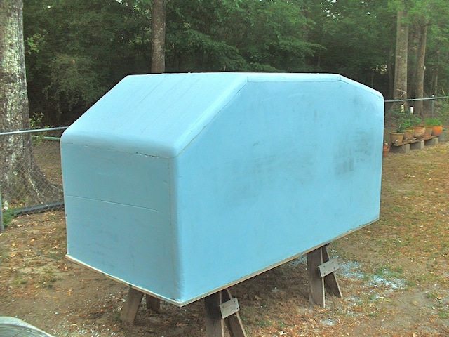

Bonnie , nothing special ... belt sander with 36 grit belt , old coarse wood rasp , and a cheap sanding block, 80 grit , palm sander ...
Here’s what I started with ... Image
Roughed out with the belt sander Image
Finished sanding overall with a cheap electric palm sander with 80grit ... Image
One thing that I would have found Handy would be a long board with a sanding belt glued flat to it , just an extra long sanding block ...
Gotta’ be Careful if you use a belt Sander , it Eats foam very quickly , too quickly ... light pressure and keep it moving seems to work best ... the wood rasp worked for the initial rounding , was much safer and predictable , but just a Lot of sweaty work ... it was a Hot summer so we wanted to get it done as quickly as possible ... belt sander ...
Postby GPW » Sat Oct 29, 2011 9:03 am
BTW, The sanding can make a real difference in the finished appearance... the Better you sand it , the smoother it will be ... My sanding wasn’t the best and I can see minor imperfections under the canvas telegraphed to the surface ... :oops: Just like a good paint job really , the prep is Everything !!!... :thumbsup:
Thinking back now , I could have gone to 220-320 grit and had a much Smoother surface ... :thinking: I will do that on the Next one ... :thumbsup:
