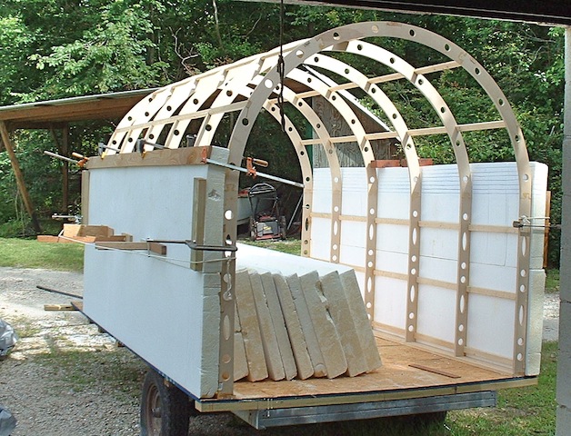

Are there intended to be FS style plywood ribs (hull frames in submarine parlance) imbedded in the foam? If so, the extra arch ribs seem redundant to me. Even w/o imbedded ribs, with fabric skin in and out they may still be redundant (and kill head room).
Now just one question, where are you going to get a block of foam large enough, and how will you fish the hot wire thru the length in order to "core bore" the middle out? :lol: :lol: :lol: :R
Re: FoamStream...
Postby GPW » Tue Dec 16, 2014 6:02 pm
KC, I guess we were thinking about FS style ply ribs , which would eliminate the need for the arches ... It was just an exploratory drawing , nothing chiseled in foam ... :lol:

GPW it was a slow night at the new job last evening & I was re-reading this project. I didn't realize how much the FS design influenced my own plan. The foam over skeleton approach for my trailer is the only way I can see to get the strength I need.
Ned B
Posts: 1036
Location: Syracuse NY (ish)
Re: FoamStream...
Postby GPW » Thu Jan 15, 2015 1:11 pm
Ned , we were just following old aircraft fuselage building techniques... formers and stringers .. Having a solid framework made putting the foam on easy , and all the lightening holes in the rib-formers made wire running and hook attaching various things so very easy to many places ... Handy in ways yet undiscovered. :thinking: Without the framework , i’d have had to glue the foam blocks carefully , and glue in “hard points" for various attachments, lanterns, nets , etc. The frame by itself was easy for me to pick up and move around (once balanced) so didn’t contribute much weight to the cabin. Guessing ~ 40 lbs.
Your frame looks Great !!! Can’t wait to see it go together!!! :thumbsup: 8) I know you’re going to like the results , especially towing.... ;)
I might suggest before final assembly of the framework , you give all the wood a good soaking of ... “the Mix” ... I should have done that , but didn’t .. and wish I had ... :roll:

GPW, re the mix. I can see the sill plate getting that treatment, but the rest? Id rather use cypress for the bottom 1/3, then poplar or ash above. For that matter I could just use ash throughout. Cheap, easy to get up here & really strong for the weight.
Ned B
Posts: 1036
Re: FoamStream...
Postby GPW » Thu Jan 15, 2015 9:28 pm
Ned, excuse my caution , but it rains a lot here and I think why take a chance ... ? Easy enough to really protect all the wood , just in case... Having seen how one little leak can spread all over the place , I'd sleep better knowing I'd treated the wood ... We've seen so many things (especially RV's ) just totally ruined by one little leak and no waterproofing... :frightened:

GPW, yeah, you're in the tropics, I forget that. We get our fair share of moisture as well, though ours is a lot colder than yours most of the time. :roll: I guess the mix isn't that costly, but it might affect the look of the wood. As you say, I'm a woodworker. If I weren't going for ultra light weight, I'd be building a woodie in a heartbeat just for the aesthetics.
That being said, I may still find a way to have a decent amount of wood 'features'... frame, a couple of small cabinets, face frames around the doors, and the galley.

Just a little reminder about the mix ... Buy the CHEAPEST polyurethane varnish you can find (not water based) ,and buy Paint thinner not Mineral spirits :o .... For some reason the "paint thinner" is ~$4 a gal. (ingredients marked on the label as 100% Mineral spirits) ... The container marked "Mineral Spirits" is $9 a gal ... :roll: I don’t know why , but the cheap stuff is the same thing and works fine for the Mix.. And once you mix a batch , you can use it on anything wood . We’ve used it on many projects now (including campers) and with great results .. best thing is , it really doesn’t discolor the wood that much ... OR you can add an oil pigment to it for various staining shades of color ... if wanted . :thinking: It stores well too , and won’t go bad in the can ... lasts for years and years , when sealed ...
The way to tell if you’ve applied enough is when it no longer sinks into the wood and becomes shiny on the surface... all wood is different , some soaks it up , harder woods just get shiny quickly. Best pay special attention to the End grains... The open end of the “tubes" in wood. That’s where most of the water gets in . Capillary action then takes over and the water migrates down the tubes and into the wood. Block those ends and water absorption (and subsequent ROT) slows waaaay down ... ;)
