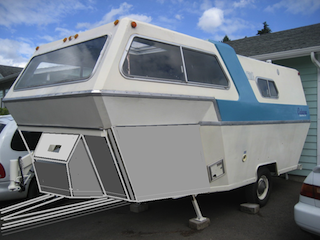

http://smalltrailerenthusiast.com/2014/ ... ly-cabana/
Showed this to Lori she liked the layout... So back to the 'Big' trailer
Ned B
Posts: 1036
Location: Syracuse NY (ish)
Re: Hybrid Foamie: Wild Wanderer in Foam-now with sketches
Postby GPW » Sat Jan 17, 2015 1:06 pm
Ned , I could see that with a roomier front end ... it would be Huge inside ... like a Land Yacht with those windows , yet could be built lightly (but still Very Strong) ... :thumbsup: 8) :applause: :beer:

Looking at that camper (above) , does it look like the front is a camper top from a pickup ? (that would be easy ) And the back part (hatch) above the “blue" would lift up to make the taller standing area... :thinking:

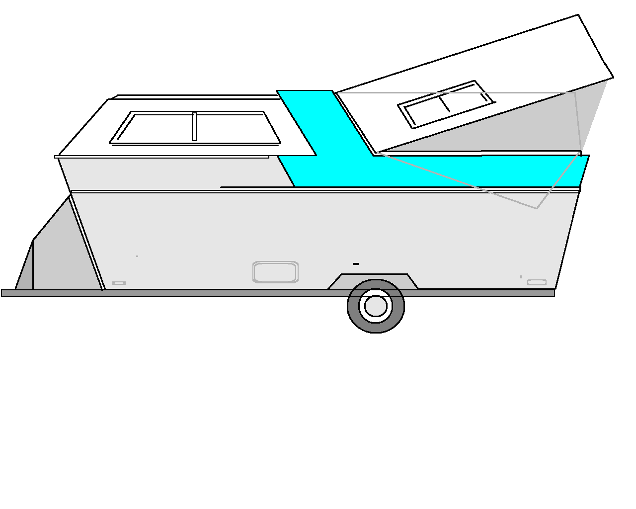

the front of that little 5'er does look a lot like a pickup topper doesn't it? Lori asked about that in fact. I dunno... while I like that wrap around window effect, I'll have to find a different solution.
As for the pop up section, there's that whole lifting mechanism thing on a popup. This is a foamie after all... thrifty and simple are the buzzwords. Some really smart guy down in cajun country may have said that originally... :lol: I'm still leaning towards a queen bed in the nose, with a lifting roof section in the tail for a 'standie' section. One of the things Lori liked was the walk through galley/cabinet area, plus the bed in the nose, essentially what I had drawn up already, only the 5er you had to climb up into the bed. My 5'er which looked something like this:
had the same configuration, I always found it to be fairly cozy, but evidently she didn't like it as much. I'm going to try and keep the 'sight lines' as open as possible... little or no rear wall behind the mattress area so when in bed before she goes to sleep she'll be able to see all the way to the tail of the trailer. Me, I'd be fine with a traditional sized cabin, with the galley in the back.
So I'm back to this sketch:
the lift up section would be fairly light weight even with the frame, the rear door and upper wall would tilt inward at the break point, and in transit the upper section would keep it all sealed.I'll build a triangular screened section to fill in the gap when the roof is up, with canvas or some other cover in case it is raining. In transit they would fit into brackets in the roof section.

Postby GPW » Mon Jan 19, 2015 4:59 pm
So it’s going to be a BIG trailer ... :o Tall in the back ... ;)
