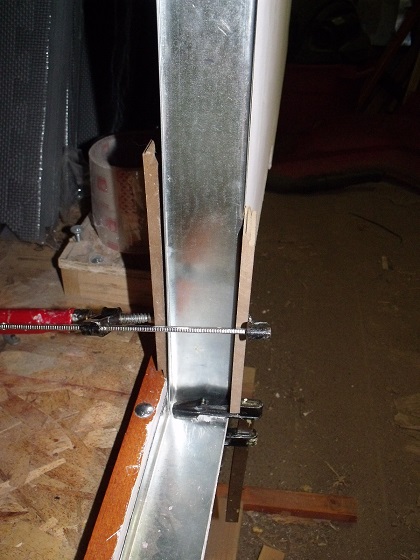

Postby ghcoe » Sat Jul 05, 2014 4:44 pm
Been working on the door framing some this weekend between keeping cool too.
I am working with 1x2 flashing and some drywall beading to make a door frame. I started a thread on how to work with flashing and beading here, viewtopic.php?f=55&t=60303 .
Pictures of how the frame goes together. Not seen well is that there is another 1x2 piece of flashing on the inside.

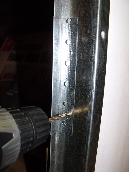

Postby ghcoe » Sat Jul 05, 2014 4:48 pm

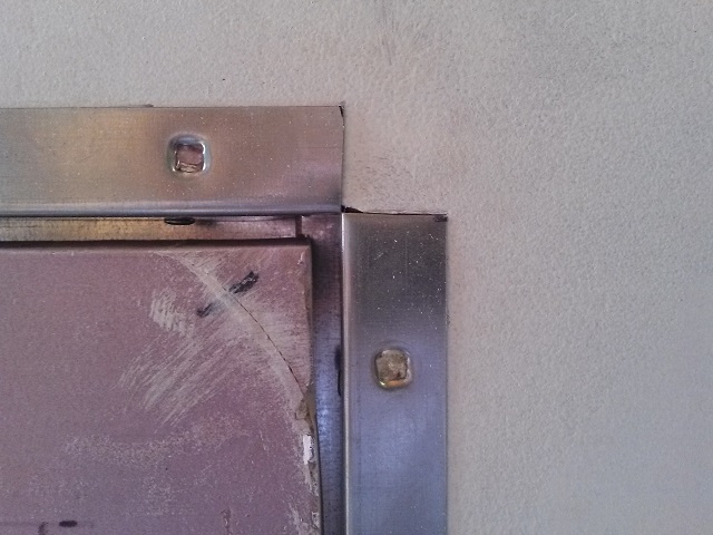

Next I had to make it all one piece.

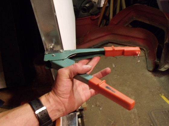

First clamp, then drill, then pop rivet. Makes for a nice strong channel with a built in edge for the weather stripping to attach to. I used a piece of scrap beading for a drill template.
Clamp
DSCF3171 small.jpg (130.1 KiB) Viewed 1970 times
drill
DSCF3176 small.jpg (116.2 KiB) Viewed 1970 times
Pop rivet
DSCF3177 small.jpg (92.48 KiB) Viewed 1970 times

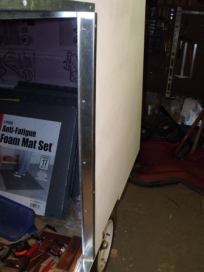

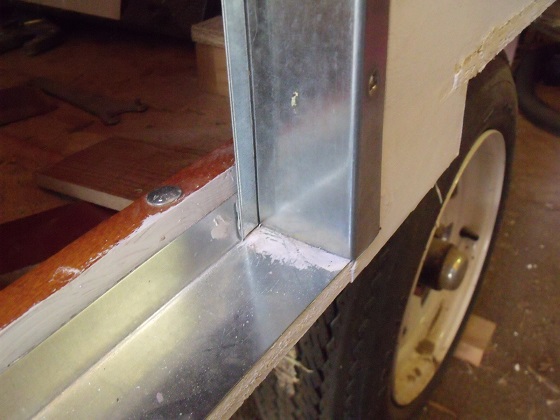

Finished with the first side.
Finished side
DSCF3179 small.jpg (120.26 KiB) Viewed 1992 times

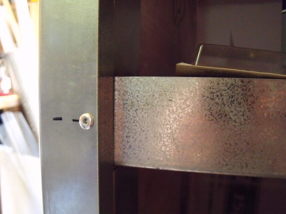

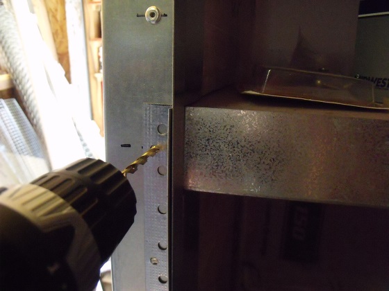

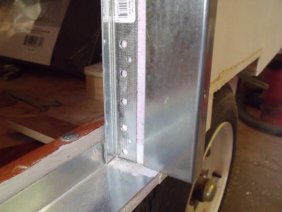

After installing the door frame I attached the forward shelf to the door frame.
Drilling rivet hole
DSCF3188 small.jpg (89.94 KiB) Viewed 1992 times
Shelf attached
DSCF3190 small.jpg (93.17 KiB) Viewed 1992 times
The shelf was not glued in yet. I was waiting for this time so I could attach it to the door frame and then glue it in so that it was even all the way across to the other door once installed.

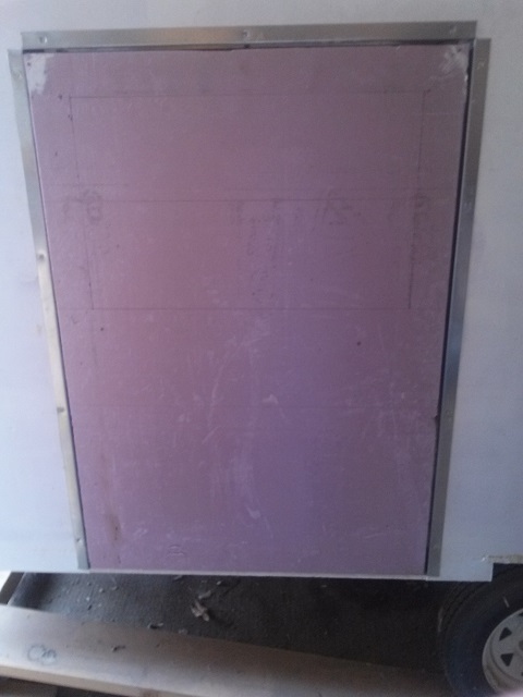

Postby ghcoe » Fri Nov 28, 2014 8:00 pm
Weather actually was quite pleasant today so I was able to go out and do a bit of work on the trailer. Started to fit a door. Some cutting and sanding and I got it to fit.
Door
CAM00631 s.jpg (75.52 KiB) Viewed 1645 times
Hope that a 1/4 inch gap will be enough clearance. It will be about a 1/8 inch clearance once the door is hung.

Postby pchast » Fri Nov 28, 2014 10:14 pm
You may be tight with only a 1//4 inch, Depends on the skin.
I experimented and still am a little too tight on ours...
pchast
Posts: 2065
Images: 97
Location: Athens, NY
Re: #1
Postby ghcoe » Sun Nov 30, 2014 8:57 am
Yeah, I was thinking of opening it up another 1/8. I figured that would make up the difference of the flashing and canvas that still needs to go around the outer edge of the door. Not to mention the hinges will take up some room too. I guess that makes up my mind for me, thanks.
