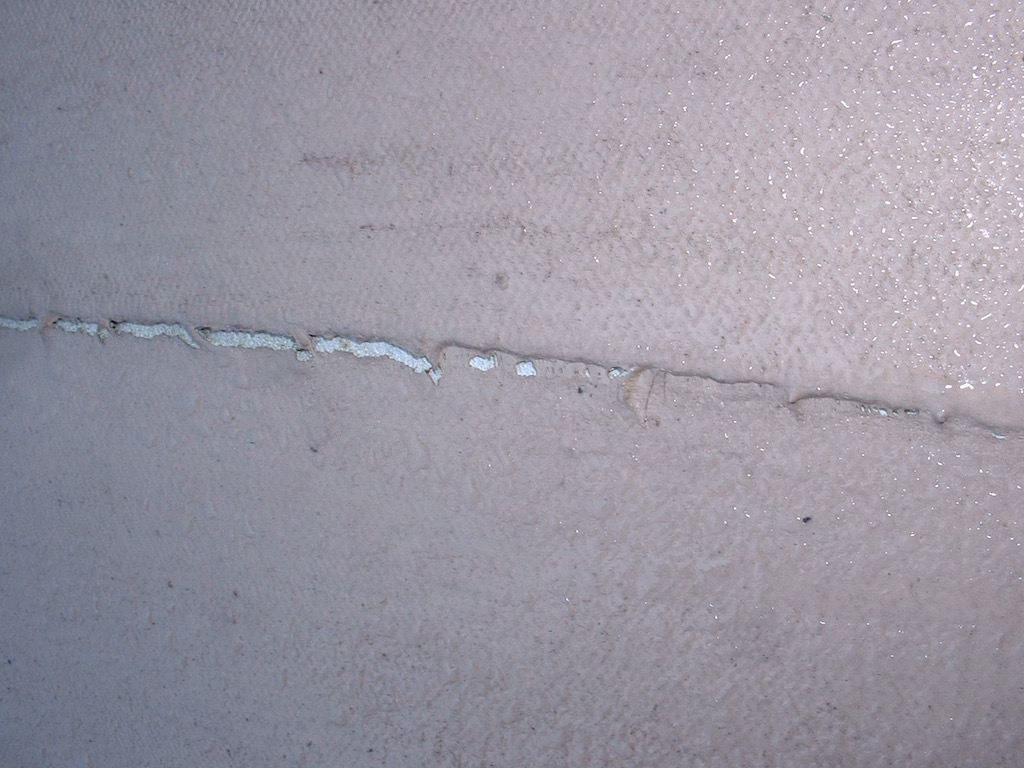

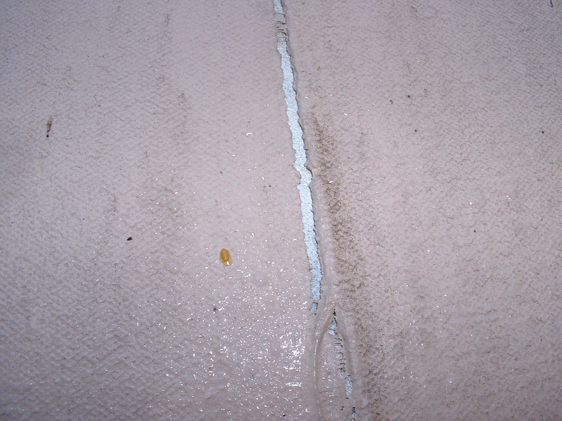

Curious , I was going over the FS looking for any skin problems , and there were none (no bubbles) although we knew of one for sure that we had looked after ... now vanished :roll: ... But I could see where certain seams had opened up due to shrinking of the material ... OVER TIME !!! :o The measured shrinkage was 1/16” , which over the length of 13’+ could be quite substantial for “After the fact” shrinkage ... That explains why Foamies “tighten up" after a while ... further proving the “sock“ theory ... :thinking:
Re: FoamStream...
Postby GPW » Sat Sep 19, 2015 9:12 am
We wanted to show how the fabric skin shrinks over time and exposure ... These close up pics are ~ 1/16” exposed primer where the seams pulled apart from shrinking :frightened: .... only two we found and on the nose . :roll: We’ll fix those before the intense FS washing/Fall cleaning coming up , likely tomorrow ... 8) :D
note: seams with generous overlap did Not show any signs of separation.. :thumbsup: and another good reason for the reinforcing strips underneath ... :thinking:
