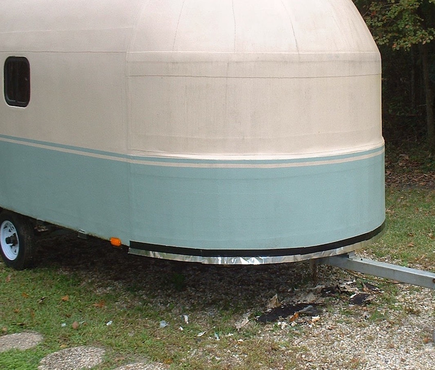

OSB , yes , I would just do a better job of coating it with the mix .... I had thought the glue and paint would do the job , but it’s just so darn wet around here , water manages to find it’s way into Everything .... :frightened: I blame myself for not think it out and adding a drip edge to divert the water away from the bottom... Hey, nobody’s PERFEKT!!! :lol:

OK, just when I thought we’d have a patch of dry weather , well NO :rainy: ... So I put on the temporary drip edge in the hopes it will allow the bottom to dry out naturally , till I can either stick a fan on it or find a garage space (with a big door) to work on it in a dry state ... This will be a test of the supposedly superior Gorilla Tape , it does seem tough and sticky , I overlapped it onto some Aluminum duct tape , and stuck it over the suspect areas.... Then went back and rubbed it down really well, just to make sure .... The aluminum protruded about an inch under the floor level so all water “should" just keep on going straight to the ground avoiding the floor entirely ... another test ... :thinking: You can see all the old wetted canvas we pulled off the bottom (on the ground) ... The back flat areas are already drying on their own , but a few are not as yet ...

Checked this morning and the rudimentary drip edge was working , water running all the way down the face and off into the ground , the floor underneath was much drier ... It’s a start ... :o

Checked yesterday after a slight rain, and the wood protected by the temporary drip edge is getting Dry , all by itself ... :thumbsup: :D

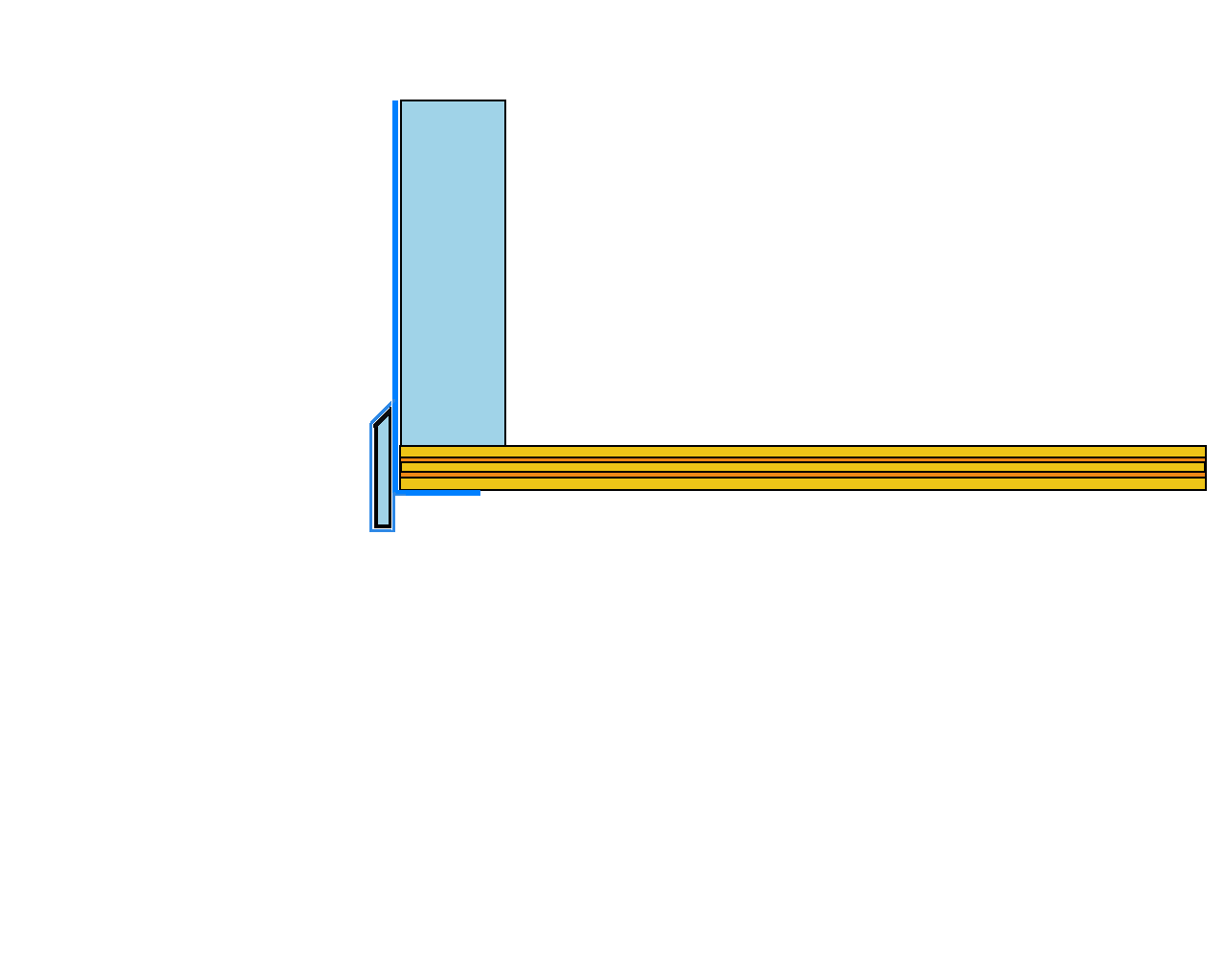

If this works , we’ll put it all around the FS In a more permanent material of course ... I have some 1/4” Blucor FFF (fan fold foam) That may work with a simple light canvas (or sheet) covering ... Glued on , thoroughly painted ... we only need a little bit to do the job ... Maybe a 1/2” under hanging the actual trailer floor ... :thinking:

The temporary drip edge is working perfectly... after the weekend’s deluge Thanks to Patricia, the bottom of the floor is almost bone dry now ... :thumbsup:
