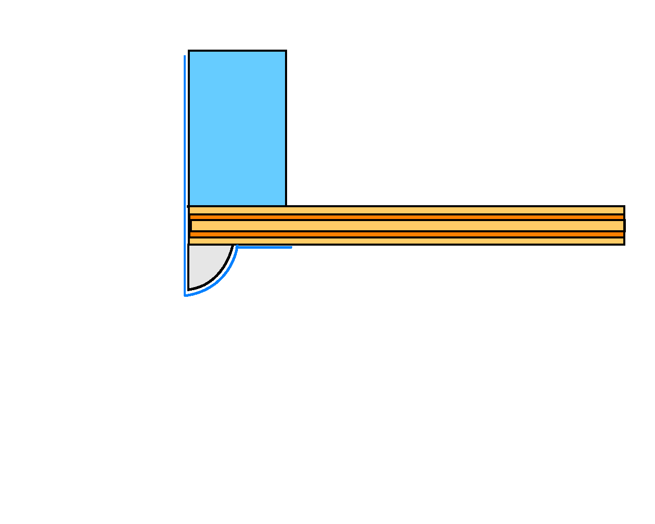

Turtle , I was thinking about using strips of chipboard coated with the mix and then glued to the canvas as a “filler” ... The thing is , you don’t really need much of an edge as water doesn’t run uphill ... And then we thought of using Eternabond tape ... (easy )
Now I’m thinking of incorporating the drip edge into the floor , so when you wrap the canvas underneath , it forms the edge we need .... Thinking of using something like a common quarter round moulding ( they might even make it in a dense foam .) just initially attached to the floor, covered over and that’s that ... :thinking:

That sharp corner looks like it would be trouble with any kind of fabric you might choose to use. Maybe.

Yes, Thanks KC , might have to give a little bit of round-over... :thinking: Even with a simple Foamie there are the “details” ... and with this “learn as we go plan" , the better changes will likely reflect on the next build ... which we are already gathering for now ... :D
This probably isn’t necessary for someone who lives in a dry climate , but here’ it’s raining all the time ... and this is stored Outside still ... Two years now , and it’s certainly paid for itself already with “peace of mind” for the wife and I ... even the temporary drip edge has worked extremely well, so we know the principle is sound ... :thinking:

I like that quarter round molding detail. It looks nice, and I might try it. What are you thinking about waterproofing it? Just the same TB II, gesso, paint layers as the cloth?
KC, I suspect that it wouldn't be too sharp at all. I've glued fabric on all kinds of stuff even over the edges of old tin cans and it holds up really well. And this molding edge would be much duller. But we need a willing test subject to try it!

I’m now thinking the “sizing” ( thinned TB2) of the canvas is a very important step to assure complete waterproofing . Basically it’s like “the Mix” but for canvas ... allowing all the fibers to be saturated with glue ... For me it was the unsized fibers that held water later ... I really think with the drip edge installed , you won’t have to do much of anything as water will not get onto those areas , not from rain anyway .... Water splashed up from the road , that’s another story ... :o But on my all steel cargo trailer , the board floor is just raw wood underneath and looks in fine shape ... Curious ! :thinking:

Drip edge still in the plan , was thinking about something like this ... http://www.homedepot.com/p/Royal-Mouldi ... /100080367 ( certainly thrifty enough :thumbsup: ) With PVC I can heat it and bend it to fit exact under the nose ...
Think I could glue it with that 3M marine sealer (still have some left over) and shoot it into the floor with a small brad gun to hold it while the glue cures... Then a quick wrap of canvas over that on the outside and wrapped under and call it done ... Thinking this is cheap enough to do and we might as well do the whole trailer , drip edge everywhere... :beer:
