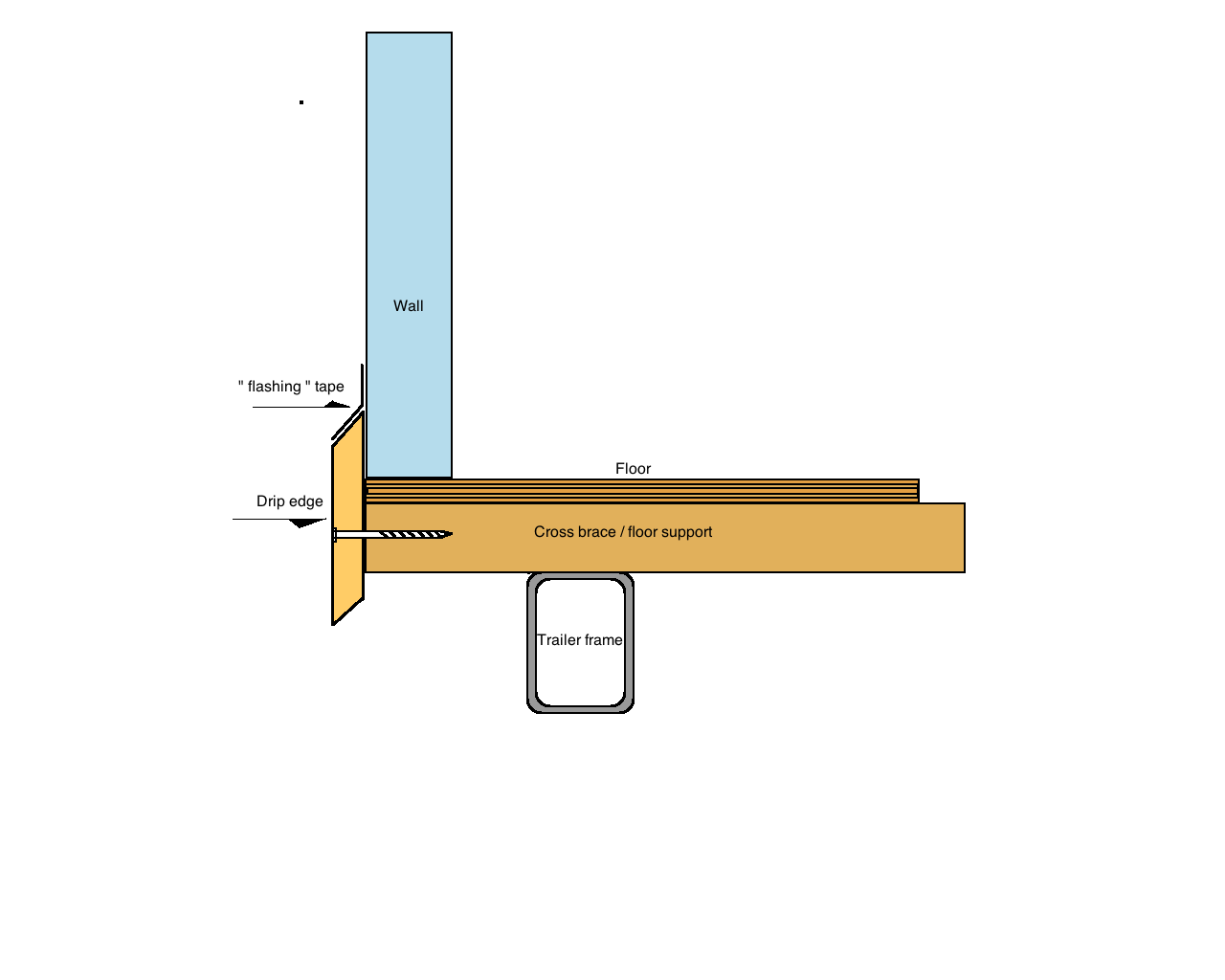

Postby GPW » Mon Mar 07, 2016 7:22 am
With weather steadily improving , we’re planning on starting the “ Spring Trailer cleaning “ (easy :D ) and install that drip edge ... Here’s the latest idea as it applies to my current situation ... ( see drawing) , and if anybody can think of something better please let me know... :thinking:
The other picture shows the several attachment points along the bottom .... the ends of the floor braces ...

Postby GPW » Tue Mar 08, 2016 11:47 am
I sent my buddy Vinnie the picture of the drip edge ... His guitar company is right near a great old school lumberyard ... and they have the nicest wood ... :thumbsup: You go in , take a number , get some coffee, have a seat , then you go sit down at a desk and tell the old guy what you want ... He then leads you to the stack of what you want and one of the employees pulls the wood for you , and if you don’t lke that, he’ll pull some more till you find the boards you want ... Then you pull your truck around and they load it for you ... Best of all, it’s Cheaper than the Home Depot or Loews and it’s Much better wood ... :o We’ve settled on the idea of a "clear and dry” ( no knots ,no slime ) PT wood for the drip edge ... no problems putting it outside ... Now all I have to do is bring it to Vinnies place and cut it on his big table saw.. 8) ... The last question is what sealant, caulk, rubber, whatever to use between the drip edge board and the FS wall (canvas) ??? We plan to install a canvas flashing over that .. Applied to the FS using canvas repair principles , (Glue , then paint) ... That’s the plan ...

Postby GPW » Tue Mar 08, 2016 12:02 pm
Or what about the idea of not “sealing “ the drip edge board to the sidewall at all , just using the large screws holding it attached , then maybe take a leaf from KC’s book and use some fiberglass tape over the top for the “flashing “ (instead of plain canvas) ... TB2 would stick it fine , and it wouldn’t tear with any unexpected expansion , as we’ve seen on rare occasions ... :thinking: You guys have any ideas ???
