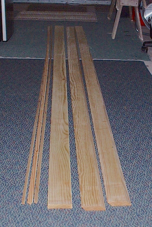

Postby GPW » Thu Mar 31, 2016 5:07 pm
Got my boards for the drip edge today ... 1” X 4” X 10’ PT Pine Clear and dry ...less than $20.00 for all three NICE !!! also got the edges trimmed at the Guitar Company a few blocks away ... Going to prime and paint them before installing ... Coming along now .... :thumbsup: ( Just in time for Spring monsoon season .. April Showers ... :frightened:  )
  Ps, I bought three boards just in case something went wrong ... only cut two ... Safety Man ... that and it’s 18 mi to the Lumberyard ... :o

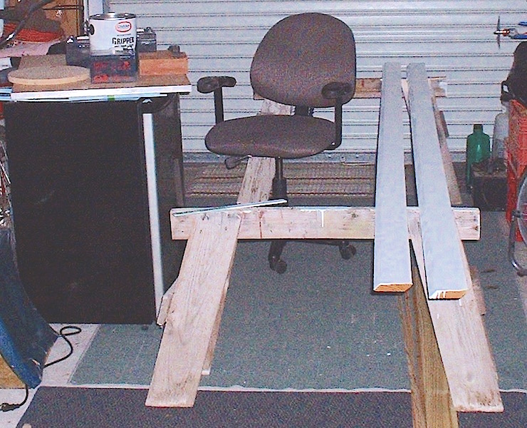

Postby GPW » Fri Apr 01, 2016 7:43 am
And of course , today it’s raining ... AGAIN ... :rainy: So today we’ll set up the horses in the Studio, put some paper down and prime the heck out of the boards with some Glidden Gripper .... We’ve had great luck using this particular wood outside , so anticipate no long term problems with the material , and we will give then a proper paint job , and caulk the attachment holes too ... Do it now and we won’t have to do it later ... hopefully ... :thinking:

Postby GPW » Sat Apr 02, 2016 7:04 am
The priming ... and also some laminating of foam parts (airplane parts) with the Gripper ( left, under the can ) ... Now to make some canvas tape ... :thinking:

Postby GPW » Fri Apr 08, 2016 6:34 am
Now let’s talk about that drip edge ... Primed , but I’ve had to sand out some runs ( my bad ) ... then re-prime and then put on several coats of exterior paint ... I had to let the Gripper dry THOROUGHLY as it’s rubbery if fresh, no fun to sand ... Trying to no a nice job , so I only have to do it once ... :roll:
Less than 2 months till the start of Hurricane season .... With the crazy weather extremes lately we do want to be ready to leave if necessary ... ;)
