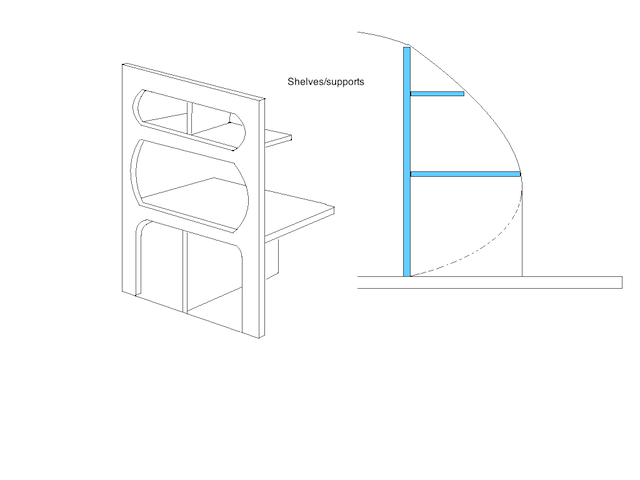

Maybe we should start working on some Foamie' cabinets and shelves that brace the shell ... from the inside ... :thinking: we know the arches work for the roof /walls , but the thought of a nice utilitarian interior that also supports the shell is enticing !!!
Postby GPW » Tue May 17, 2011 12:50 pm
Here's just an idea ... Image
Postby Ratkity » Tue May 17, 2011 1:25 pm
GPW wrote:Here's just an idea ... Image
I certainly like the opening you have made and the utility of it.
I think you'll have more support if you put sides (left and right against the wall) on the lower half of the shelving unit. These can gorilla glued to the wall. "L" brackets supporting the face and center vertical structures to the wood floor would eliminate the need to find an attachment point for the upper structure - but still make it very sturdy.

Postby stomperxj » Tue May 17, 2011 2:19 pm
I like the radiused corners on all openings, especially structural stuff. Less prone to cracks like the square corner openings

Postby eaglesdare » Tue May 17, 2011 2:41 pm
gpw, i like your selving, and i think it would work.
but i am still thinking on this. i might try putting something together on my photo program.
