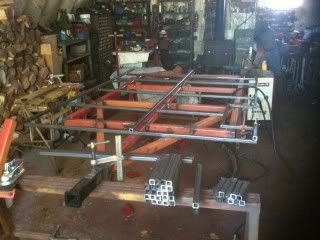

So swung out to the metal supply on Friday and bought another 250lbs of steel! 8-o
Enough to build the floor framing as well as the Diamond Plate "skirt" around the bottom 16" of the trailer. They didn't have the thickness I wanted, but they gave me 1/8 for the same price. This thing is going to be sturdy!
Got all the pieces cut yesterday and the floor frame tacked up (upside down in this pic):

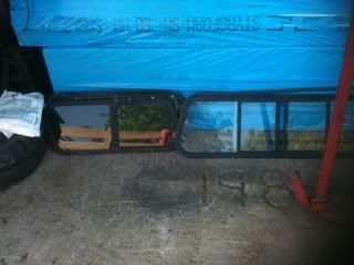

Also got some free windows from a truck cap at the dump!
Now just need to weld in the risers for the floor, weld up the spring mounts, and cut some axle plates and she'll be rollin'

That sure looks like it's going to be VERY STRONG !!! 8) :thumbsup:
Postby DJT » Sun Jun 19, 2011 2:21 pm
GPW wrote:That sure looks like it's going to be VERY STRONG !!! 8) :thumbsup:
Strong: yes! Light: not so much... :oops:
If I did it again, I would use the 1x1 for the whole frame, but the orange was free...
