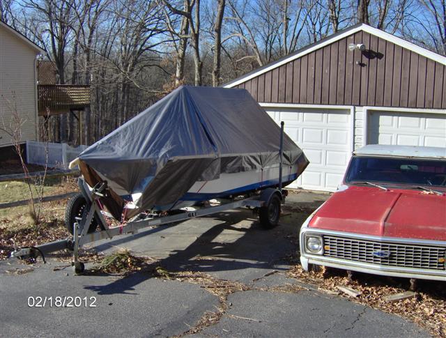

Snapped a pic of my boat cover as reference. Everything above the gunwale is temporary 2x wood frame. There is a much lower peak, underneath, that I use in the summer and can whip in and out by hand. In the winter I build up on that summer frame with an erector set of 2x3's and 4s and use a larger/heavier tarp.

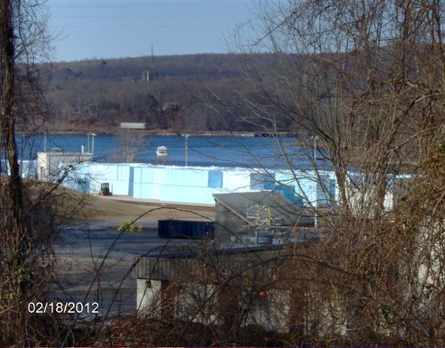

Took some pics to wow you along the way. Lot of foam.
Lots more foam; the dark square down in front at the lower left of the pile is a full size fork truck!
That's a lot of foam! Here's where they make it.

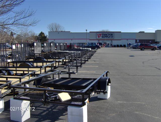

Stopped here for trailer coupler ($40) and tongue jack ($25, w/ tx $70 total, forgot to take pics of those).
Notice the white blocks? See the two trailers full further down the row? They're 1x1x1-1/2 ft blocks of beaded foam in plastic bags that the trailer maker uses to separate the stacked trailers in transport. They had a bunch of them. I asked and the cashier said that the shipper takes them back when they deliver the next load. :thinking:

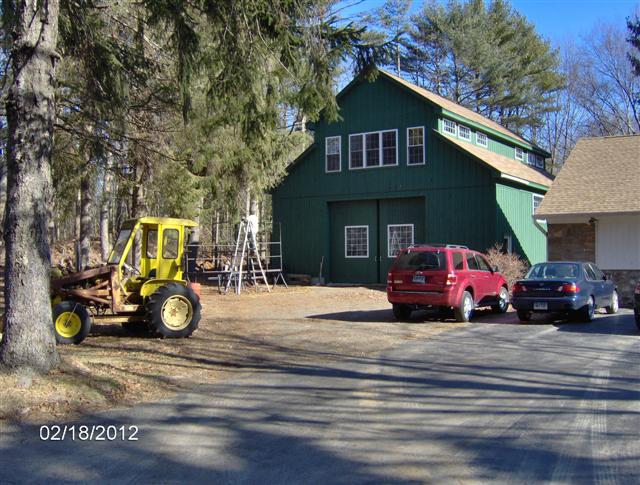

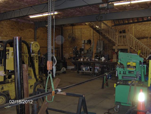

Fab Mecca, otherwise known as Metal Werks, LLC, a small custom fab shop owned and operated by Karl Hamm.
Inside Fab Mecca.
After using the powered chainfalls on overhead trollies to move some stuff in the wall rack, we lifted my steel down to where I could get to it. That's when I started looking at the plans and realized that I had bought 2 x 2 x 1/8 angle instead of the 1-1/2 x 1-1/2 that I had modeled. Doh! :duh:
Well, Karl is a true friend. He has supported and encouraged me since I started to think and talk about this project. When I was building my car hauling trailer (We interrupt your normally scheduled program for a little side trip down Kev's trailer lane...)

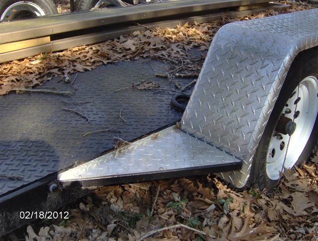

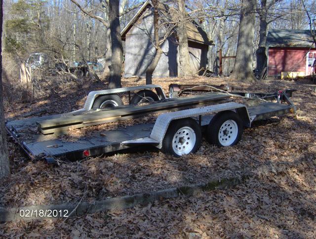

My "brand new never used home built car trailer"...slightly neglected...might use for hauling pumpkin catapult components in the future.

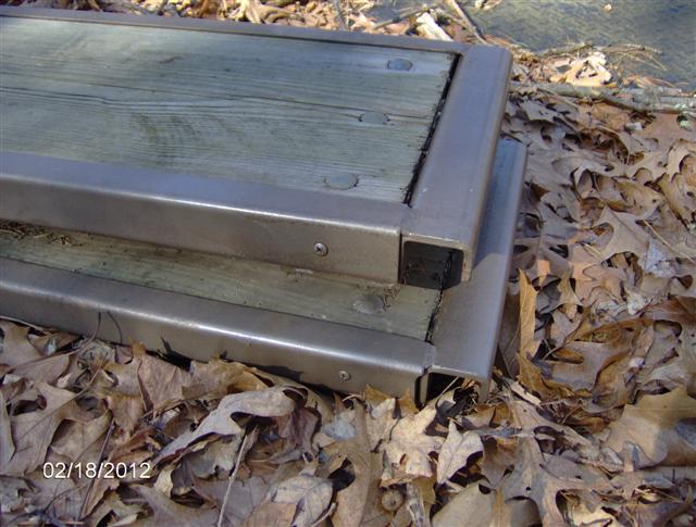

Very happy with the way I designed and built the fender mount nerf bar/side steps.
In the lead pic you can just see the cleat on the rear of the trailer. The custom formed clip on the tops of the ramps drops into the cleat and the ramps can be positioned anywhere along the back of the trailer.

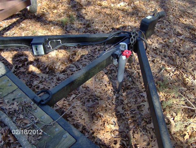

And a shot of the tongue area just to show the quality of my work (ignore the leaves, branches and mildew).

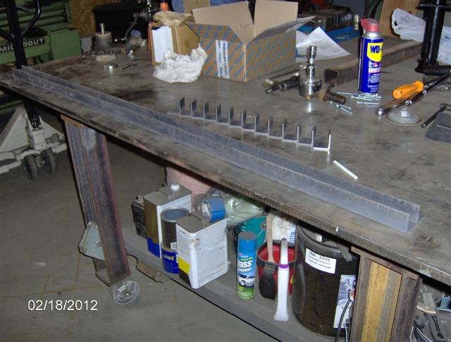

So Karl came to the rescue with 14 ft of the smaller angle out of his rack, and we swapped, my 2x2 for his 1-1/2 x 1-1/2. (I went back and edited my earlier post where I described the trailer design...nice plans, they work better when you use them! :? )
And I have a confession to make. After we ordered the steel the other day and decided to switch the rear xmbr to use the (heavier) drop from the 3/16 thk SQ TB, I started adding things up and realized that there wasn't going to be enough of that to make the 60 inch length required. :duh: Even though the tube came in 24 ft lengths instead of 20s. :duh: :duh:
Plan B was to butt weld a short length that I scrounged to one of the longer drops in order to make the 60 inches. Would take a little work to make backer bars, weld prep, drill and rosette weld in the backers, align, clamp and weld (hope that it stayed straight), etc. Nope. Karl to the rescue again. He had a long length of 2x2x1/8 in the rack that he talked me into using 5 ft of, in trade for my drop pieces. Man it is good to have friends!!!

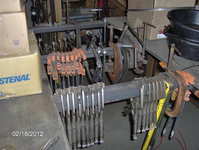

Did someone mention clamps? We got clamps.

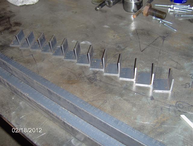

Intermediate xmbrs cut to length. (Pics out of order, mounting clips cut to length in background.)
Detail of mounting clips cut to length. (A little excited to be building? Yup. Lots of pics? Yup.)

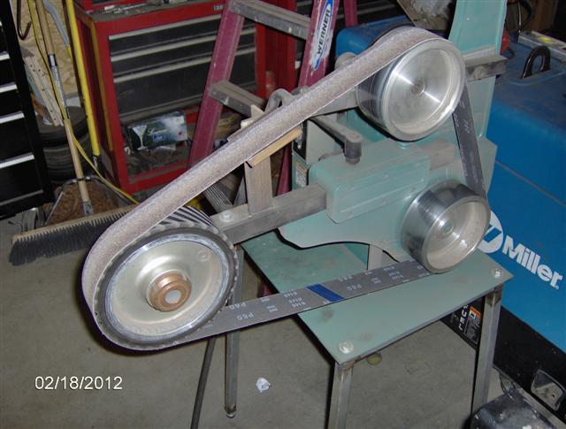

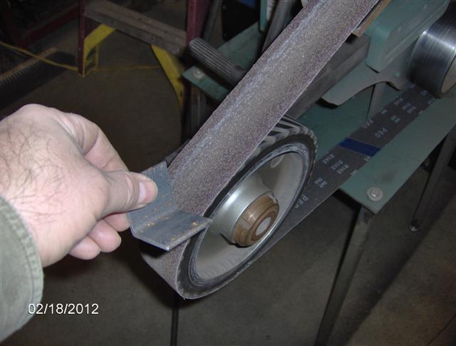

The Bader is your friend (say - Bay-der).
Deburring the clips (posed photo, you would actually be using a little further down on the wheel, and I wear gloves).

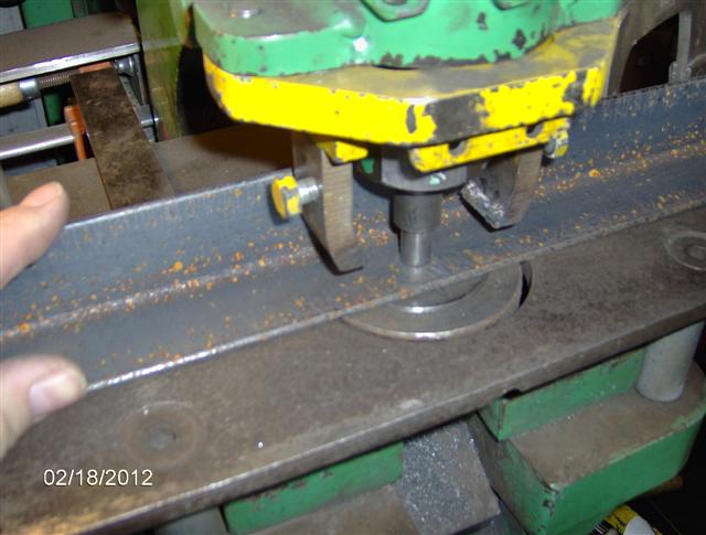

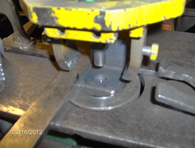

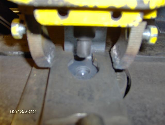

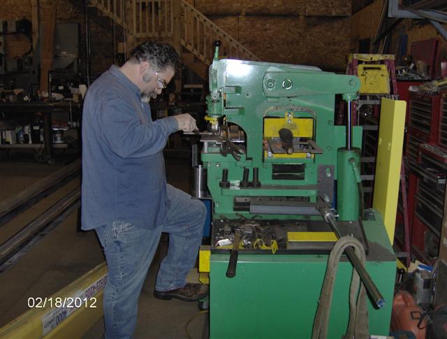

The iron worker is a Manly Tool. In a production shop time is money and drilling a bunch of holes takes time. Powerful hydraulics are faster!
Set up an alignment fixture, set the depth of travel so that the arbor does not crush the little flange of the little itty bitty piece of angle steel, step on the pedal, and Bob's your uncle, you have a hole!
A close up. Put the piece in the alignment fixture (shown), use the stripper (the horse shoe piece of flatbar w/ handle that you can see part of to the right) to hold the piece in the alignment fixture (I'm not putting my finger in there :no: :O :no: )

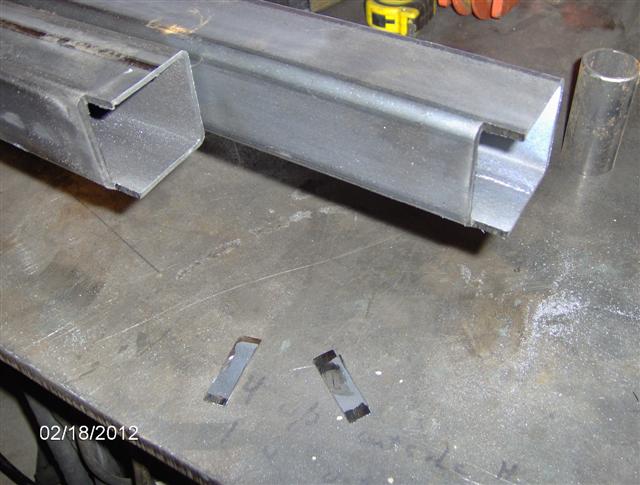

Then step on the pedal, the pleasant whirrr of the hydraulic pump and pop goes the weasel. Hold the pedal down while you position the hand held stripper (because the little itty bitty piece is too small for the standard fixed stripper), lift off the pedal and the stripper "strips" the piece off of the punch on the up stroke (shown). Takes about 5 seconds per part. Miss with the stripper and the piece gets mangled, or worse, you break a punch.

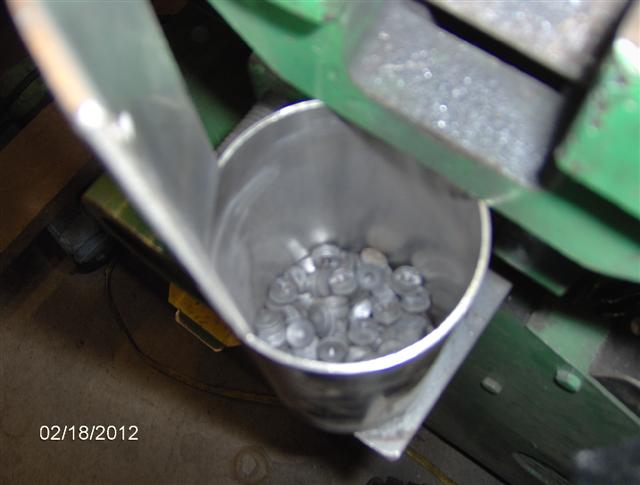

The slugs pop out into this little catch can rightcheer. These can come in quite handy if you are welding up a bunch of holes, say if you are smoothing the frame on a custom hot rod or something.

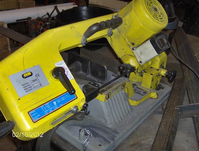

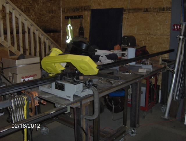

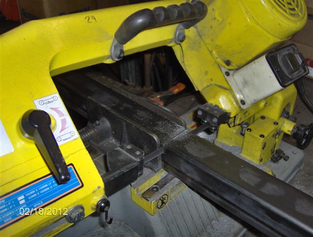

On to the main frame rails. Cutting to length. (Actually 3 cuts: first piece rough cut, second piece cut to length, 3rd square off the mushroomed end of the first piece by cutting to final length. Less moving the big pieces around that way since I had already laid the whole stick up into the saw and there was not enough run out to nip the end off first.)
Close up of the saw at work. Ho hum.
Actually, it's a very nice precision little Italian made saw (albeit a little used at this point...lots of miles under this one). Both the intermediate xmbrs and main rails (with careful attention to measuring and positioning in the saw) came out perfectly square and exactly equal to each other in length. Huzzah! :applause:

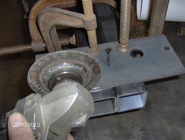

Setting up a piece of scrap to act as a guide for an abrasive plunge cut.
Posed photo of using cutoff wheel in 4 inch grinder to make plunge cut (hard to take pictures with gloves, face shield, ear muffs, sparks flying, etc.).
Yes there is no guard on that grinder. Not my tool, I am a guest, years of experience, don't try this at home. Nuff said.
The resulting plunge just through the one wall.

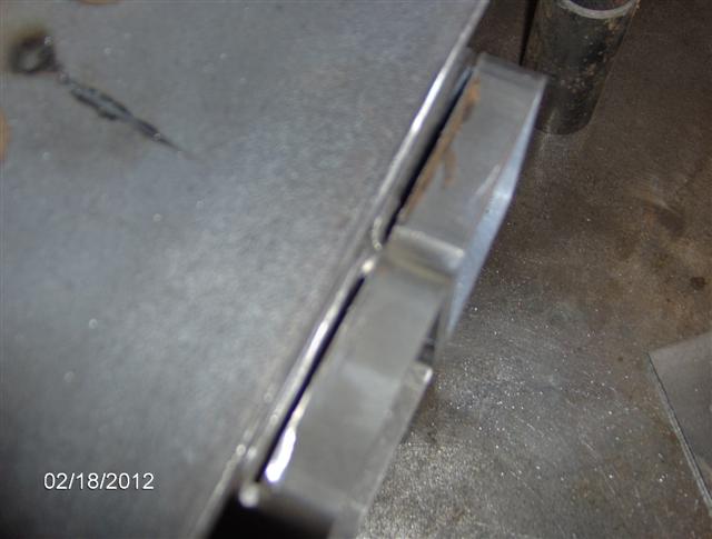

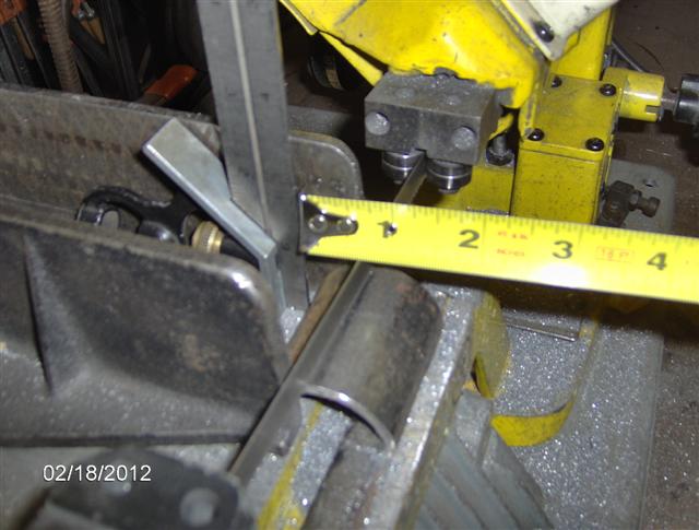

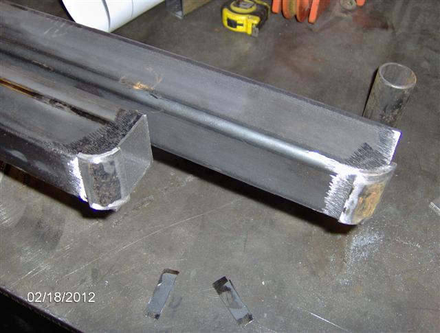

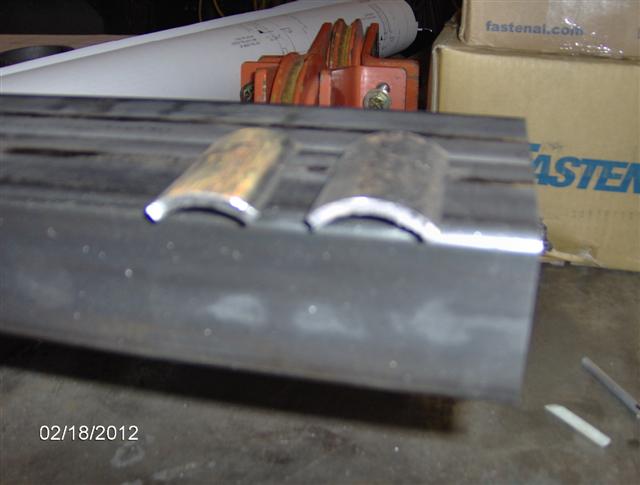

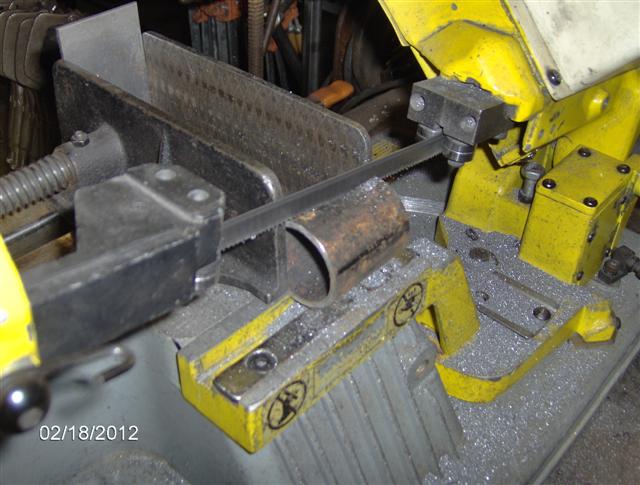

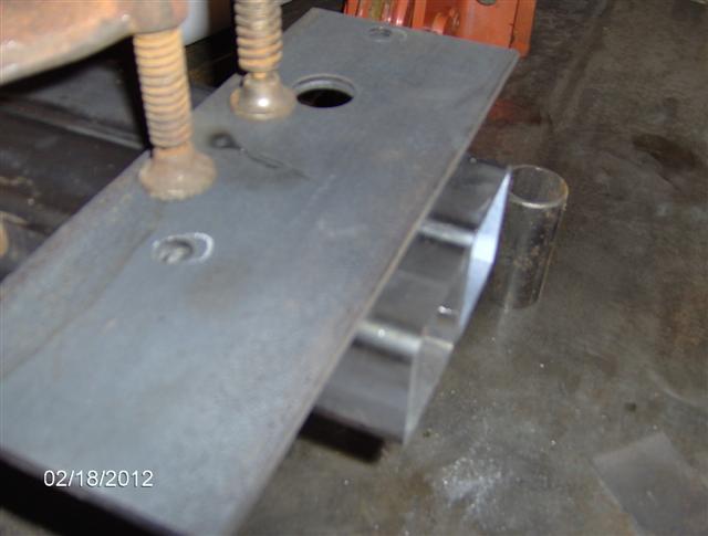

Back to the saw with a little piece of 1-1/4 nominal pipe. We didn't have any scraps of true 1-1/2 OD (3/4 radius) steel tubing so I cheated and used 1-1/4 Pipe (1-5/8 OD). Fudged it. Note the little piece of 2 inch wide sheet in the other end of the saw vise that allowed me to clamp such a small work piece off center.
Setting up the second cut using a square and tape to get 3/4 inch (checked both ends so that it would be sqaure).
Made another cut to make the drop from the second cut match the first, and here we have two little quarter round filler pieces.
Scribe the inside and grind corners round to fit flush in the recess cut on the side, and proud by the thickness of the cap (to come) on the end.

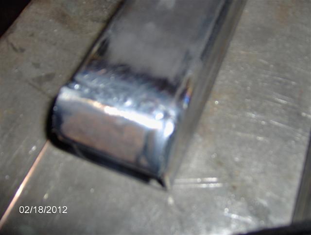

Blurry weld close up (trust me).

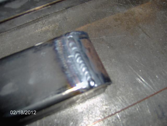

Wait for it. Wait for it... Ta dah, nice little "row of nickels" TIG weld bead. They all looked like this. :D :thumbsup: :ok: :eyebrows:
A little blending with the flap wheel and, "I'm ready for my close up, Mr. DeMille".

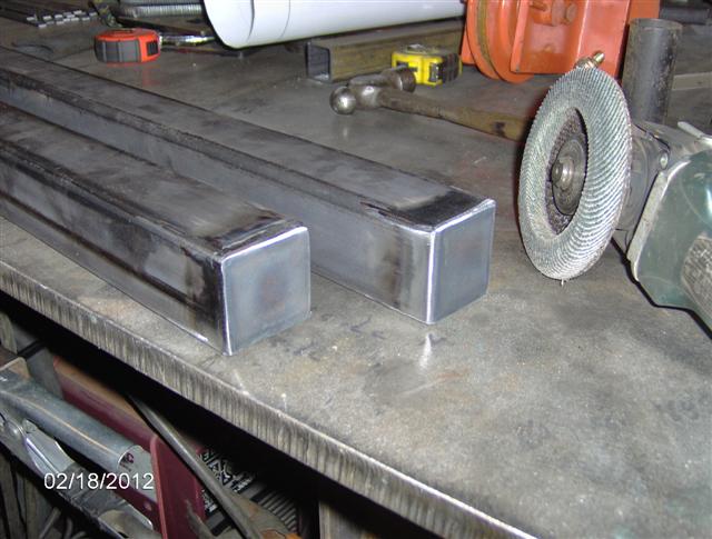

Finished up the day by capping and blending the back ends of the main rails.
