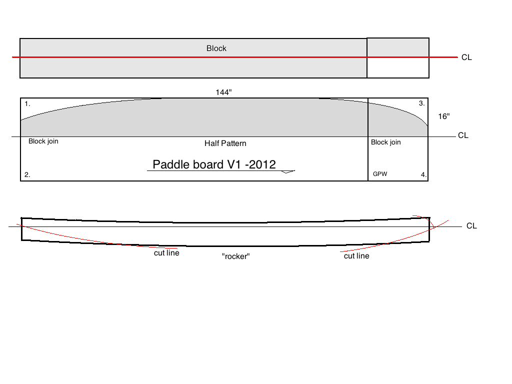

Last night we had a discussion about the PB build... The talk went from a center “board” to just using fiberglass mesh on the bottom ... under the “fabric skin” ... Some cutting templates to be made , 1/8” masonite ... more materials for them to get .
Here’s the Plan drawing ... so far ... Once the rough blank is cut out , it will be suspended from nose and rear , a small weight added in the middle and the foam gently heated to allow the blank to settle in some “rocker” ... One time we WANT the foam to warp ... :o
Part of the discussion was about using the “Grabber” for an adhesive for the foam joining ... I voted (?) against that proposition in favor of Gorilla Glue ,in which we trust ... (tested) ;)
They’re still shooting for something fancy , I’m leaning more in the direction of building an ultralight minimum structure , basically just foam and skin ... but capable of a little "dock rash “ .. The girl says she tends to bump into things .... :o :roll: :lol: :lol: :lol:
The real question is how do I get myself involved in these projects ... :?

Postby capy235 » Wed Nov 07, 2012 10:35 am
If you were to make three pieces of wood into the rocker shape you want, one of quarter inch thick redwwod, and two pieces of masonite, then use the redwood for a center stringer and the two masonite on the outside for patterns, it could all be cut with a hotwire. I think the center stringer would give you lots of strength.
