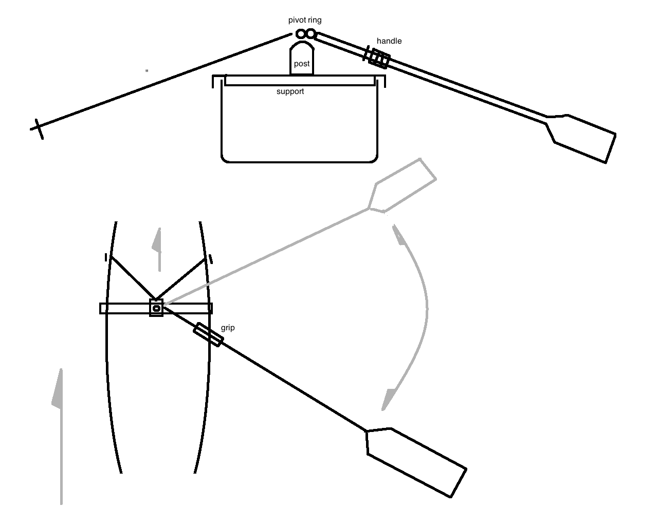

Not to be too OT ... Vinnie and I have been working on a forward rowing system for his yak'... he’s got a design with bellcranks , etc.... complicated ... I came up with this after watching some videos .... Simple ... seems like it would work eh ??? :thinking: Any thoughts from you experienced mariners ...?

Not the most technical guy. Seems it should work, I'm partial to a simple set of aluminum oars or kayak paddle.

Have you heard of Reelfoot Lake boats, also called stump jumpers? They have a forward facing oar set up. I believe they sell the mechanism separate from the boat & oars. You add your own oars. It's just standard oars cut & bolted to the rowing mechanism. My dad has one. Works very well.

No matter what forward rowing designs we look at they all seem to have the same basic geometry ... a bellcrank and lever thing ... mounted on a pivoting attachment to the gunwale ... Just trying to explore something “simpler” ... if that’s possible ... :thinking: Simple enough for a foamie boat ...

GPW wrote:No matter what forward rowing designs we look at they all seem to have the same basic geometry
There's a pretty noticeable loss in efficiency vs rowing backwards but it's still a lot less tiring than facing forward and trying to push the oars. I played around with them a little bit for my Whitehall but decided to K.I.S.S. instead. Gig Harbour Boat Works makes a bolt-on SS kit - I haven't seen anyone come up with anything other than a similar linkage system, personally. I would be interested to see what you guys come up with.

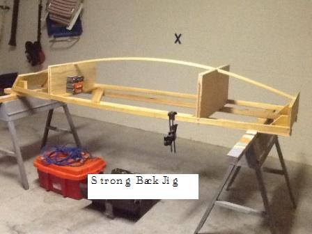

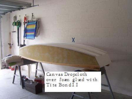

My foamie yak started out as a pirogue/duck punt flat bottom type kayak. I reduced length from 15+' to 8' for easy transport. I haul it on the back of a hitch hauler cargo rack.. Boat weighs about 45 lbs without the extra gear. I built a jig (strongback) and framework to support the foam.
Strongback jig.JPG (21.2 KiB) Viewed 782 times
The kayak is 34.5" at the widest part of the boat. I find it to be very stable while paddling or sailing. I have built two boats using the foam/canvas/titebond 2 system. Been very pleased with the performance of this system.
