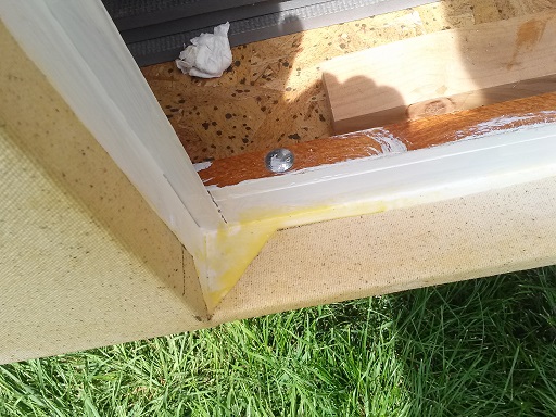

I used Gripper to glue plastic drywall molding on all exposed edges, inside and out. (use quilting straight pins or wood skewers to hold in place until dry.)
The gripper worked great and it has held up extremely well for a couple years now.

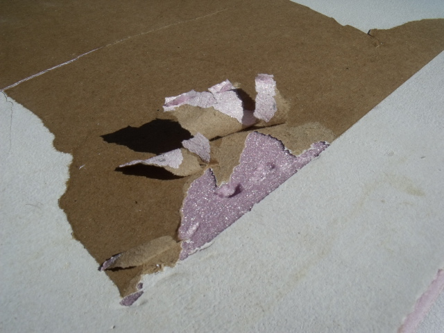

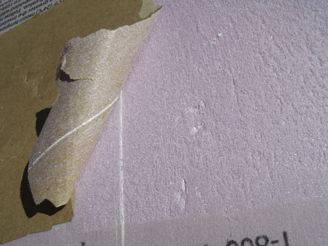

Ok a little test this weekend does show that indeed TBII bonds to Gripper. In fact, I think this combo may be a better bond than just using TBII to foam. It seems the gripper bonds better to the foam than TBII and TBII bonds real well to Gripper.... :thumbsup:
So I had a piece of foam that was coated with Gripper on one side and was bare foam on the other. I took some painters paper and glued it to both sides of the foam.
Once dried I tried to peal the paper off of the foam that just had TBII applied. I was able to easily get my fingernail under the paper and pull it away from the foam.
TBII to foam
Now for the side with Gripper. I had a hard time getting ahold of the paper with my fingernail. Once I did get ahold of it, it was hard to try and get the paper to peel up and would tear. As you can see the TBII and Gripper bond never failed. You can see where I had to gouge into the foam to try and get the paper to lift up.
Gripper with TBII

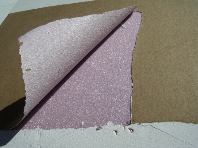

Finally I was able to get a good grip on the paper and was able to carefully pull the paper back. It was harder to pull back than with just the TBII and paper. So this makes be a believer that the Gripper is a viable medium to apply before the application of TBII for a good bond to dissimilar materials.
Gripper and TBII removed from foam
George.

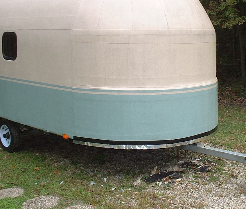

GH, possessed of such great thoughts , maybe you can suggest some type of flashing thingie’ we can use on the rounded nose of our trailer ... Going for a “drip edge” effect. Right now I’ve got Al tape and Gorilla tape doing the temporary service ( Picture) ... :roll: Need to come up with something elegantly simple , like flashing perhaps ... :thinking: Any ideas ???
Re: Working with flashing and beading
Postby ghcoe » Mon Apr 04, 2016 6:42 pm
GPW wrote: GH, possessed of such great thoughts , maybe you can suggest some type of flashing thingie’ we can use on the rounded nose of our trailer ... Going for a “drip edge” effect. Right now I’ve got Al tape and Gorilla tape doing the temporary service ( Picture) ... :roll: Need to come up with something elegantly simple , like flashing perhaps ... :thinking: Any ideas ???
I have not tried this but have thought about running this flashing along the bottom edge of a foamie. I think it would also make a cool design line too. So I would use the wide edge up against the side of the trailer then the sort flange would go up against the bottom of the floor. I would use that flange for a hard attachment such as screws if you wanted to. To make the front curve I would take tin snips and cut slots into the short flange every 1" or so. The rest should bend just fine. I would use caulking to glue the large side up against the wall.
The good thing is this stuff is pretty thrifty and if you don't like it your not out much. So maybe it is time for a test..... :thumbsup:

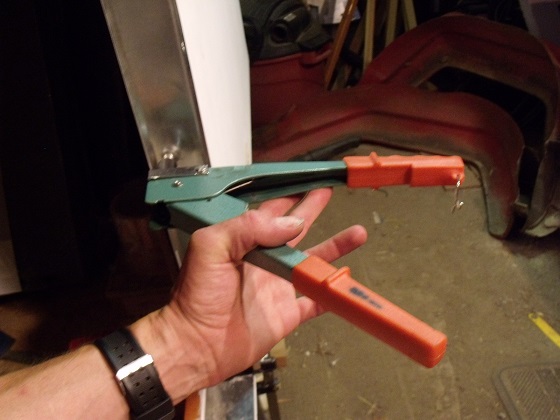

That is a crimping tool not a pop rivet tool shown on that thread. I never used a crimping tool with my construction. I have used a pop rivet gun a lot though. Pop rivets work great with flashing.

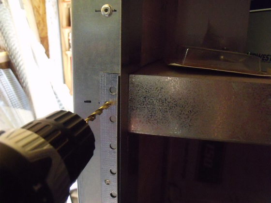

Here I am using a template to drill a 3/16" hole for a rivet. At this location I am attaching a shelf channel to the door frame. The shelf channel runs along the front of the shelf to the opposite side of the trailer where it will be also pop riveted to the other door frame.
template
DSCF3188 small.jpg (89.94 KiB) Viewed 3834 times
Then I inserted a 3/16" rivet into the hole and used the pop rivet gun to set the rivet.
gun
DSCF3177 small.jpg (92.48 KiB) Viewed 3834 times

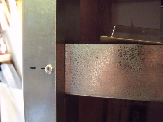

This is the rivet once it is "popped" into place.
rivet
DSCF3190 small.jpg (93.17 KiB) Viewed 3834 times
