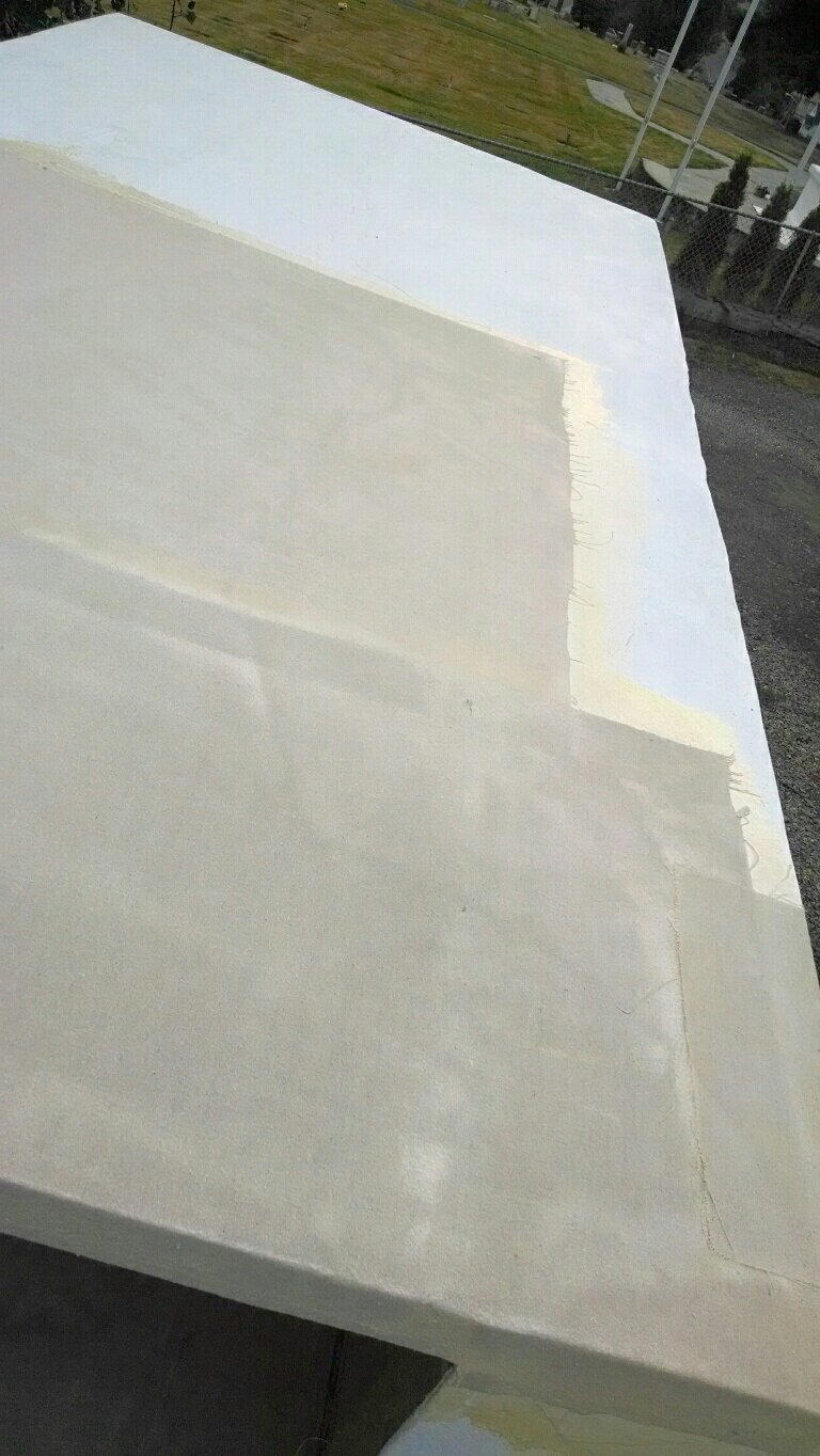

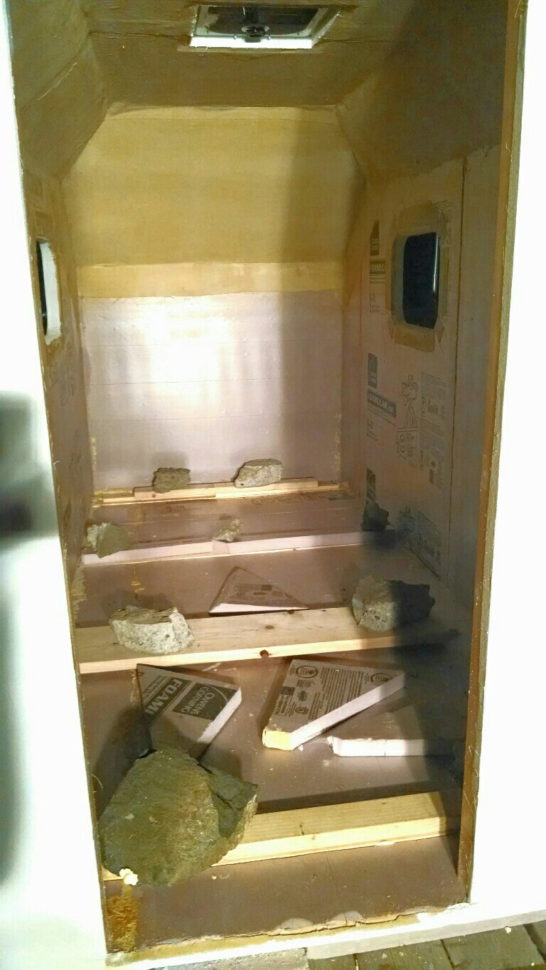

Postby natemiller » Tue Aug 05, 2014 1:41 pm
I'm headed back over for a few hours Wednesday afternoon. More pictures will follow.
I've noticed a few things. First just putting 8 inch canvas steps over the exterior joints made everything so much sturdier! Second after canvassing the roof and most of the walls, we could roll the thing upside down to canvas the bottom. The only reason it took two was it's just too awkward for one person. Each step makes me more confident in this whole foamie thing - only worry now is that it will blow away :o

Re: A newbie and a standie
Postby GPW » Tue Aug 05, 2014 4:42 pm
So good , worth saying twice !!! ;) Na!! it won’t blow away ... or at least none of anybody’s here have ... yet ... :lol:
Funny , I rolled mine to put the black nasty stuff on the bottom ... seemed the easiest thing to do ... :thumbsup:

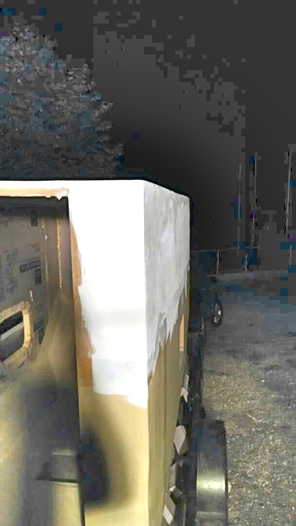

Postby natemiller » Thu Aug 07, 2014 5:38 am
Yeah sorry about that double post.

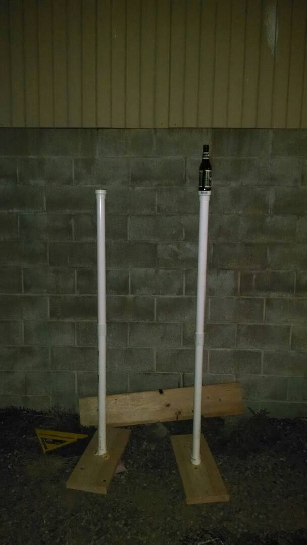

Tonight I primed the bottom and canvassed the ceiling (inside) while it was upside down. She won't be the prettiest foamie in town, but functional skills be achieved.
On a side note, apparently I've become 'the builder' and tonight had a little side project. Made some beersbie poles. Which brings me to a serous question - is beer consumed while making a foamie typically included in the construction cost?
Postby GPW » Thu Aug 07, 2014 6:39 am
In regard to the Beer question .... NO !!! The Beer is only “rented” for the event duration .... :lol: :lol: :lol:
Hey now ... It’s looking GOOD !!! Nice and roomy ... :thumbsup: 8) :applause:
Hint: if you process your pictures in your photo program (Edit /Adjust) , you can drop out a lot of the shadows that make everything so dark ... and , you can post your pics in your very own album here... 8)

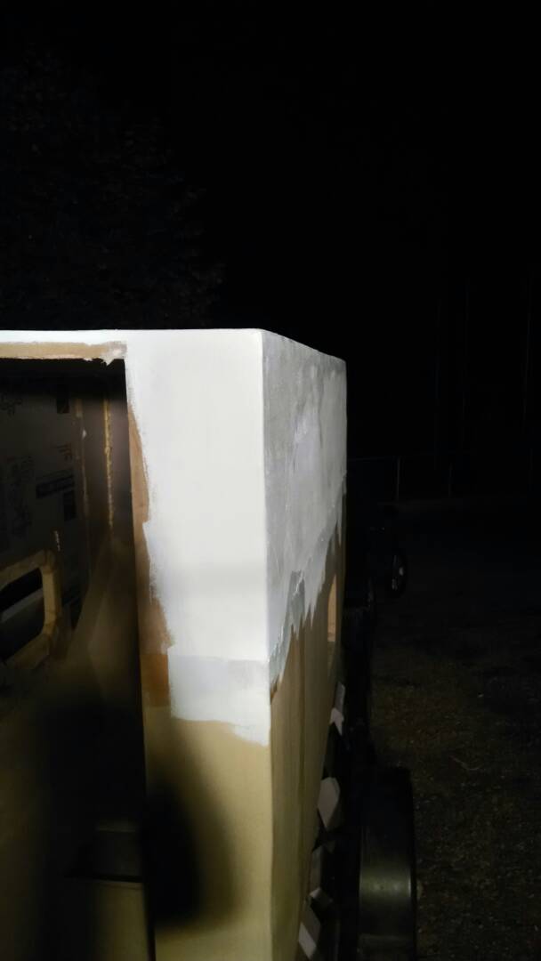

Postby GPW » Thu Aug 07, 2014 1:11 pm
Here’s an example of reducing the shadows and boosting the exposure ...

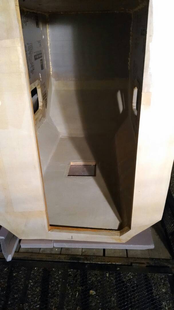

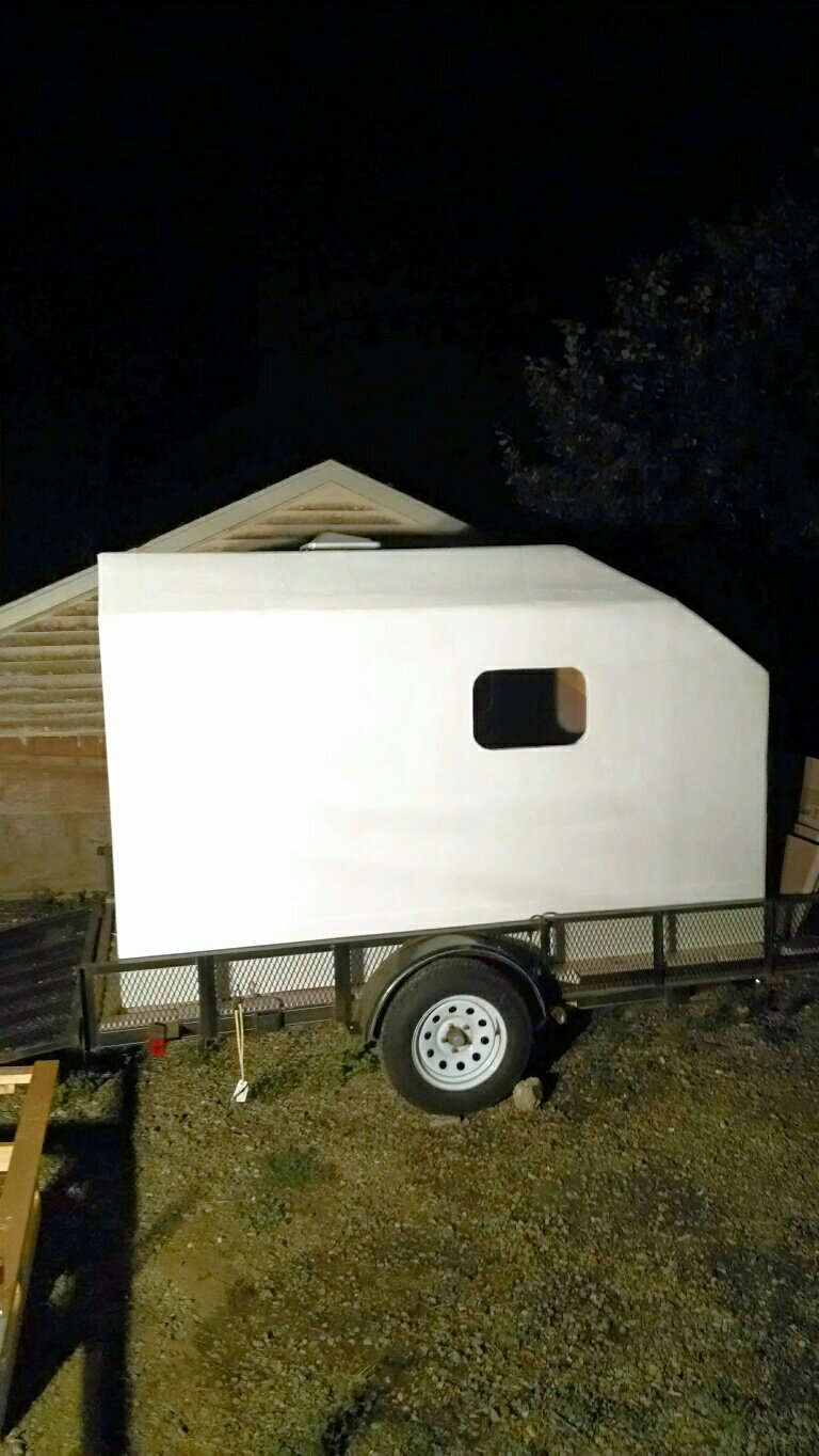

Postby natemiller » Tue Aug 12, 2014 5:37 pm
Little more work last night. Primed the outside just before the rain hit. And embedded some hard points in the floor to mount to my trailer. You can see my high class clamps :P Also started forming some of the interior structures.
On a side note, has anyone tried to use a flexible joint compound to get a smoother finish?
Postby natemiller » Wed Aug 13, 2014 12:20 pm
It's currently not fastened down so I just pick it up and move it when need be. Additionally, it's currently sitting on a friend's trailer that's a foot wider and two feet longer than mine. So I've got all kinds of working room ;)
I don't think I could work around the rails but since it weighs on under 100lbs at the moment (by quite a lot I suspect) it's not hard to pick up and flip over when needed.
Postby natemiller » Wed Aug 13, 2014 10:09 pm
Well minor setback. Apparently I hadn't sealed the canvas under the floor at the door. Rain got in and ruined about a third of the TBII bond. Frustrating but I just cut out the loose canvas and patched it. Did I do the right thing?

Postby GPW » Thu Aug 14, 2014 4:11 am
You canvassed underneath ??? :o That’s OK !!! :thumbsup:
