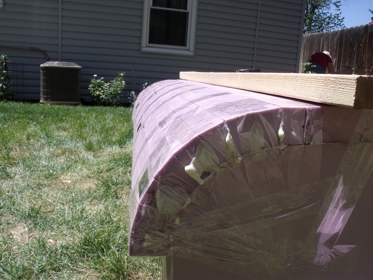

What was said before, The glue is harder to sand than the foam so you will get a ridge at the glue line. On my build I cut back the glue line into the foam some and then sanded the foam. Once I got the foam faired to where I wanted it I then painted the foam with Gripper. I still had a void at the glue line so I filled it with light weight spackle and then sanded it down to the surface of the foam/Paint. By painting the foam it makes it hard to sand into the foam so you can get a nice fairing at the cut line. Prior to figuring out this it was a real pita to get that glue line perfect. I was fighting that ridge and then I could not tell how far I was sanding into the foam. This process worked out pretty good.
I do not have a picture of how it looks now, still working on that.
Here is a shot of the foam lay up for the rear hatch radius using hot wire cut sections glued together.
glue up
DSCF1993 small.jpg (184.81 KiB) Viewed 1147 times

George, that’s one SOLID looking hatch !!!! :thumbsup: 8) :applause:
