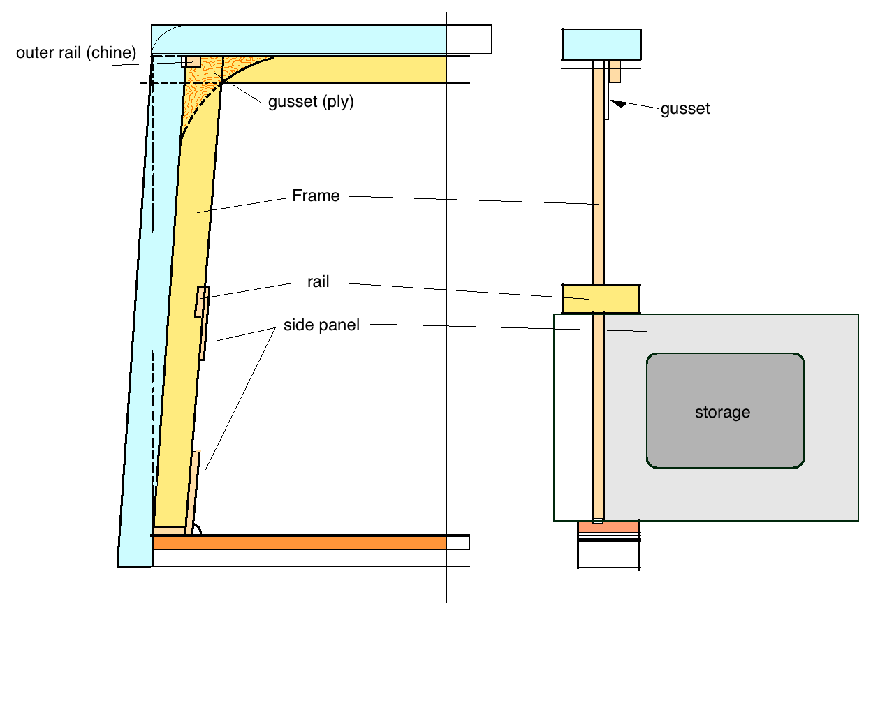

Well then , Spring is on the way .... sooner or later . Planning for some Nice weather building ...this time ... :roll: Comparing the Zephyr and Eagle , the Eagle does give more room at the cost of some aerodynamics. :thinking:
So here’s a drawing of Eagle framing possibility (not to scale ) ... on the left is a half view looking from the ends, on the right a typical frame cross section viewed from inside . The cross pieces being the inner rails and interior details . Just exploring possibilities ? :NC
The sides could be perfectly straight if wanted, no rules eh ...(well, only a few) ... :thinking:

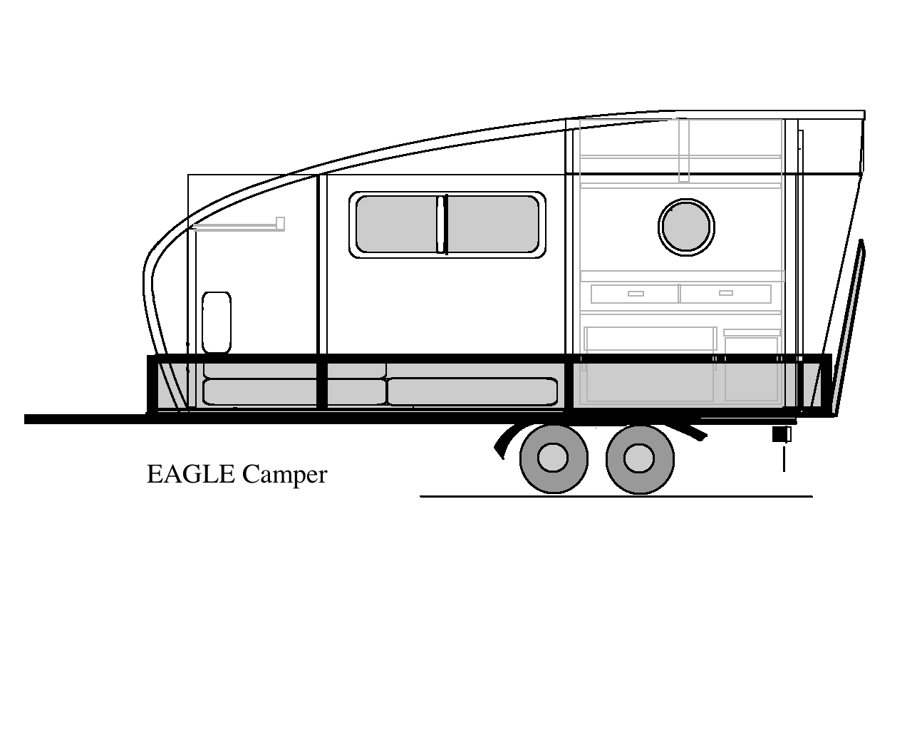

And an Eagle on one of those flat cargo tandem trailers ... Slide on , slide off (the tailgate/ramp) ... off onto a couple dollies and roll it into the garage for the winter. (making a garageable Standy’ cabin ) Foamie cabins themselves are so light just a couple people could make the transition easy. The heaviest part of any Foamie trailer is the steel trailer and tires eh !!! ... Just the cabin in the Garage for the winter could serve as a nice little office or just a place to kick back and watch the game .. :beer: “man cave” ;)
Just another idea for mixed use trailers .. One trailer , different jobs it can do . “multitasking” :thinking:
