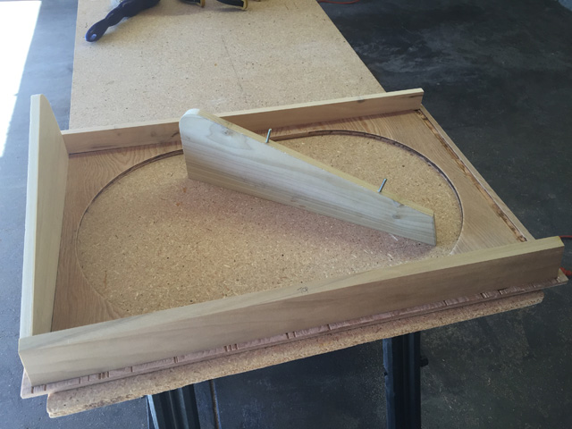

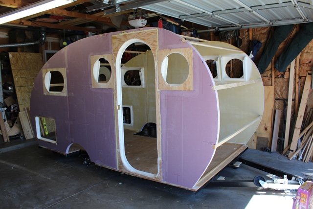

I found a picture of the windows during construction. I thought I had lost them. I routed grooves for the pieces to fit in. Mostly so that the grooves would hold the pieces together during glue-up.

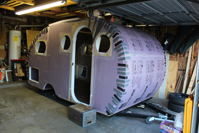

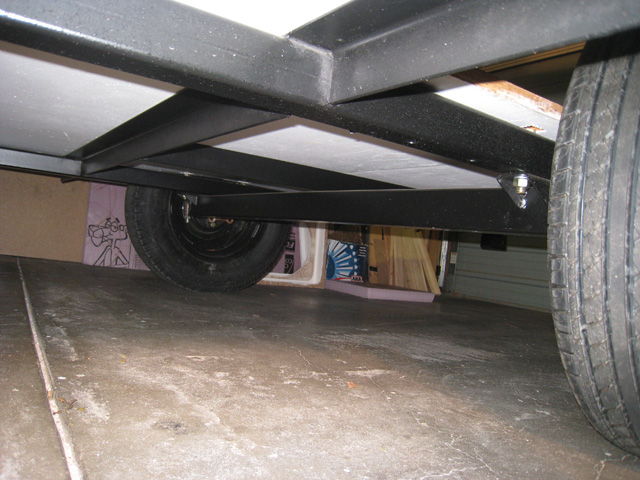

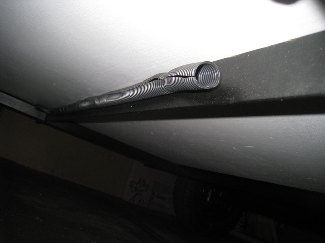

Here is a picture of the underside of the trailer and of the cable track for the trailer wiring.

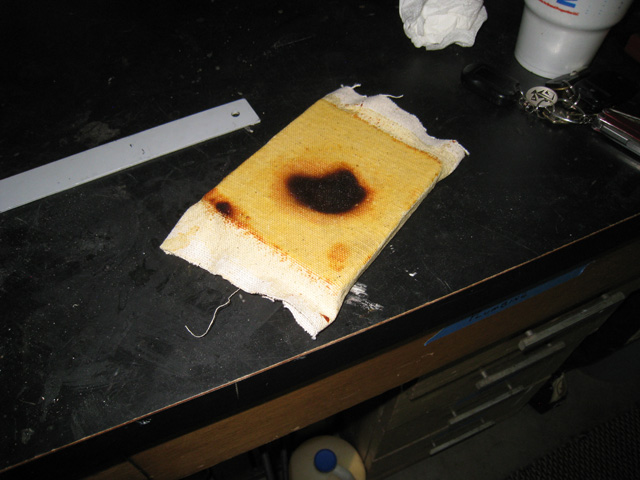

Finally, here is a fire test I did on canvased foam before I started construction. I was worried that an ember from the camp fire could wreak havoc on a foam and canvas trailer. I burned a piece of wood as large as upper part of my thumb until it formed a nice hot ember. Then I dropped it on the test piece and let it burn out. My goal was to simulate a very large ember from a camp fire landing on the roof of a foamie. It melted a depression in the foam and charred the surface but it didn't burst into flames. It's not a conclusive fire test by any means but it did make me feel a little better about the flammability of the trailer. I'll refrain from using my flame thrower while I'm in it.

NMM, no flame throwers Please !!!! Foam nor canvas burns well at all.... I’d be more scared of plywood “paneling“ that burns with much ferocity. :frightened: Testing proves all theories (or not) and comforts the mind. :thinking: Nice burn test !!! :thumbsup: 8)

GPW - I also tried open flame from a lighter. The foam melts immediately as expected but once covered with canvas and glue it is more flame retardant. Again my goal was just to make sure it didn't turn into a giant candle.

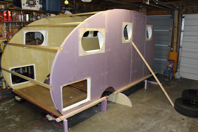

More progress.... I set myself a goal of getting the trailer 95% built in 9 months. (I'm not sure they ever get to 100% built) So by the end of May I need to be mostly done. I did this because I have some time between contracts so I can put in lots of time building now. Plus I want to go camping!
Walls up and my 'clamp' system for holding the walls tight against the guide rails that are mounted to the floor. I used studs and ropes to winch the walls up against the guide rails. It worked wonderfully.
Door frame mounted. For reasons I still don't understand, the hole that I carefully measured for the door didn't line up with where it actually needed to be. If you look closely, you can see where I had to use spray foam to fill in the gap. Overall things turned out fine but I measured multiple times, cut once and still got it wrong. That challenge is what I like most about making things. There is always a new problem to solve and, just when you think you are doing well, it finds ways to keep you humble.
I started gluing on the roof. Here is an important lesson that I learned that I hope helps someone else. DON'T cut the roof to width before you mount it. Cut it with 2 or 3 inches of extra width. Then after it is glued in place you can cut it to width. I wish I had thought of that before I started. Things still worked out but it would have made things so much easier if I didn't have to worry about alignment as I glued the roof on.

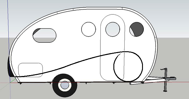

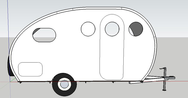

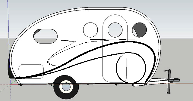

I'm thinking more about the paint scheme. I ran across this picture of a beautiful art-deco car and I love the lines and even the colors. I just can't figure out how to incorporate the elements into a paint scheme for the trailer. I sort of did it subconsciously with my first attempt but my first attempt has lots of straight lines in comparison to the car. Anyone have suggestions?
Car:
Trailer Profile:

Postby GPW » Tue Mar 24, 2015 12:16 pm
Like this ...?
Re: New Build: A canned ham in foam
Postby GPW » Tue Mar 24, 2015 12:24 pm
... and further... :o
