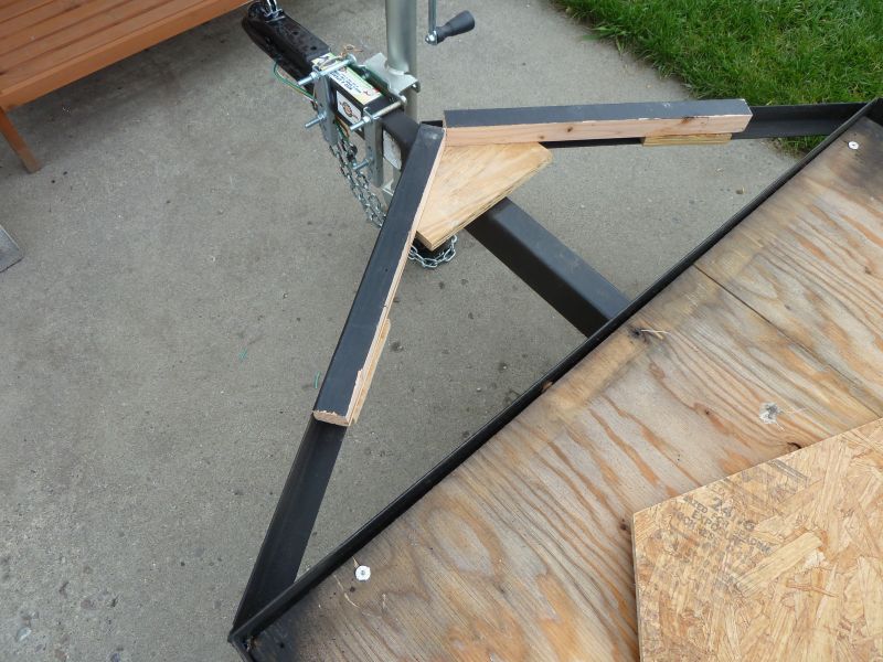

Support for front of teardrop, the floor cut to size & mix applied to top (need to do bottom, will be exposed), 1 inch styrofoam insulation under the floor
maybe this will be screwed into floor - not sure yet
Nose support sub.jpg (121.45 KiB) Viewed 1576 times

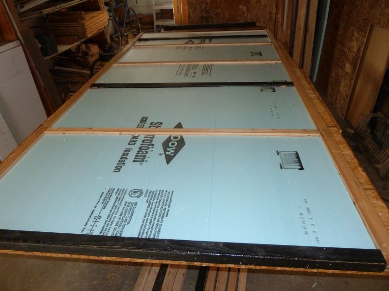

1" styrofoam - wiring runs in remaining space
underside of floor insulation.jpg (93.68 KiB) Viewed 1576 times

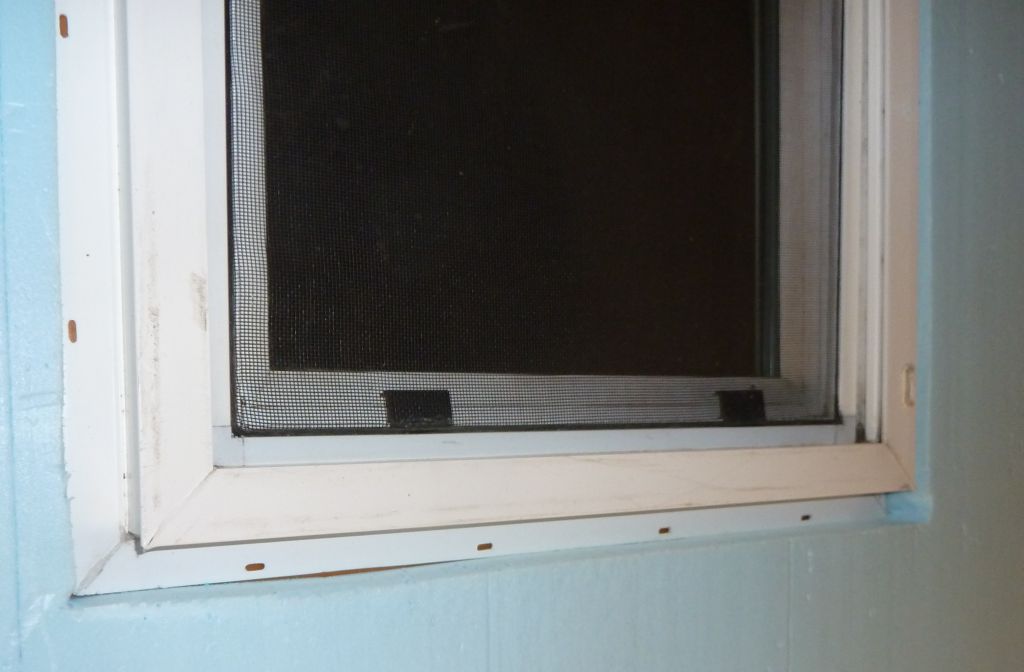

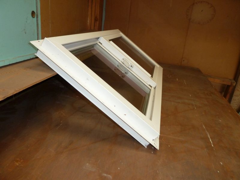

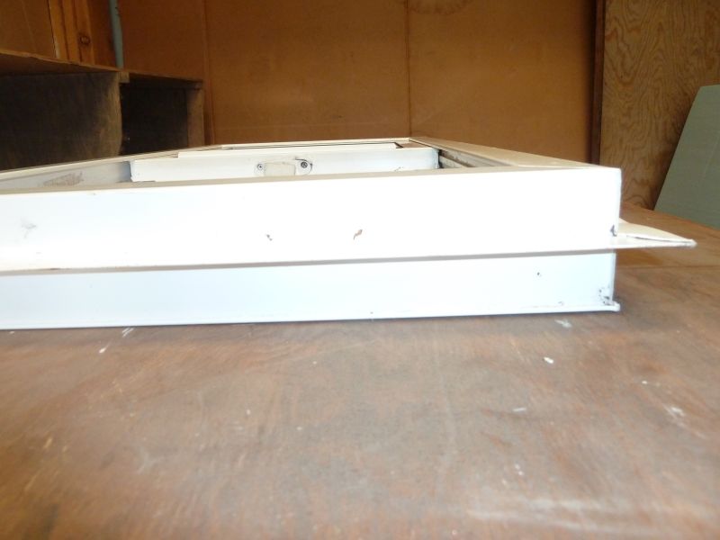

Found this 36x18 screened slider window for the 'drivers side' for $30 but it's kind of weird with the nailing strip in the center. Window is thermal-pane with the pressure bleeders still intact - I think I will leave them that way even with the chance of fogging rather than pressure changes going up and down mountains exploding the window. Can tuck them under the window top trim. Window weighs 18 pounds.
The only way I can see the installation with a more or less smooth exterior is to
- cut out the overall window dimension,
- glue in the support structure 1" deep on inside of panel
- screw in window to support structure
- glue in 1" foam to fill the outside cutout so the 1" is covered
- fair it all in smooth & cover with canvas
Suggestions always appreciated. Pix below
Window side view.jpg (76.59 KiB) Viewed 1542 times
Nailer strip is in center
Window edge.jpg (68.58 KiB) Viewed 1542 times

Postby wagondude » Wed May 20, 2015 9:02 am
I'm not sure how that will mount up smoothly, but I'm sure you'll figure it out. The only thing I would suggest is to put either some tint film or security film on the inside of the glass to prevent a bed full of large sharp shards and slivers should the glass break.

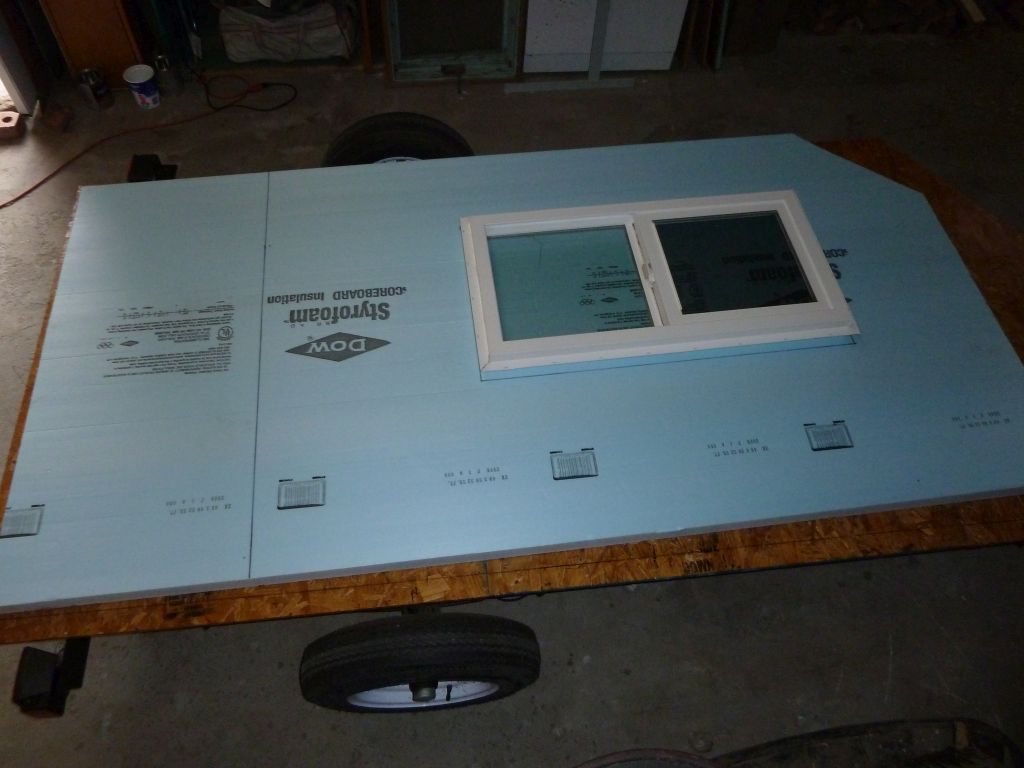

Cut the front angle in the foam and have been working on the layout. Black vertical line is 1/2 inch OSB galley bulkhead position. Pix of what the current idea is:
door position (29w x 36h
passenger side w door.jpg (101.5 KiB) Viewed 1479 times
driver side with window positioned.jpg (100.55 KiB) Viewed 1479 times

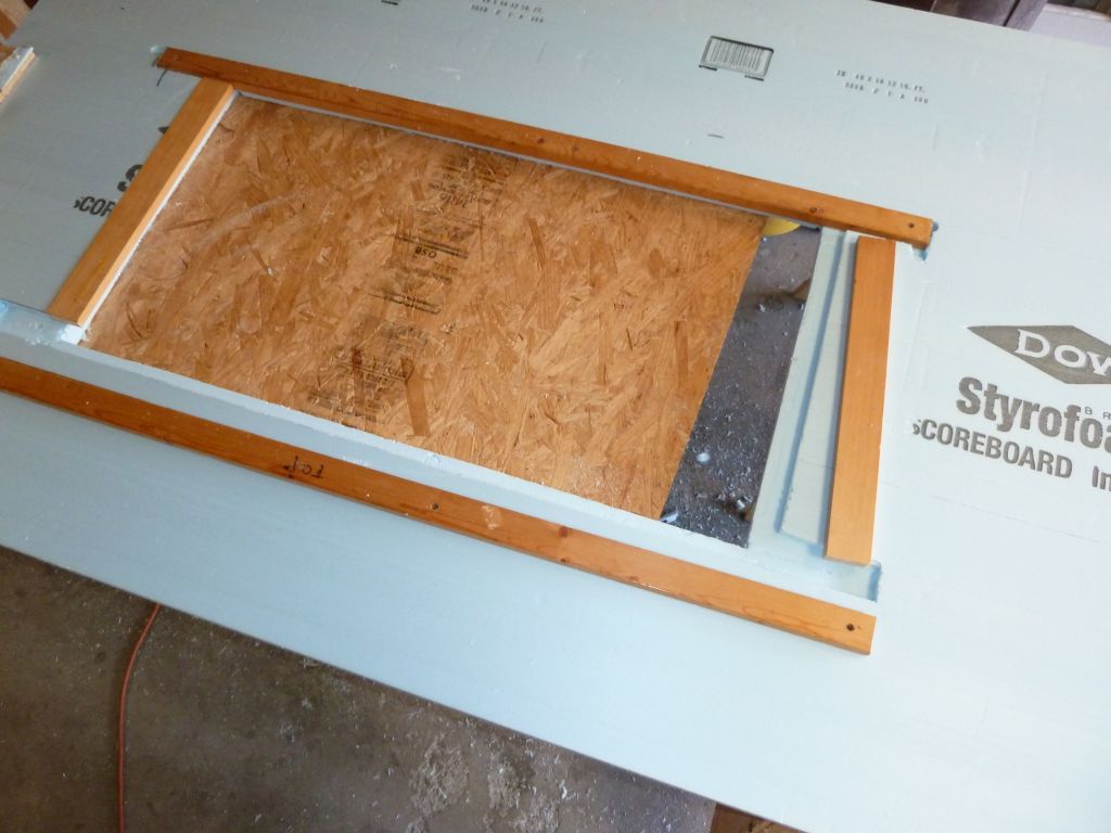

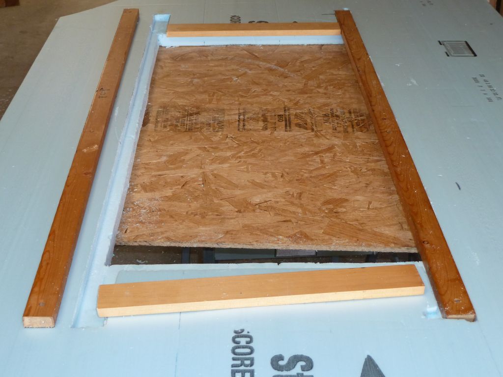

Cut out the door (crooked as usual :shock: ) and the window opening which came out surprisingly decent. Routed out the slots for the wood 'nailing strips' to be embedded in the wall. Made a moderate mess as expected - she who must be obeyed rerouted my entry directly to the washer for decontamination :R

Just a quick note .... That wood really should be treated to the Mix before gluing in the wall ... And , of all the wood we choose to use for framing , there is wood available that is more water/Rot resistant , rather than Home Depot pine or fir ... Just sayin’ ... One of the big reasons for using foam in the first place is , it doesn’t ROT ... No use adding something that does ... :roll:
Re: Bread-loaf build thread
Postby Fred Trout » Tue May 26, 2015 12:26 pm
Already done, GPW, has mix coats AND a final pure urethane coat on top. Will be Gorilla glued in, Great Stuff faired in place to cover all my router mistakes, inside covered with canvas on the flat before the walls are assembled. Once wall, roof, OSB bulkhead assembly, window installation, and outside GS fairing is complete, the outer canvas gets laid over the whole thing. All required because the window nailing strip is 1" from both sides (weird window build).
If anything would be water resistant, this foam embedded package should be. Considering the teardrop will be garaged when not camping, it should do ok, with condensation from going out camping only an rare issue. SW Montana is high desert, usually less than 20" precip a year and most of that is snow. It's COLD here GPW, so rot is minimal; I have pulled up 30 year old untreated cheap pine 1x4" used as garden border that was pretty much intact.

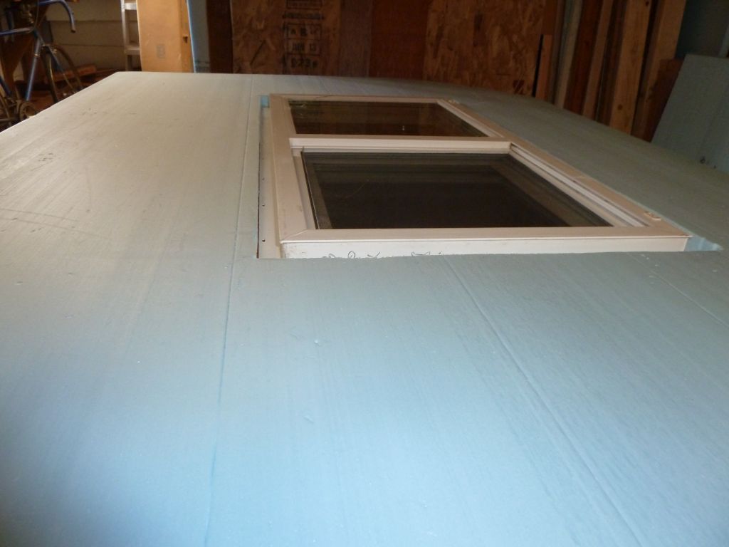

Anyway, got the test fit done for the window inset and it fits well, so repaired all the larger divots and router oopsies with Great Stuff now I gotta wait for that to dry/cure before routing the bulkhead dado, fair the street-side wall and apply the canvas.
Window won't get screwed in place until walls are up and canvas ready to be applied on exterior.
this is the outside of the wall - will trim some foam to fill the opening & cover up to window w/canvas
window cutout completed - side view.jpg (88.36 KiB) Viewed 1371 times
window cutout completed - aft outside.jpg (55.17 KiB) Viewed 1371 times
Looks pretty good with minimal window "sticking out"
window cutout completed - view forward.jpg (87.12 KiB) Viewed 1371 times
