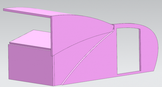

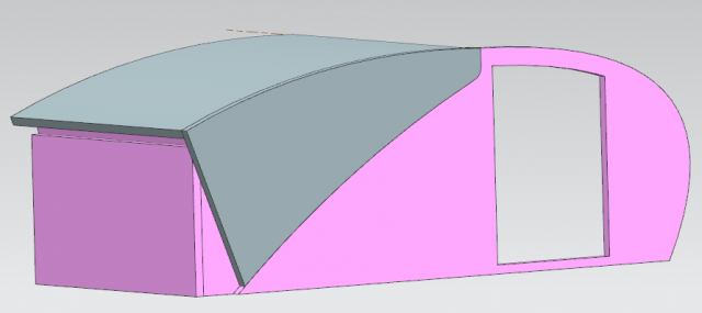

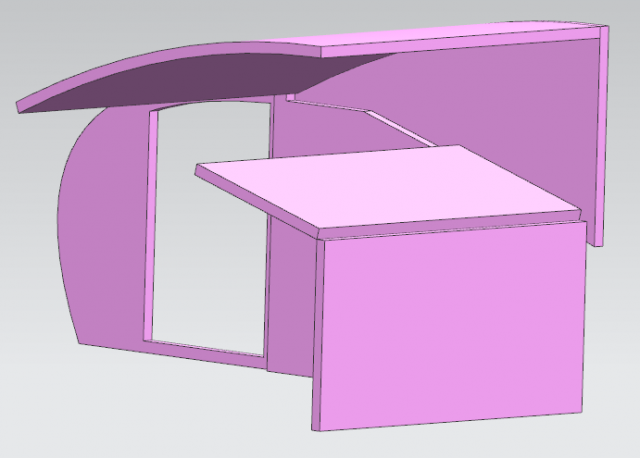

okay, here's my screenshots for the evening... This would be the slouchie

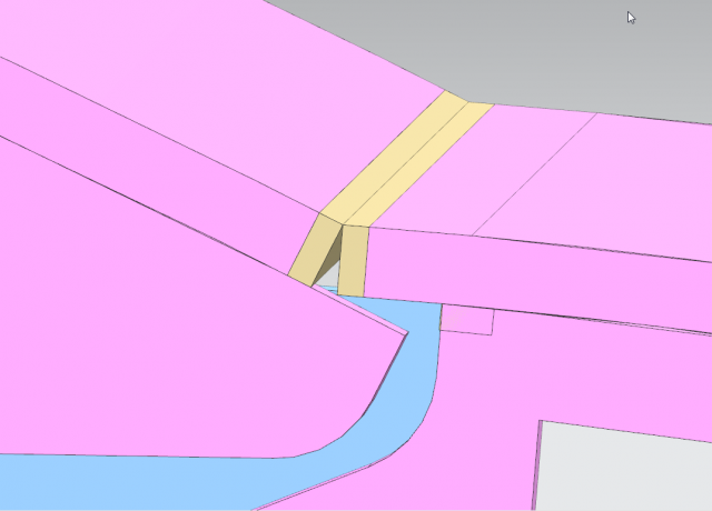

oh, one last pic... this one is kinda important. It's the hatch sealing mechanism!

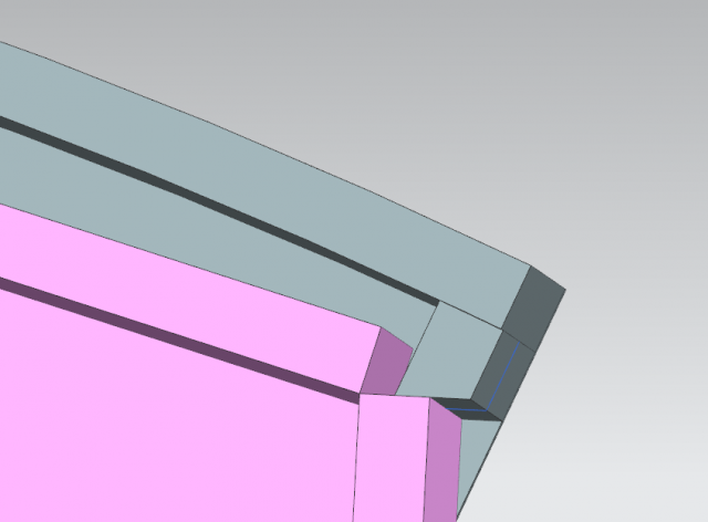

Oh darn, I hit a snag. When I open the hatch I end up with a hole in the side, for the mosquitoes. :? :cry:
Any ideas?

Re: Foamie hybrid thoughts...
Postby Fred Trout » Tue Jun 30, 2015 5:56 pm
Could do a "rule joint" like this at each of the end of the hatch:
Postby KCStudly » Tue Jun 30, 2015 6:24 pm
How do you deal with that using standard construction?
If you can keep water out it should keep the bugs out, too, right?
Can the part of the side wall that juts forward extend up to the top of the roof? If not, how about a thin piece of ply overlapping this area (it could be an organic shape or coordinated with other external embellishments, such as paint scheme or wings)? Not sure how that would keep rain out, tho.

Postby mikeschn » Tue Jun 30, 2015 7:29 pm
In standard construction, the sides go over the spars, and is covered with 1/8" plywood. There is a hole, but it is covered by the 3" of plywood forward of the hinge.
In foam construction the top has to be glued on top of the sides, in order to give it shape. Hence the problem.
Now lets suppose, that instead of gluing the foam to the top of the sides, I reverse it.
So I put a bunch of holes in the sides for the spars, 2" below the top. Then I glue the top to the spars. The shape is retained, and the sides cover the hole, as in standard construction.
I'll model that up tomorrow evening and show you guys.
Postby wagondude » Tue Jun 30, 2015 7:35 pm
Dowell the roof to the sides. No spars needed (unless you want them for some other reason). I would think in that area, the spars would be mostly just extra weight to lift with little extra benefit.
Postby KCStudly » Tue Jun 30, 2015 8:45 pm
No, that's not what I did. I rolled the bottom edges of the hatch side spar and added a concave block in the hopes that my hatch seal can run continuously up onto the forward face of the spar. When my hatch is open rain will be able to get in. :lol:
Why cant the front hinge spar be shorter bearing on the inner wall, and the roof be notched where the transition is between outer and inner wall to match. Then the wing wall of the lifting roof could fill the area in the notch. Again, I don't know how you would seal this sliding face so that it stays dry when open. Just throwing out ideas hoping to spark something.
