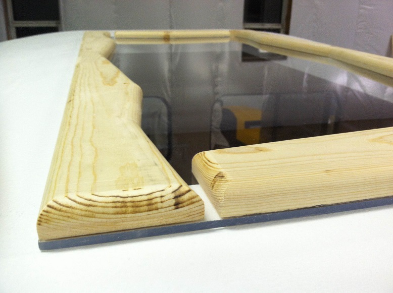

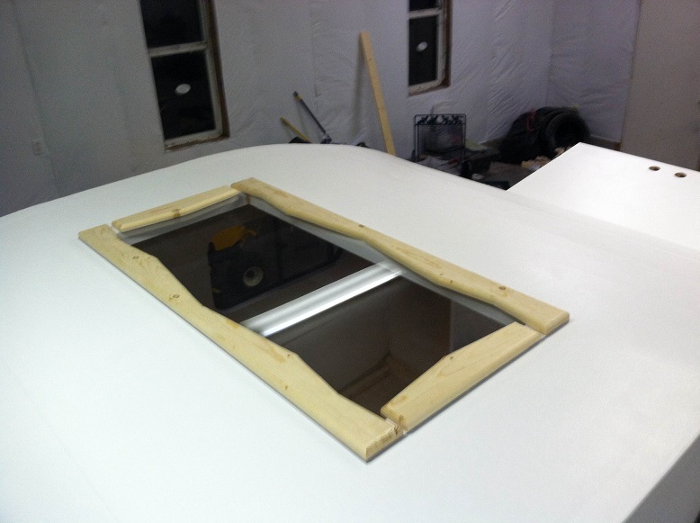

Did some work on the skylight/hatch.
My first plan was to bolt the 1/4" plexiglass down and seal it with marine adhesive. I did a little math (boooooo) and realized a 4 ft span of plexi will shrink/contract almost a quarter of an inch during a 100 degree temperature change. I thought this would be too much for any silicone or sealant to handle so I decided to use a rubber gasket and realized I may as well make the whole thing removable. MUCH better for ventilation AND if it does leak I have to break any permanent/semi permanent seals to check it out
So I fashioned a frame of sorts to rest on top of the plexi.
There are gaps in the wood to keep water from pooling on top. The zig-zag pattern is partly aesthetic, partly to minimize the amount of frame that obstucts light coming through the glass. There will be carriage bolts dropping from the zig zags through the glass into the cabin

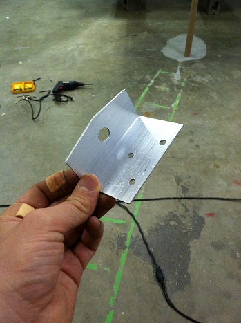

I made some brackets for the inside. (WOW THIS TOOK FOREVER. WHY CAN'T I AFFORD TO JUST BUY THIS STUFF.)
