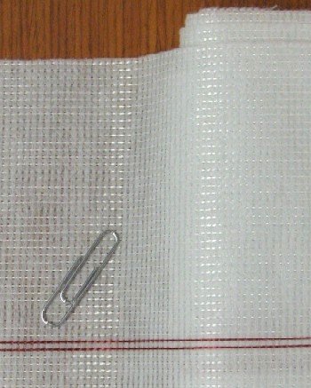

Socal Tom wrote:I just finished up a job of skinning the roof of my TD with a polyester cloth intended for use with roof coatings. What I did was follow the recommendations for canvas/cotton. Paint a 50/50 solution of TB2 onto the luan, then soak the cloth in TB2. I wouldn't do it this way again. The poly cloth didn't hold the glue, so much of it ran off. I think a better plan would have been to roll out some straight TB2, apply the cloth to it. This cloth is fairly thin and looks very nice under 2 coats of paint. I did some trimming after the glue dried, and those sections pulled off cleanly. I think full strength glue would have adhered better. It shouldn't be an issue in my case, but for foam that could be a bigger deal. I'm counting on the paint to provide the final adhesive to hold it down, and so far it looks like a successful outcome will arrive. I plan to sand it after the 2nd coat dries adequately , then apply one more coat that should be pretty darn smooth. With two coats the cloth texture is lightly visible, and it looks like a very water tight surface.
Can you post a picture of the cloth here on the forum without any paint. I have seen a a poly cloth at a box store that is similar to a gauze like material except it is much stronger. The poly I saw is laid down after the first coat of roll on roofing is applied and then a second coat of roll on goes on. The poly cloth is used as a bond for the roll on. I will try and locate a picture.

Here is a pic of the poly cloth I have come across. I am not suggesting using this item in place of canvas or any other covering that has been used before. I am always open to learning something new. If this has been covered before please excuse a repetitive posting. I have read the "The Big Thread" and all of the Foamie builds and it has been quite an education but I cant remember it all. Thanks to all of you for sharing your knowledge. I am looking forward to my own build and especially looking forward to your opinions, comments, suggestions and pointing me in the right direction.

greygoos wrote:Here is a pic of the poly cloth I have come across. I am not suggesting using this item in place of canvas or any other covering that has been used before. I am always open to learning something new. If this has been covered before please excuse a repetitive posting. I have read the "The Big Thread" and all of the Foamie builds and it has been quite an education but I cant remember it all. Thanks to all of you for sharing your knowledge. I am looking forward to my own build and especially looking forward to your opinions, comments, suggestions and pointing me in the right direction.
That looks like the cloth I used. I don't know that I would use it on a foamy, but for covering my roof it looks good, and seems water proof.
FWIW, today, I skinned the galley hatch ( remember, I working on a wooden TD). I didn't use any glue, I laid down a thickish layer of paint, put down the poly cloth, and rolled another coat of the paint over the top. About an hour later, I trimmed the cloth, and it was stuck as least as well as the diluted TB2 ( on poly) and the paint wasn't even fully dry yet. I think if you are skinning a wooden TD, you can skip the glue, and just use paint.
