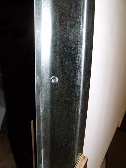

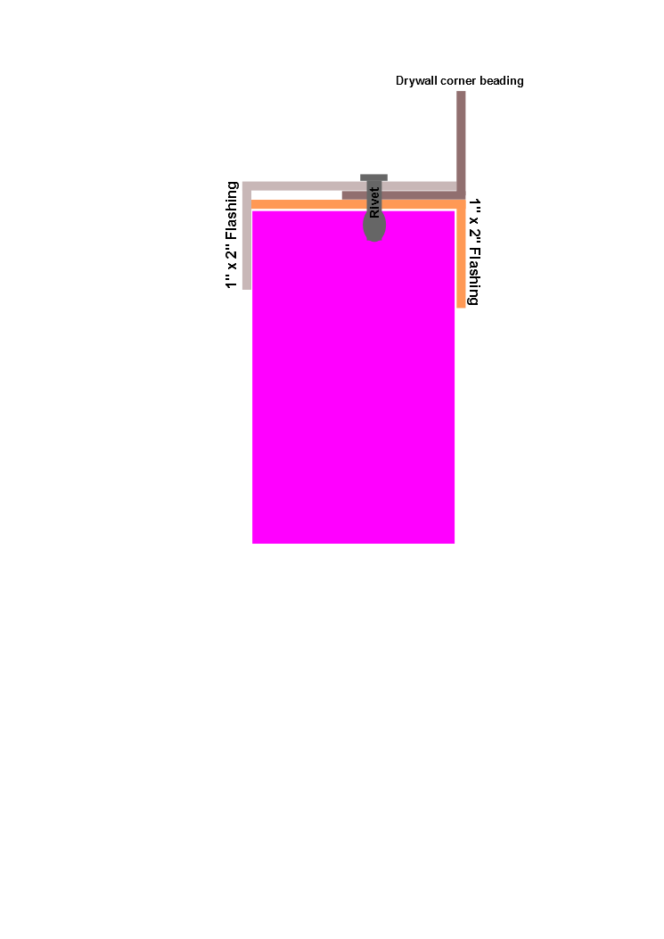

Postby ghcoe » Sat Mar 19, 2016 9:16 am
This is how I made my door frame. It would be easy to make window frames the same way. You could even use 1"x1" flashing to move the flange closer to the middle of the foam to allow for latching devices that would not protrude into the living area.
Door frame
DSCF3178 small.jpg (112.9 KiB) Viewed 1277 times
Door frame detail
George.

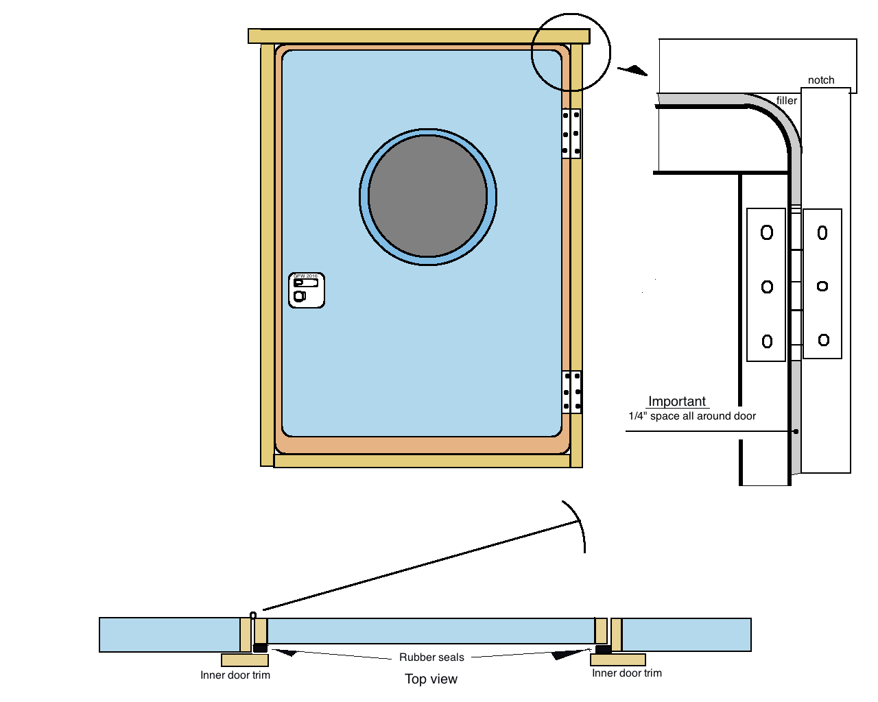

Postby GPW » Sat Mar 19, 2016 11:26 am
Another door/hatch idea...
Doorhatch .png (53.72 KiB) Viewed 1251 times

Postby dancam » Thu Aug 11, 2016 10:50 pm
GPW wrote:Another door/hatch idea...
This is essentially the type of door I want to build. So why the rounded top corners? And what type of door latches do you guys use?

Postby GPW » Fri Aug 12, 2016 5:42 am
Dan , rounded corners look good (optional) .... we used a stainless door knob for the Door ... many latch possibilities ... ( shop around ) Most everything we use is adapted from some other usage ... :o

Postby KCStudly » Tue Aug 23, 2016 1:36 pm
Rounded door corners allow you to have a rounded gasket flange, which in turn allows you to use a single piece of edge trim style (or even surface adhered) weather seal that can flow around a suitably large radius with no mitered joints. Just one butt joint to deal with at the lowest point.
