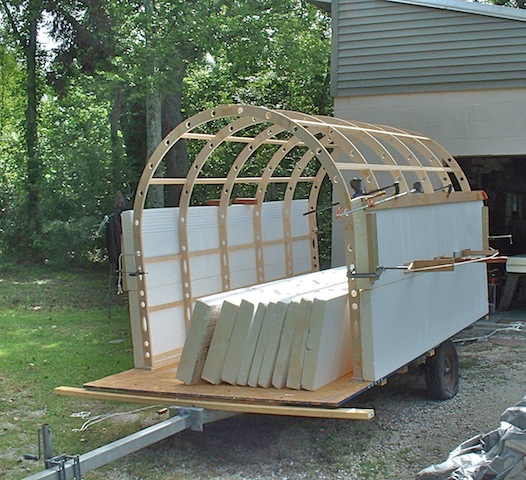

Don't be afraid of EPS. I built my trailer using 2" EPS including the floor. The EPS I used was all scrap material that I got for free. I glued the smaller pieces into full sized sheets, covered both sides with 10 oz burlap glued on with $5.00 a gallon "oops" paint,
The only place I used any plywood was on the floor, rear wall and inside of the lifting roof. The floor is 2" foam sandwiched between 3/8th" plywood with no internal framing. The inside roof panel is 1/4" birch plywood which is just more for looks than strength.

We found big blocks of EPS 24” X 20” X 10’ (20bucks each) that we sliced up (hot wire) for the FoamStream .. we ended up with 24” X 3.5” X 10’ slabs that we used as the wall ,roof , etc. ... :thumbsup:
The ONE really Important thing we learned is ..... IF the foam is weaker , then make it thicker ... :thumbsup: My 3.5” thick walls are not only well insulated , they’re very Strong , especially with that 18 oz. canvas over it ... :D
