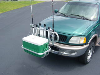

I surf fish with a cooler on a front truck mounted rod rack such as this:
(This is an example photo, not my rig)
We use this cooler for bait and go through a lot of ice in trying to keep bait fresh. These ideas passed around in this thread give me ideas of building foam box (maybe 2 in thick) around the cooler and coated it with cloth as on the TD's.
Thanks
Bob

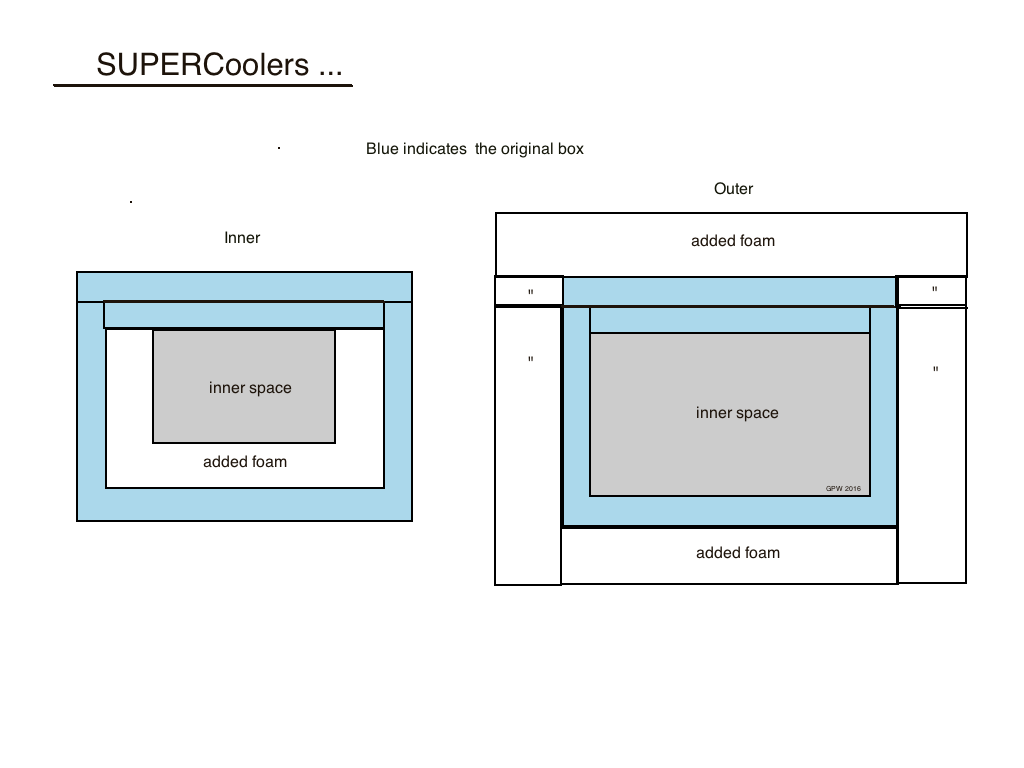

We just measured inside our outer box ... The inside dimensions are 17” X 17” X 12.5” deep ... We happen to have some 3.5” thick foam sheet (left over from the FoamStream build ) and if we add that to each inside wall , and the bottom , we would end up with a space of 10” X10” X 9” , and a wall and floor thickness of 5.5” , and R value of ~ 25 ... and enough room for a 6 pack ... and a small slab of ice ... :roll: While not really practical for the huge outer size of the cooler 21” X 21” X 18” , it is an EXTREME example of what is possible ... and if you really had to keep something frozen for a while ... :thinking:
We could add the 3.5” thick foam to the outside of the box and end up with the same R’s but a much more practical space , and room for a big Block of ice :thumbsup: ... That may be even better!!! ... The new size would be a bulky 28” X28” X 25” tall ... Big cooler for Big storage ... :o
Re: DIY Foamie' Super Cooler ...
Postby GPW » Sun Jul 03, 2016 9:22 am
Another drawing ... :roll: Note: both blue boxes are the exact same size ...
