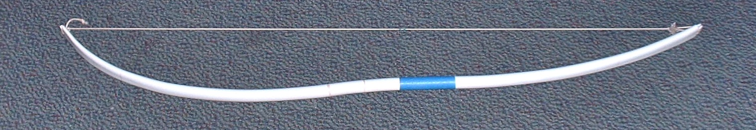

Bob ... “ Now if a guy wanted to make a hooped vardo/ conestoga trailer, this would be very useful material” ... Since you mentioned it , I now believe that PVC would make good hoops for a Connie’ ... We regularly heat bend PVC pipe to make Bows (archery) , and we’ve yet to have a bow failure ... Nice thing is you’re able to flatten out the ends for easier attachment to a base box ... :thinking:
... and it’s ridiculously cheap .... 8)
