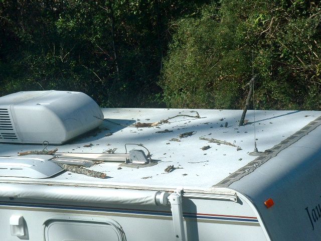

“ I'm mostly concerned about penetration and dent resistance, “ Yes , indeed , but what about all the testing in the past where everybody proved the dent and puncture resistance ... Years now , no reports of punctures or dents that don’t heal ... and don’t think plywood is puncture proof ... ( see limb through the plywood trailer roof picture ) :o
The original idea of a Foamie trailer wasn’t to make somnething to last as long as the pyramids , but just an inexpensive "hard tent" that didn’t rot or delaminate the first season ... Something light and easy to build for most anybody ( even Grandma’s have built these ;) )
No rules , build what you like, and can afford ... but just remember , even the simplest of foamies have worked very successfully for years now .... 8)
Stress test , dent resistance ... ??? I’m 6’3” 240 lb, and using a standard sledge hammer and all my might , we gave it our all .... still didn’t go through .... How strong is that ... 79717
Pic below shows how a limb made 10 holes ( ten) in a membrane/plywood/beaded foam , and paper commercial trailer roof ... punctured the ceiling inside in several places . on limb piece on the floor ... Glad we weren’t inside ... :roll:

I don't disagree with most of what you say but you can't compare an impact on a solid surface to one in free air. I suspect that same sledge hammer on a foam roof would be as damaging as the limbs on a roof.

By the way , just wanted to say the RV dealer charged $5,000.00 for that roof repair ^ ... and a little spot on the side ... fiberglass (?) .... He just threw on a regular sheet of plywood over the holes , and covered it over with a new “membrane" ( thck as a cheap vinyl table cloth) ... the fiberglass repair was really amateurish , What a RIPOFF!!! And I had wondered why he insisted we buy the trailer insurance from his company ... RV scam ... :roll:
