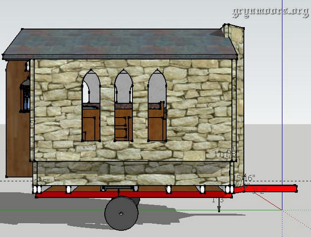

Thanks for the words of encouragement! Unfortunately, I couldn't get the old man to see to my way of thinking and making it a "standie" and he's insisting that it fold. Which means set-up and I'm trying to get away from that, but he has his reasons which has to do with towing (that I don't agree with). This will have a pull out kitchen box on the hitch end (more set-up---sigh). So, I designed it to fold.
I made a foam core board model 6:1 scale so my Ken doll could use it :lol: . I worked out some bugs in the design and have my final SketchUp file ready. Here's the model. I hope it's OK to post links to my blog since that's where I uploaded the images.
http://grynmoors.org/blog/post/tiny-tudor-tourney-trailer-model-build-part-2
When the weather improves here (usually by June) we'll start building. First, we're going to make a chicken tractor out of the stuff to get the hang of working with the materials.
In the meantime, I'm having fun playing with SketchUp and making all kinds of "medieval structures" (foamie standies) on wheels and dreaming about having one of those.
